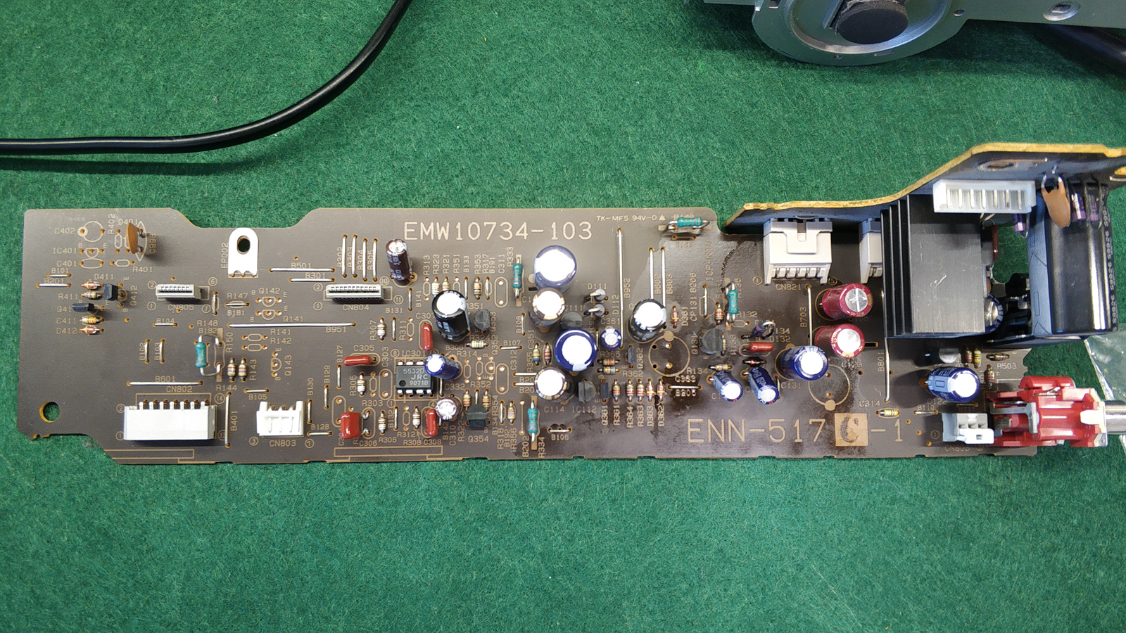

    Hello guys, I purchased this week this CD changer to add to my old Pioneer Hifi, well, just lasted 1 CD playing, tried to open the tray to change it and add a full set of three, but got stuck, no opening tray and no response from any button, power but was not responsive and finally unplugged it. Plugged again and no standby led and nothing works.

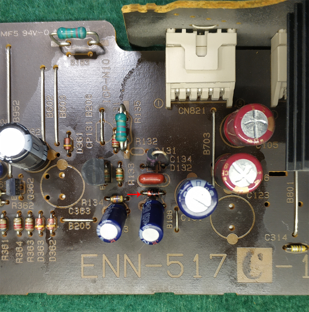

    Opened the case and there is almost one zenner diode that gets quite hot, enough to evaporate quickly the alcohol.
    If I remove from the power supply the CD system, the display blinks, also the temperature of the zenner decreases.
    But no sure from where to start, if it's a main cd changer circuit problem or a power supply issue.
    Here is the service manual, and one image of the power supply and audio board.
    If some one could give a hand would appreciate

    The voltages from the power supply seems ok, but I don't know why with the cd drive disconnected the frontal screen blinks with some text, a short on the drive? there are 2 voltages on the cd drive circuit 8v and 5v, it's safe to inject some voltage to see if there is anything hot?

        I would replace C101 or at least bridge it with about a 2200µf cap, see if that stabilizes the voltage. The schematic is misleading, on the line it says 13.0, at the plug it says +10v. The line is unregulated but 16v seems a bit high but not likely the problem.
        F1 and F2 are the filament lines for the display, the voltage is fine, I suspect your a/c line voltage may be a bit higher than normal, that would explain the slightly higher secondary voltages.
        The zener diode D132 is ok, it sets the -30 voltage for the display, There are many small caps (C132,C133 etc.) that bay be weak due to age, this is where a scope becomes useful.
