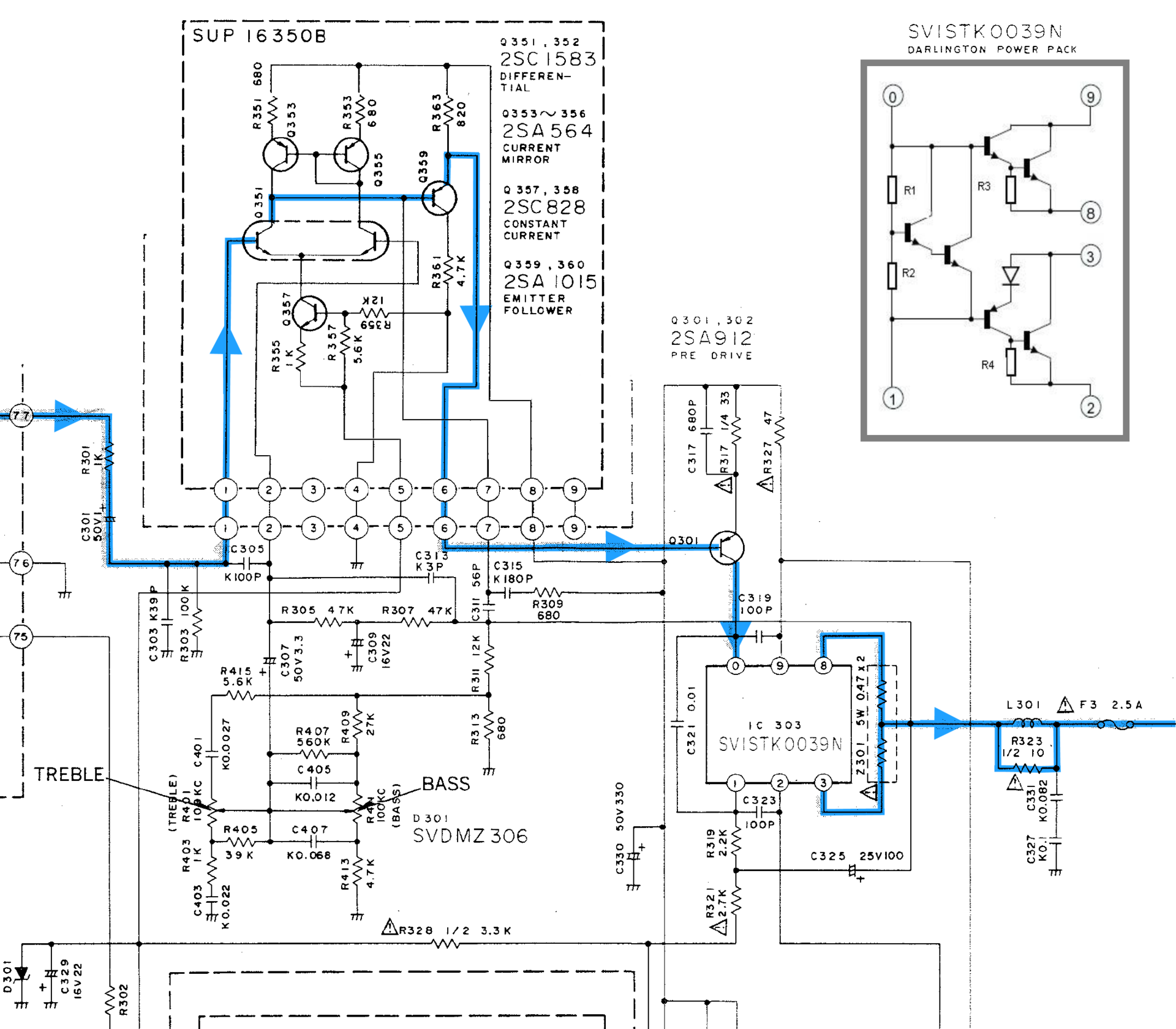

SU8022 , Technics left channel distorted. Schematic please

    Replaced the 2 STK0039 chips , plus swapped the left & right pre-amp drive boards , with no change in symptoms.

    Here is a scanned schematic... better than nothing.

        Here's another.
