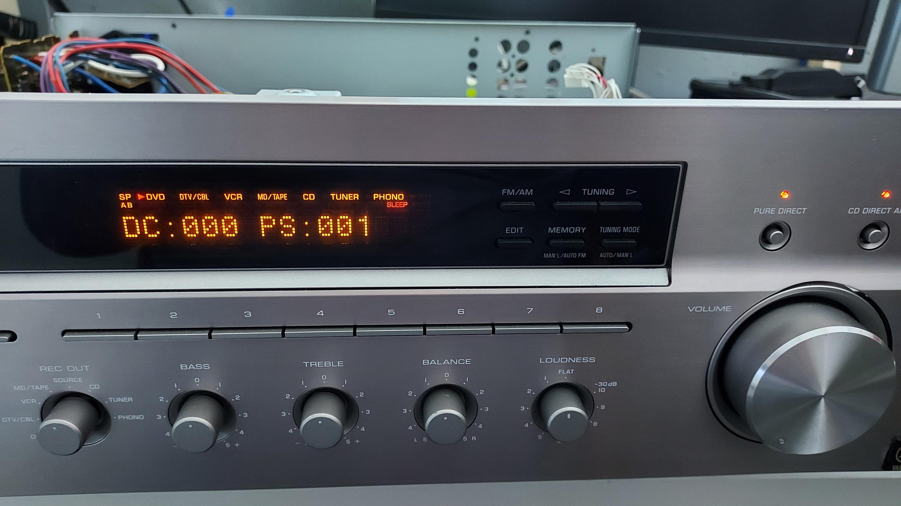

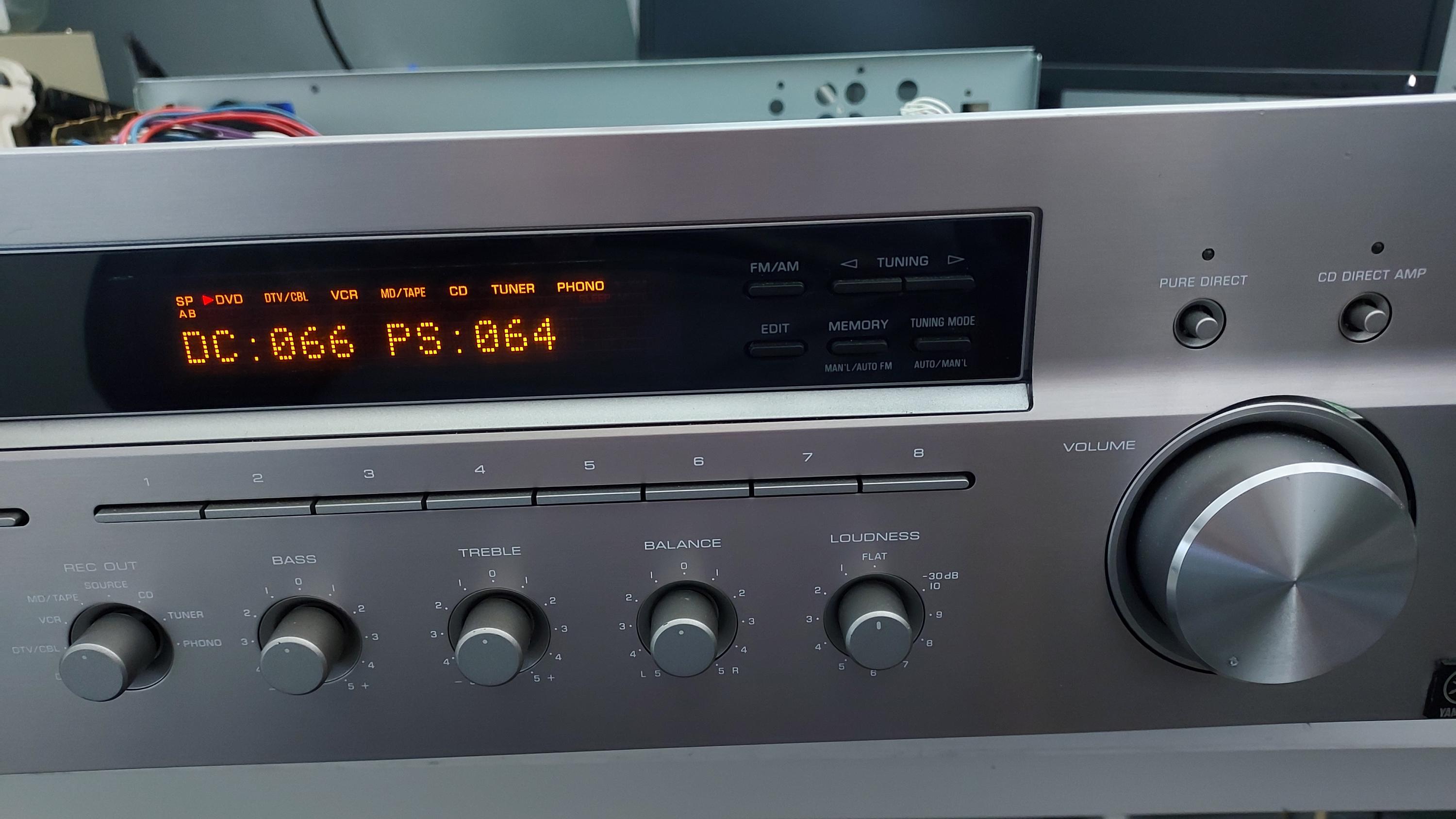

    Hi:
    I am trying to rescue this Yamaha amplifier. It turns on, does some relé clics and then switwes off.
    Following up the service manual, I've entered into diagnosis mode (Fm + 8 + switch on during 3 secs to avoid protection). It shows the error shown in one of the pictures. If I am not misunderstood it might be a power supply issue.
    These are the voltages I am getting in CB272 connector (page 33)
    Amplifier just plugged in:
    S10 -> 9.7-10.3V (quite unstable voltage)
    PRY -> -122mV
    E -> -108mV
    PDET -> 5.06V
    +5M -> 5.10V
    /RES -> 4.99V
    As soon as I switch on........voltages decreases dramatically (3 rele clicks and let's start again).
    S10 -> 8.85V
    PDET -> 4.02V
    +5M -> 4.03V
    /RES -> 3.76V
    I've checked the 2 boards that make the power supply unit. All seems to be correct at component level......but I guess it's obvious that might be not true, right? or there is something outside that drains so much current? (I don't think so as the voltages in standby mode "dance" quite a lot.
    Any guidance is more than welcome.

    Re: Yamaha RX-797 going into protection
    start by checking the voltages shown on page 30 for the power supply area.

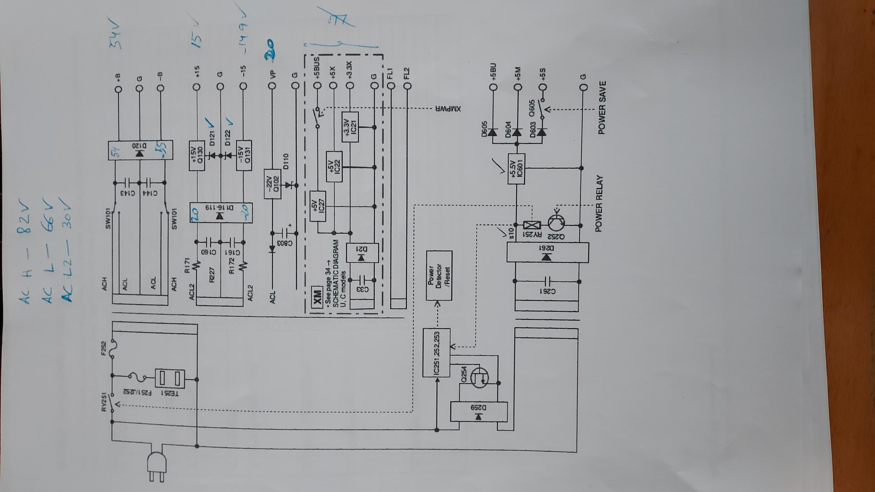

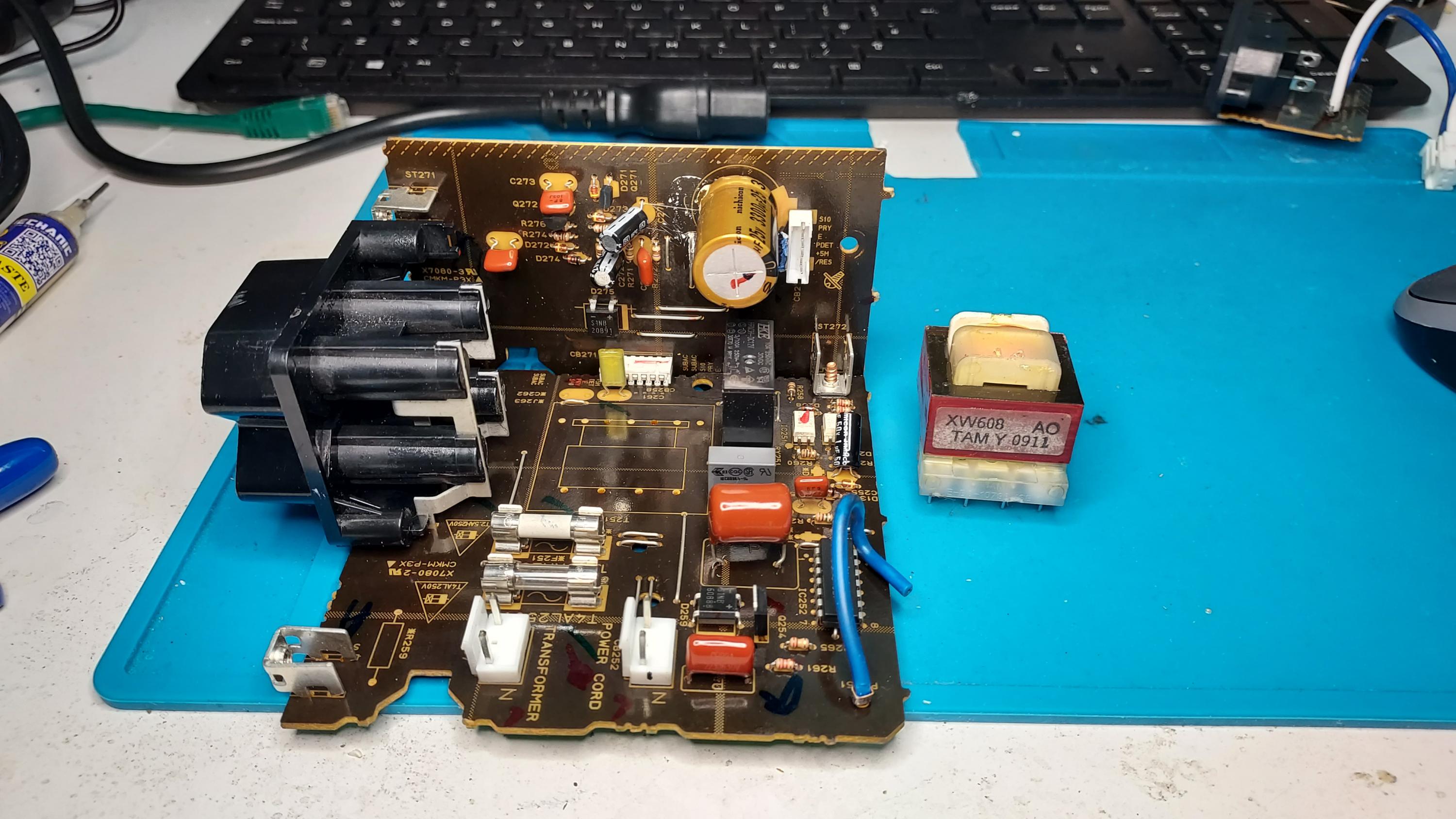

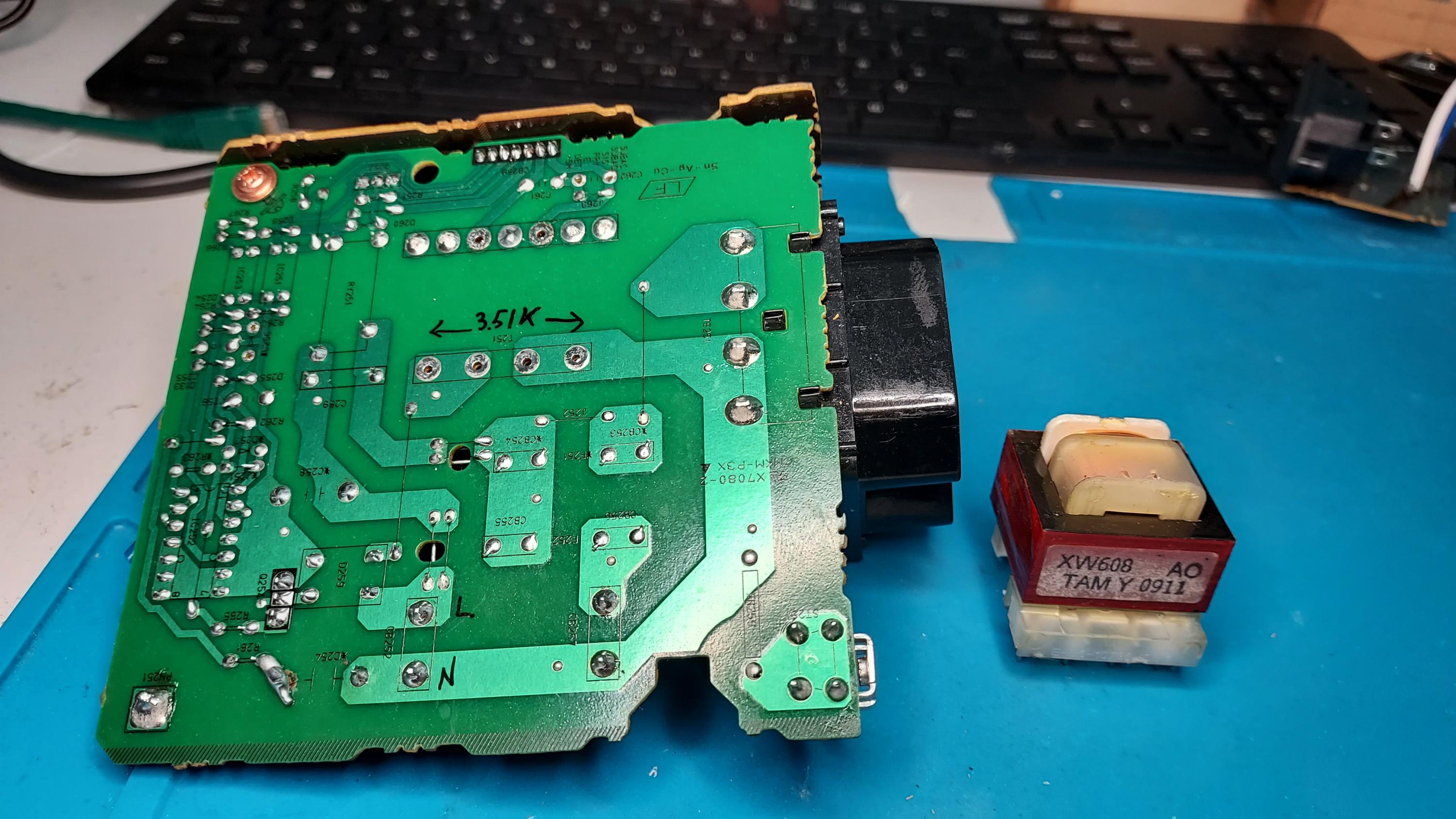

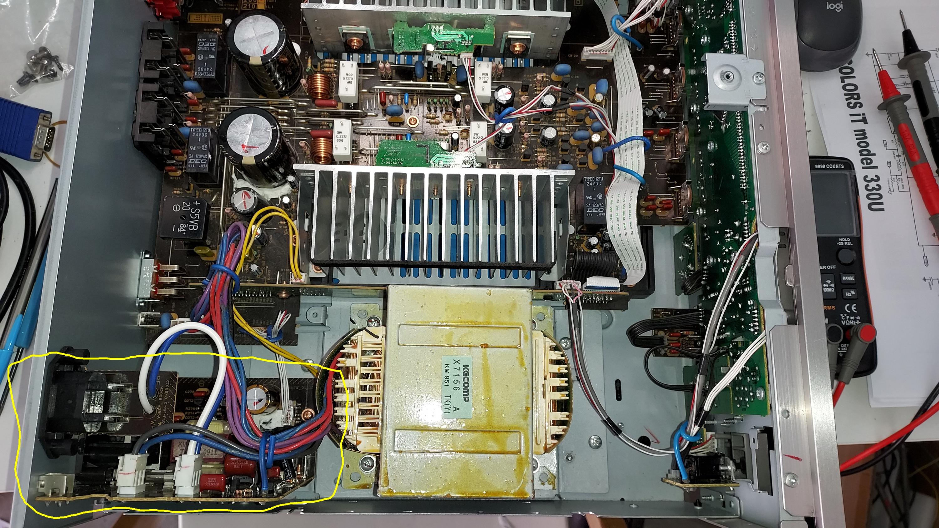

      Thank you so much for the hint, budwich. Indeed the picture help me to realise that more likely is the transformer that has gone. I mean.......it's not normal the the primary has 3.5K impedance, right???
      Other topic is that this transformer including shipment will cost about 30€!!! (I saw it in ebay). Any alternative you might consider?
      Is it a 115VAC - 12.8V right?
      Regards,
      Francesc.
      • lotas
        • Jan 2016
        • 4936
        • Russia
        This is a low power transformer, so 3.5 kOhm is fine, as long as there is no open circuit.
          As suggested, I would do some voltage checks first. You should be able to readily find the power in points and outs for the transformer among other things. I would think its more likely a lost rectifier or possibly a cap depending on what you find.

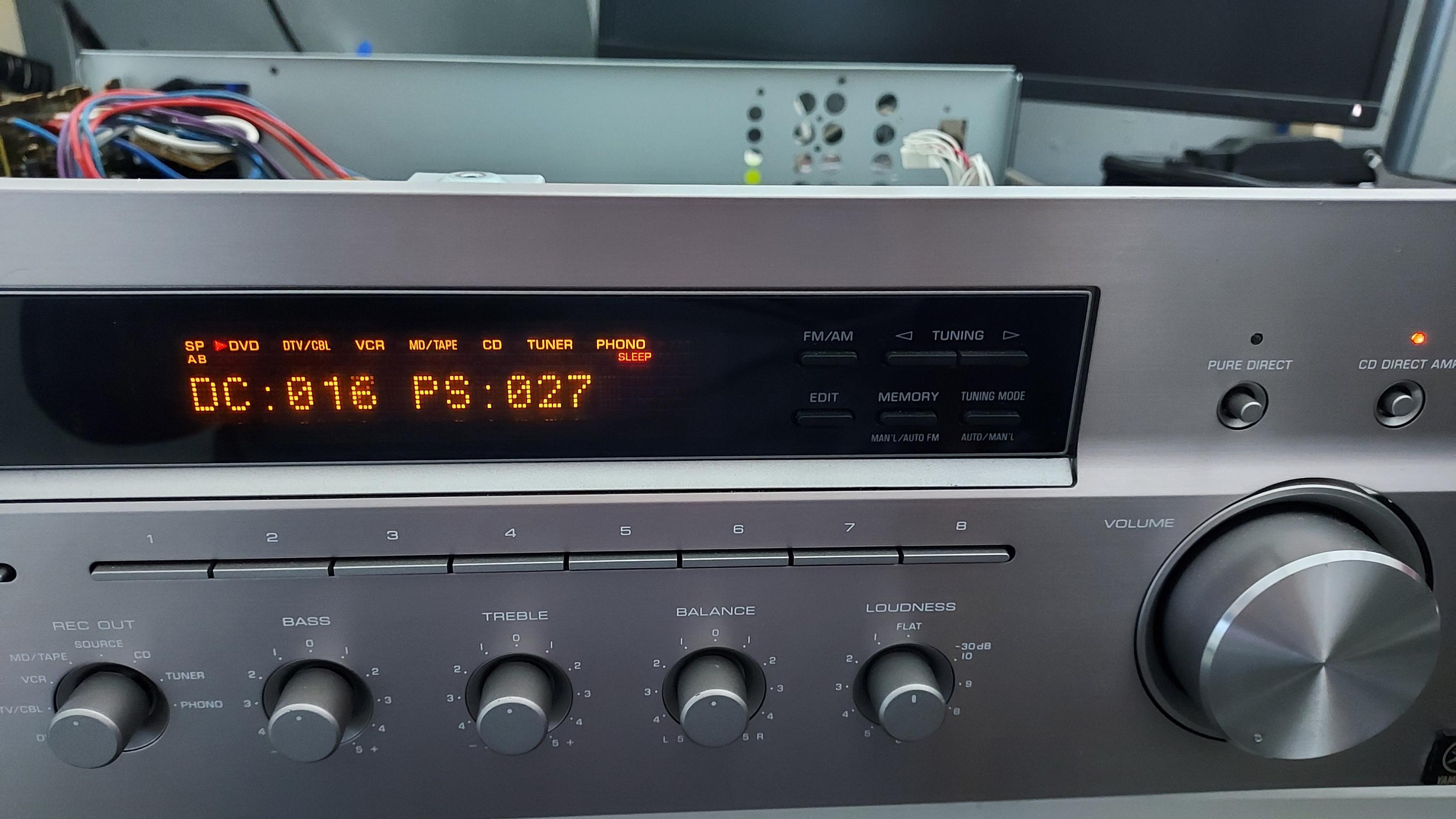

            Hi:
            I've started with voltage measurements following the schematics on page 30, but everything "seems" ok.
            Also power supply unit seems ok:
            S10 -> 9.9 stable
            PRY -> -122mV
            E -> 0V
            PDET -> 5.06V
            +5M -> 5.10V
            /RES -> 4.99V

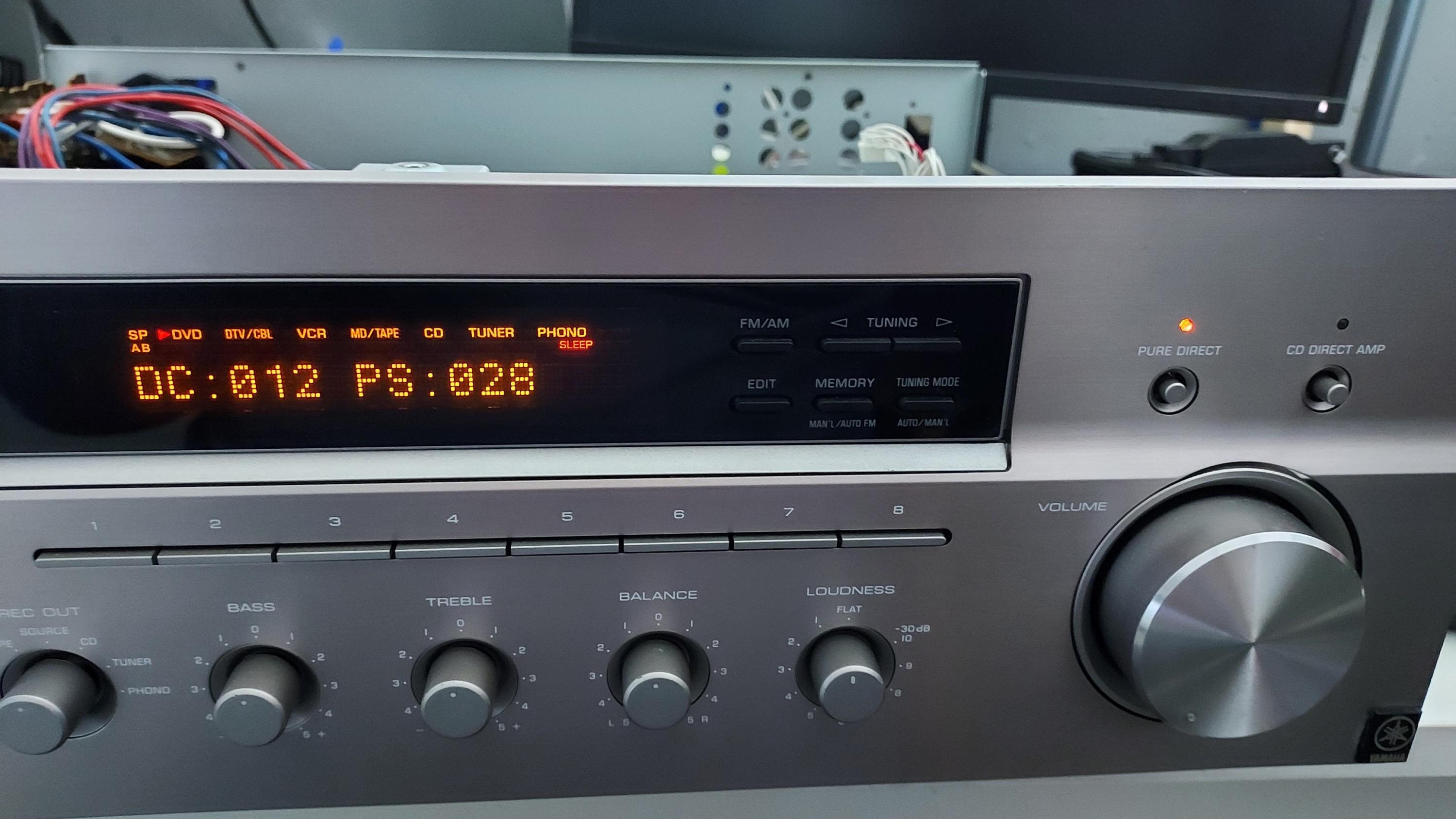

            When I enter into the "protected menu" and check menu 3 (AD DATA check) I got different numbers based whether I click or not (cd direct amp / pure direct).........not sure if they are telling you something.
            Any suggestion / next step more than welcome.
              I guess my question would be when did you measure / monitor the points.... just after startup, as many as quick as possible before shut down, monitored each until shutdown?
              Just guessing based on your initial display of the "B" in the protection display that the "B" supply has an issue.... certainly just a guess. what is sw101? what is set to?
                Measurements were done just after the startup (I had about 2 secs before turning off). However once measured, I realised that keeping the unit in protection mode, I got the same measurements (they started a little bit low, but then voltage increased).
                What is the "B" that is shown in the display? is it refering to the "main 2"? No idea what the amp. is trying to tell me. If anybody does, please shout.
                SW101 is the speaker selector. It's set up to -> 6ohm(a or b) / 12ohm (a+b)
                  sorry I don't know what "B" means but was guessing it is referring to the "B" voltage. On some other receivers, I have seen something like that refer to the different power boards.
                  In terms of the switch, have you tried switching it to the other position which is what?... and again taking measurements.
                  Further, since you have seen that the basic power outputs appear to be good, then it would appear the problem is further along in the DC domain somewhere.
                  Looking at the SM again... the "B" doesn't appear to have much meaning as it is some sort of "version" letter (very poor explaining by yamaha... but I guess if one is a yamaha tech, then it would be obvious... :-) ).
                    In the protect menu, what is the history reporting?

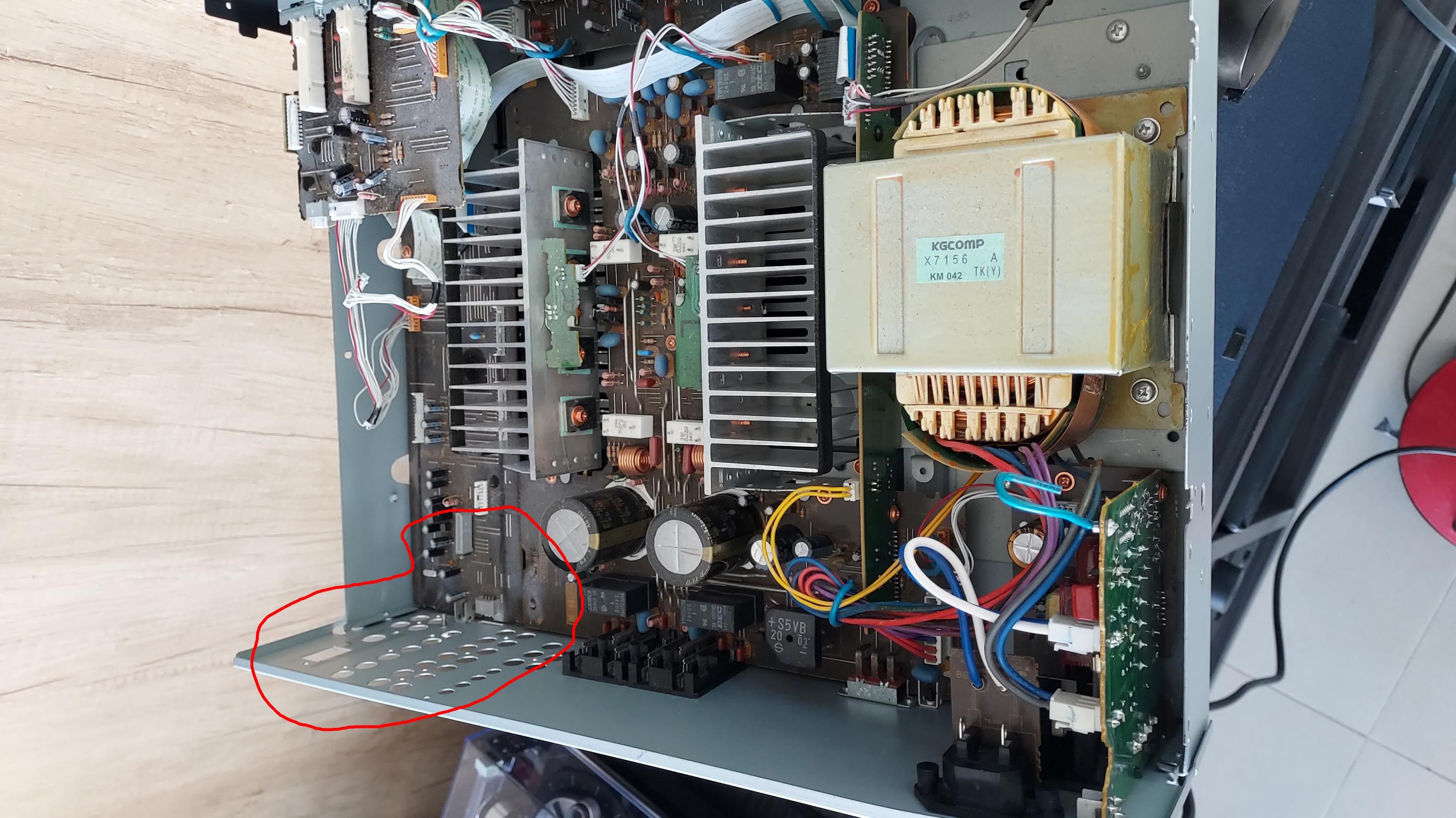

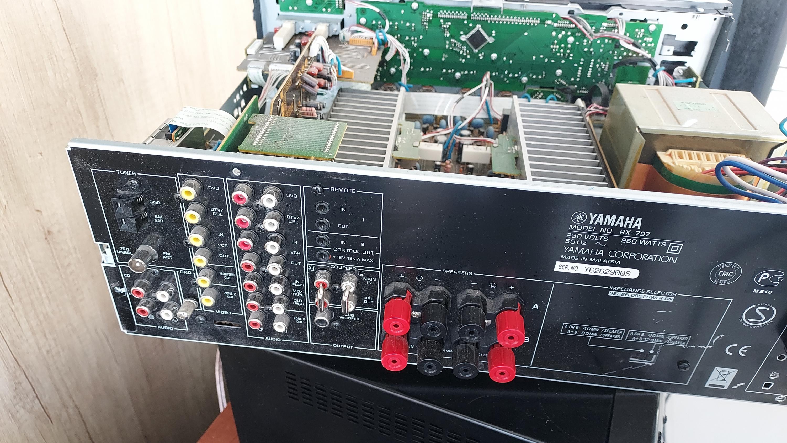

                                    Finally it's working!!!
                                    I bought it as faulty for 20€. It was in protection mode......turning on and then turning off.
                                    First thing I did was to focus on the power supply....initially it had unstable voltage......but I manage to fix it.
                                    The main problem was that I was testing the unit without any additional card, just the main PCB, and then protection was acting. I know it now.
                                    Second problem was also that PCBs were not screwed, so there wasn't a good earth.
                                    So basically, once I haven't found any issue, I assembled and it started working.
