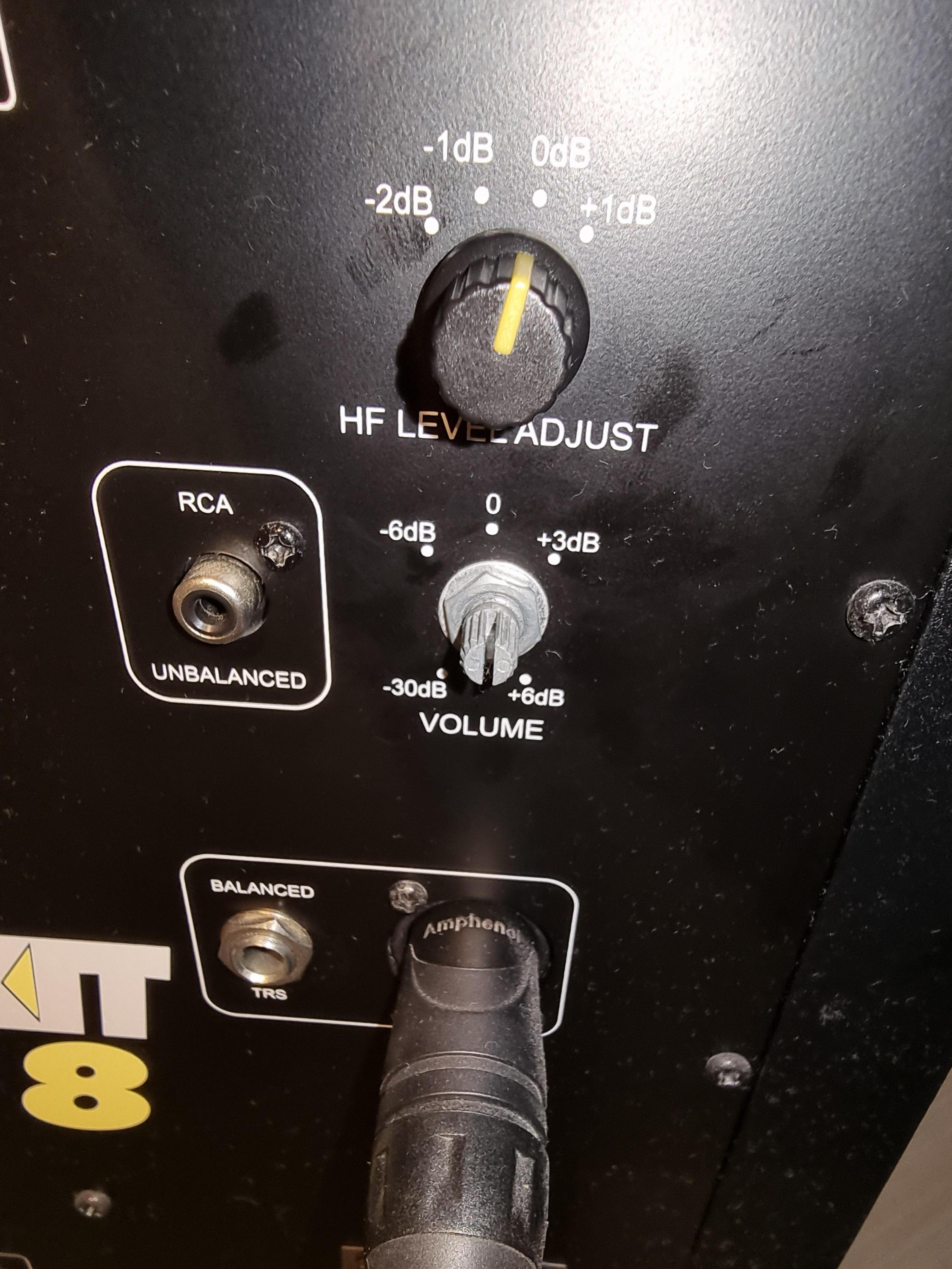

    Hi, I got pair of KRK RP8 G2 modded with new japanes high quality caps cleaned of that black gunk problem and I am very happy with them. but I got this small problem with one pot. don't know if it's potentionmeter or what I tried to change pot. cap with new one and tried to alligne pot cap to be on zero but it just won't align cause that teeth inside the pot cap won't sit where zero is, but on other speaker is as it should be. My question is, does anyone know if pot. replacement will solved the problem.
    On Left speaker vol. pot is not in center ( 40 clicks total, 20 would be middle I even count it ), on the right it's in the middle 20 clicks.

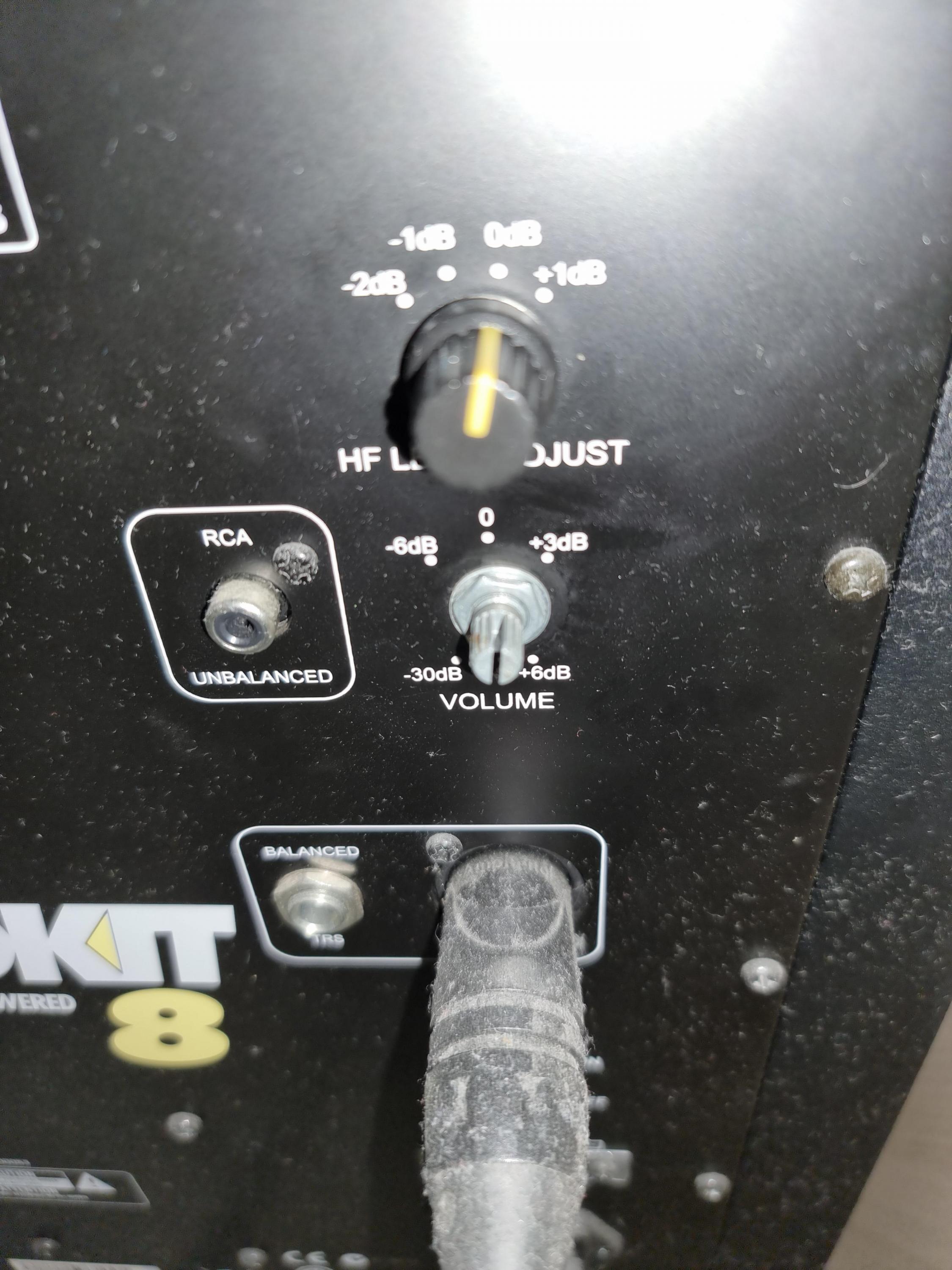

      Here are picture without pot caps (right is the one that is correctly alligned) so left one that looks like it's in center isn't in center when pot cap is on it, that one needs to be corrected somehow.

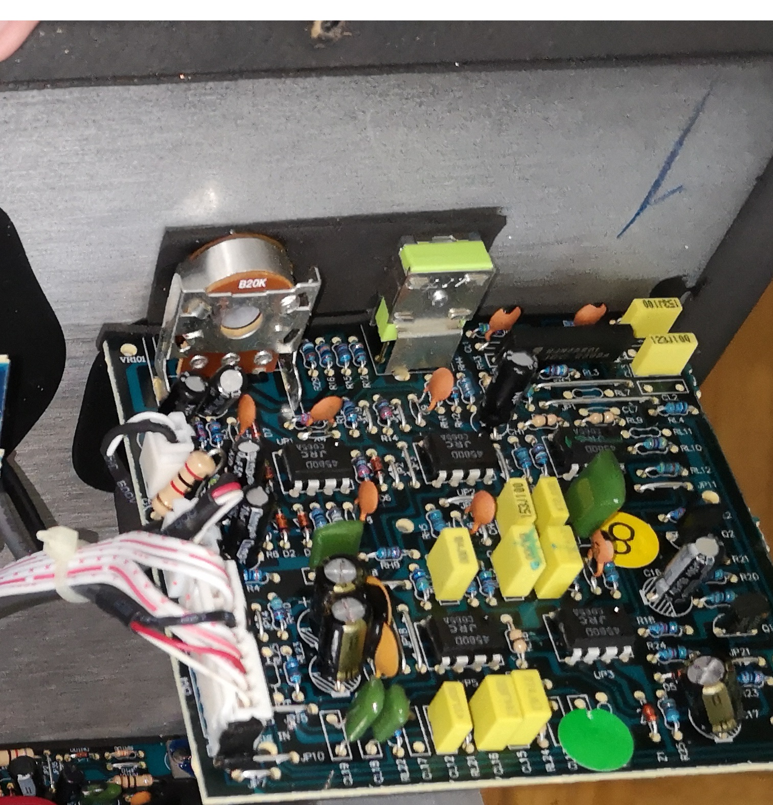

                The hexagonal opening is actually connected to your wiper not an adjustment. Is that soldered crooked on board?
                  I took that picture of the internet yes, acutal picture looks like this
                    Re: KRK RP8 G2 pot. problem
                    Not much to to unfortunately , I think. Only way to rotate is to resolder the pot at different angle, not worth messing with for such a small inconvenience

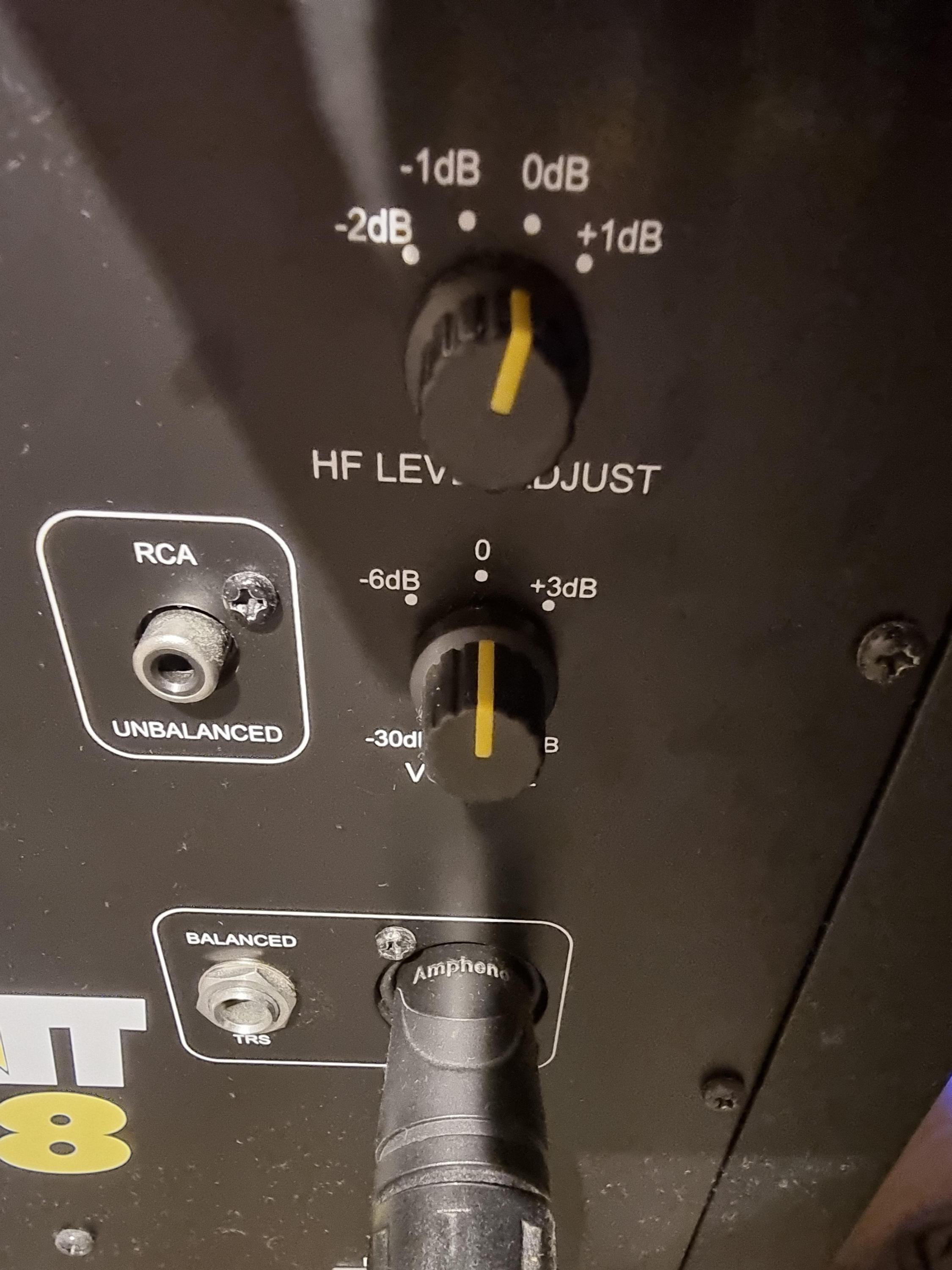

                            I manage to fix it with adjustable knobs, didn't know that exist friend told me.
