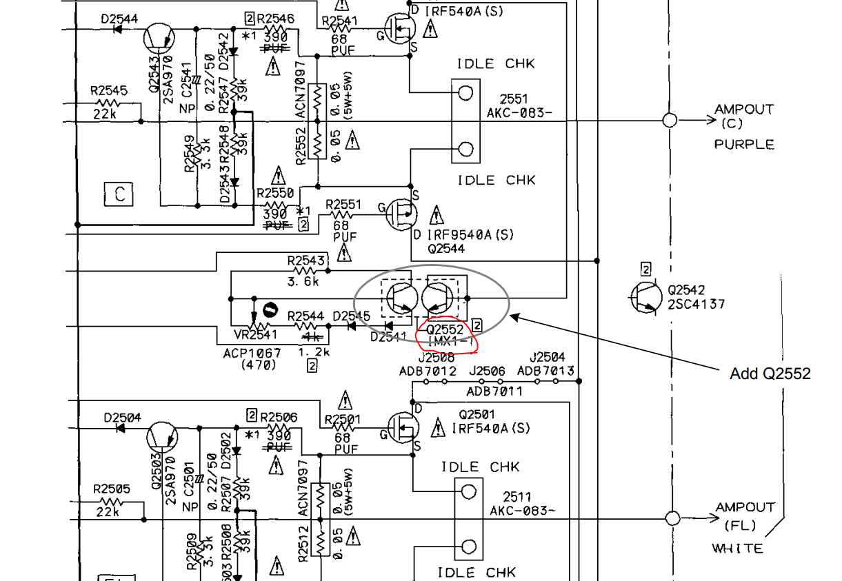

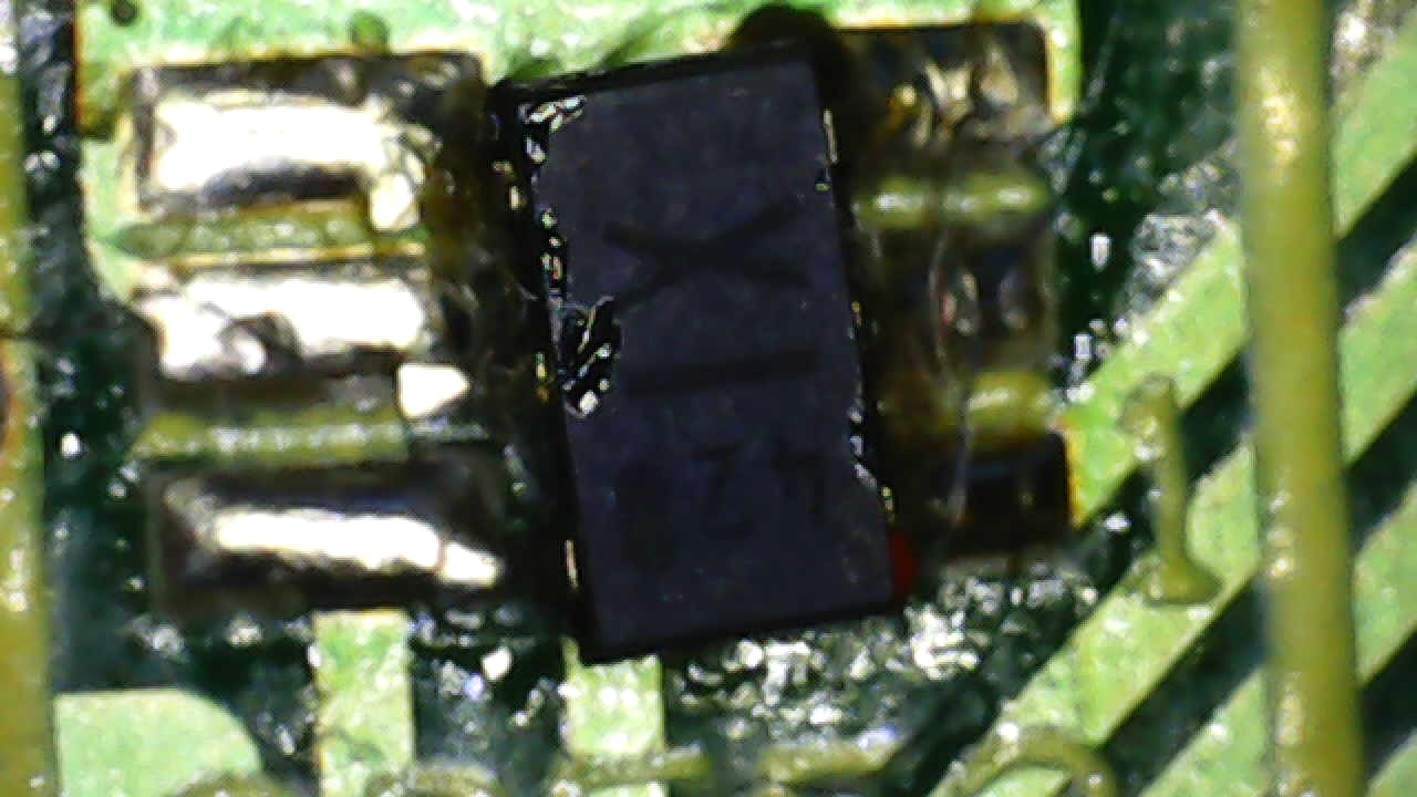

    - Now looking at the power amp PCB I do see a transistor/IC which is not listed/reflected in the SM (Q2552), it's a part with 6 legs, no description on it (see attached photo) and Google wasn't helpfull either. As the part is in the power amp section I just want to replace it to be 100% sure.

    Post a picture of the installed Q2542, I suspect even with the mica insulator it is still shorted by the screw.

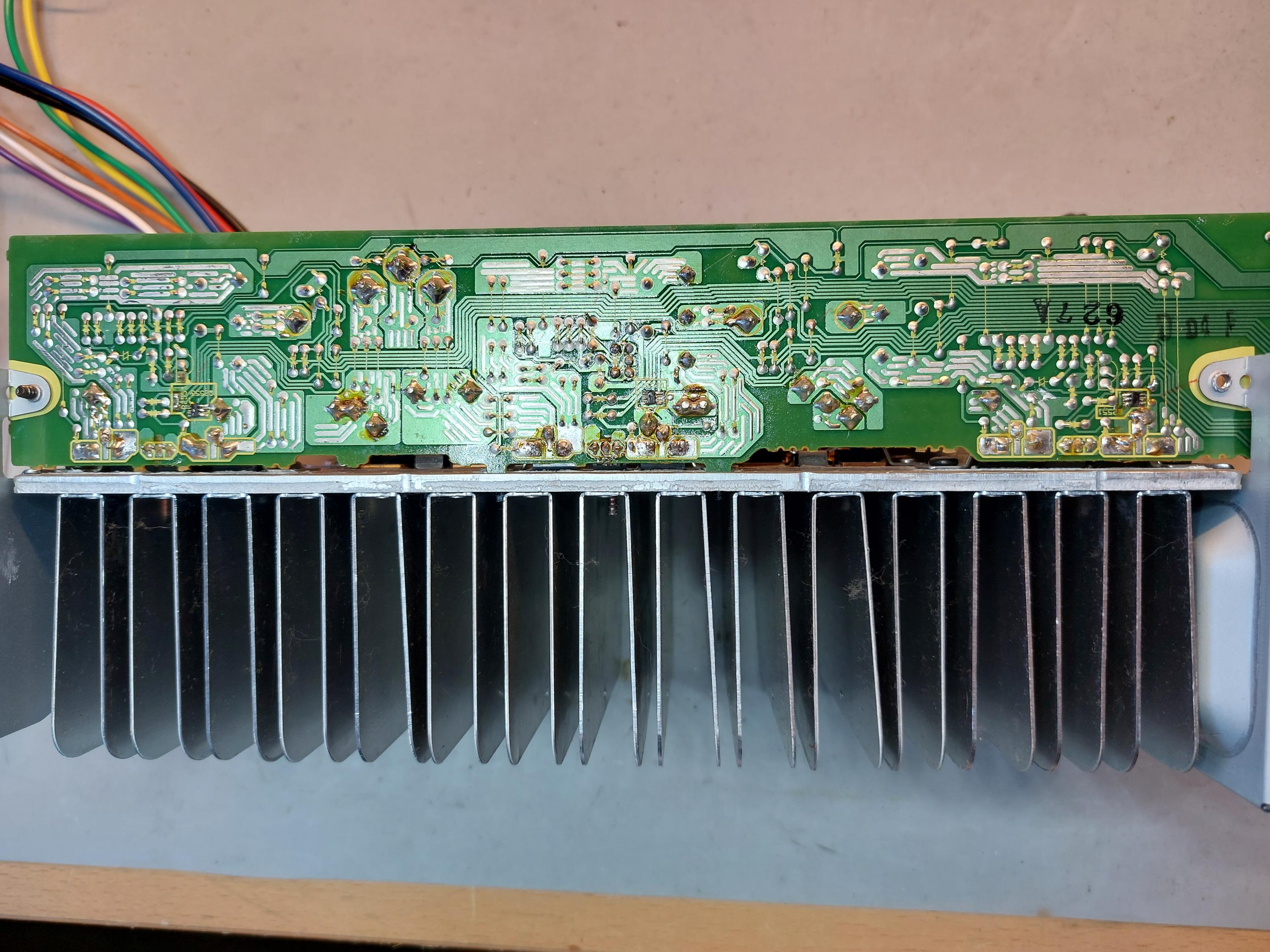

    Post a picture of the complete board where Q2552 is located
    Clean the flux from the top of the component so we can see the markings.

      - Picture 1, complete PCB

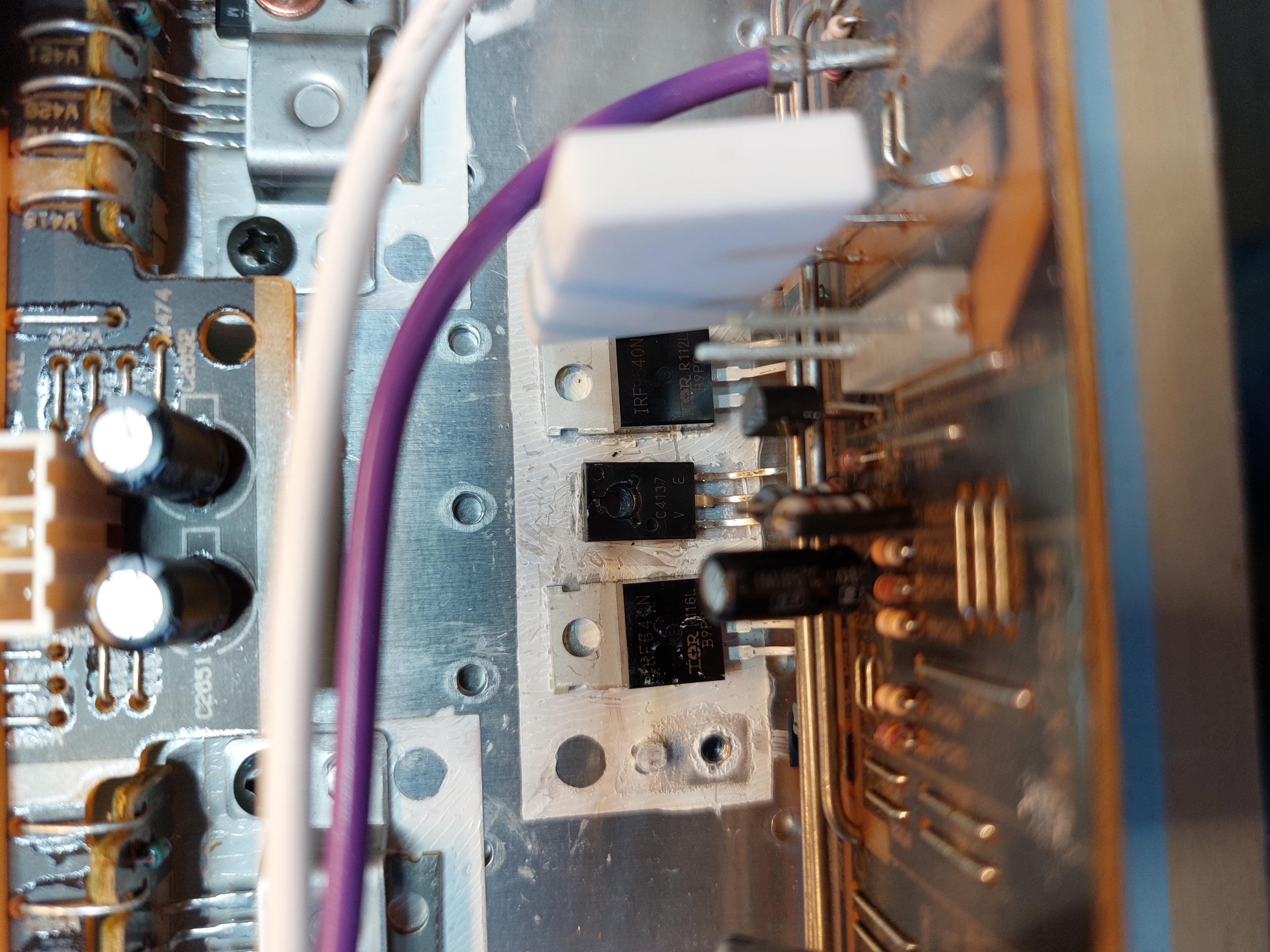

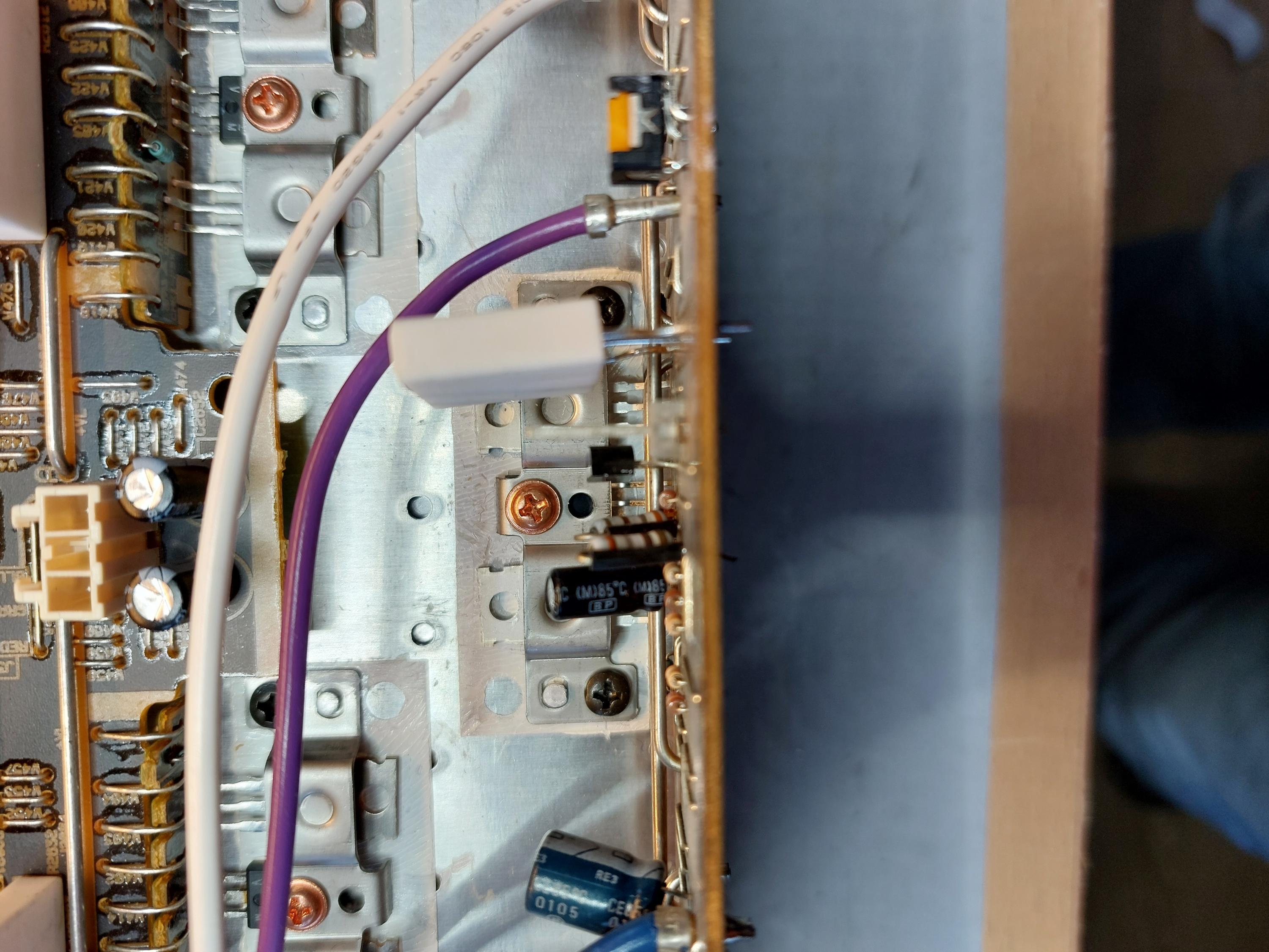

      - Picture 2, snapshot of Q2542 mounted (copper screw mounts Q2542)
      - Picture 3, snapshot of Q2542 without the metal mount strip (Q2542 sits in the middle)

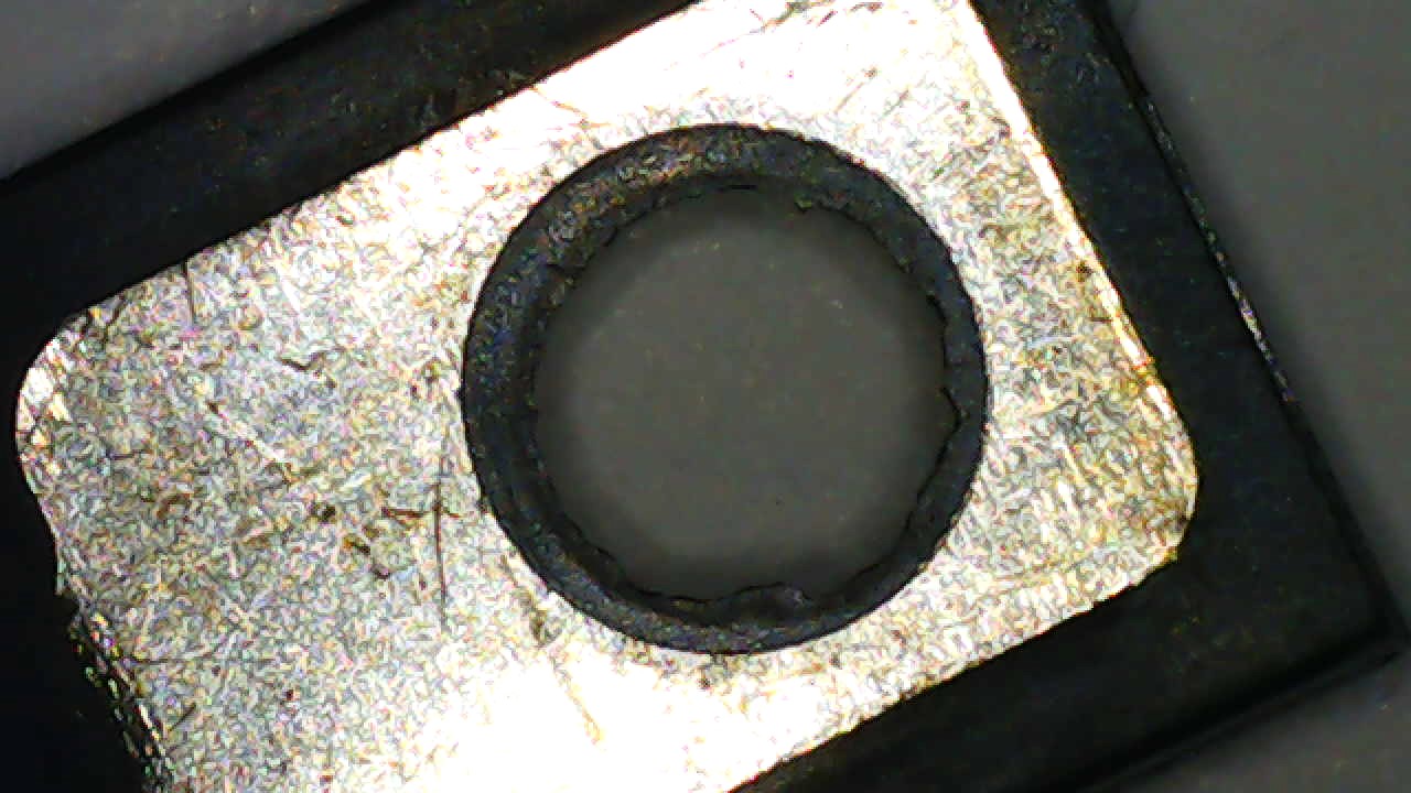

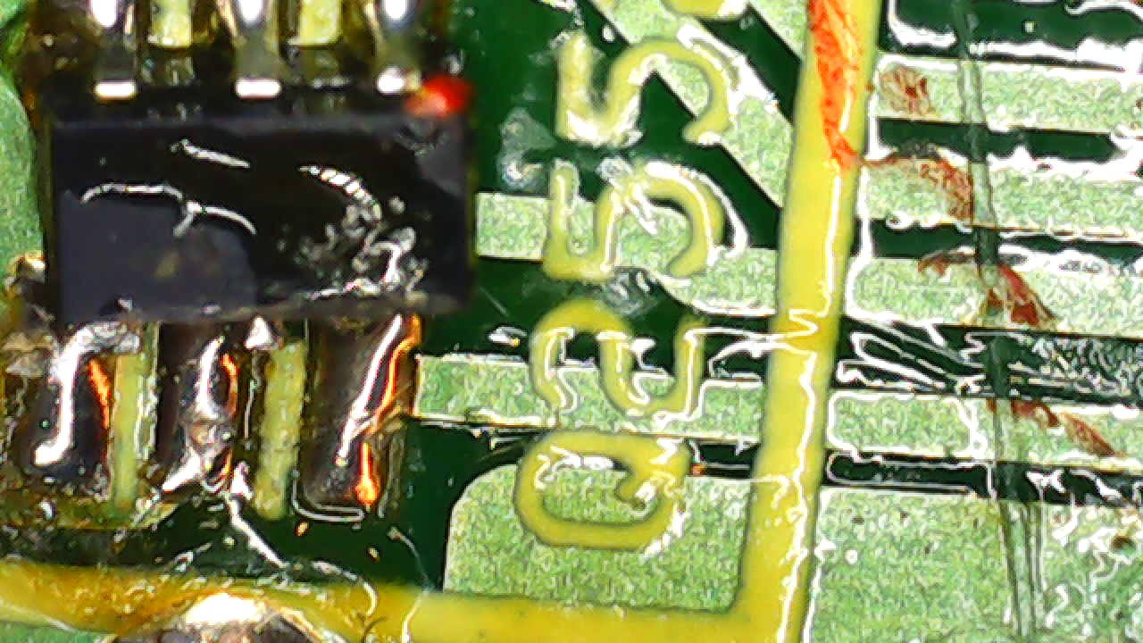

      - Picture 4, cleaned Q2552, now a text is visible looks 420 or 428 with XI or IX below)

      I doubt that the copper screw is still causing shortage as if you look at picture 5 you can see the hole in the 2SC4137 is isolated and with the mica plate between the back and the cooling frame it should be isolated.

        Re: Pioneer VSX-859RDS center driver blown
        X1
          Hi Iotas,
          many thanks for this but how sure are you that this is the right component as it's not listed at all in the SM? Do you have a SM which is reflecting the correct PCB + components? Tnx!
            Is there a mica insulator behind all 3 transistors?
            This is the correct component that is in your picture, IMX1 You can also check each internal transistor to see if they are ok or not
            There was a factory modification where the original board was replaced

              After a closer look it looks like there is one large insulator behind all 3 transistors, check that there is no debris between the transistor and the insulator
              I also see I attached the same pdf, If this has the modidied board I suspect the rest of the modification was already done as well
              After a closer look I don't think the 2sc4137 is even connected on this board, it is likely just used as a seperator for the heat sink mount. The IMX1 is used in its place, and they only use one of the transistors and the other transistor leg is just used to couple the heat to the IMX1. so if the one transistor IS bad, you should be able to use the other transistor (if it is good) by turning the ic 180 degrees

                Originally posted by rupsenkind
                hi iotas,
                many thanks for this but how sure are you that this is the right component as it's not listed at all in the sm? Do you have a sm which is reflecting the correct pcb + components? Tnx!
                q2552

                  Tnx R_J and Iotas,
                  looking at the info you provided I agree as well that the modification already was implemented in this unit as Q2552 is now present on, what I assume, the new PCB. I've checked if debris is between transistor and insulator but it's clean.
                  For the blown resistors: it was R2552 and R2057 on the V-AMP board. I've tested Q2047/2048 but they were ok, just to be sure I've replaced C2053.
