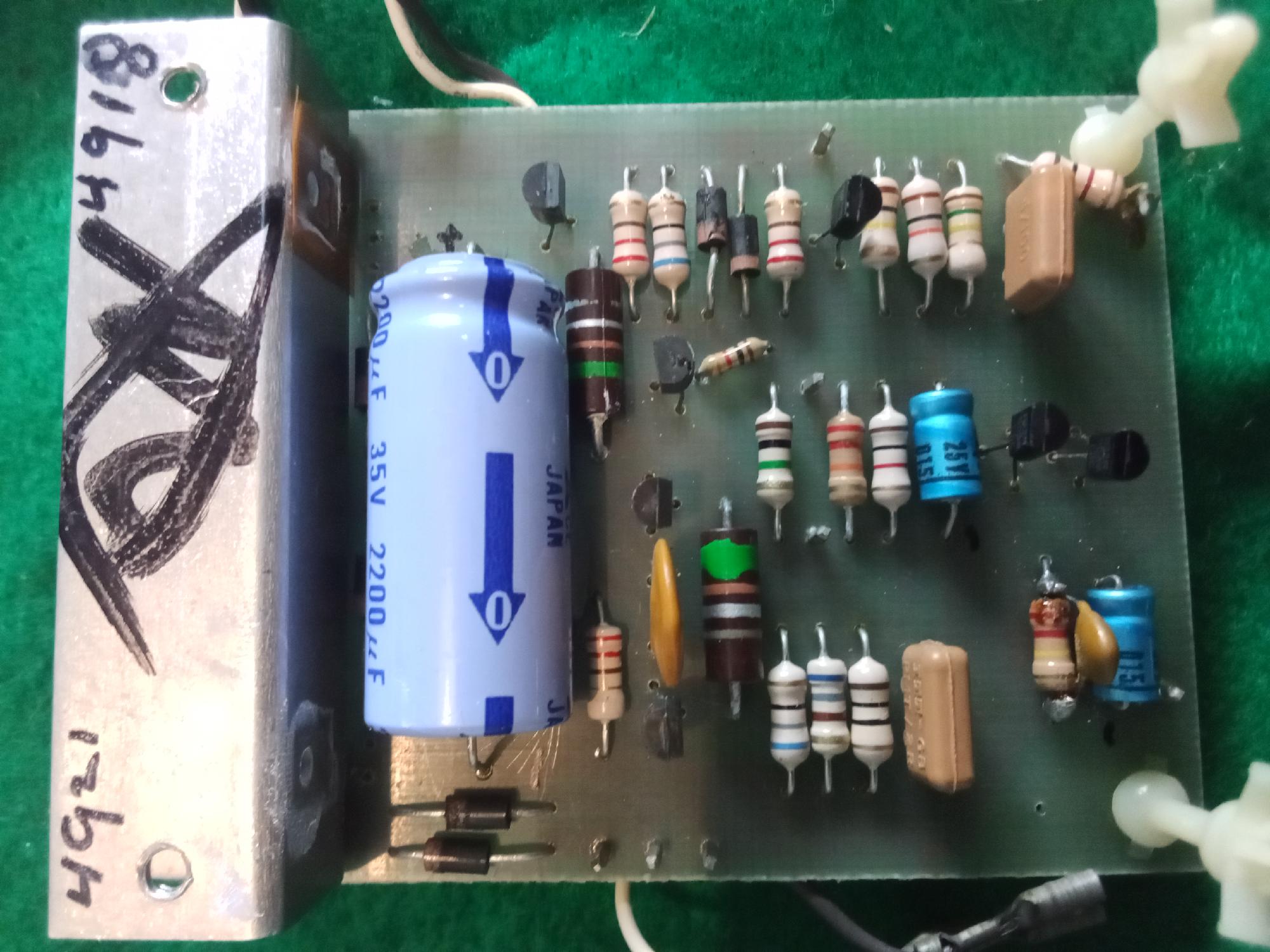

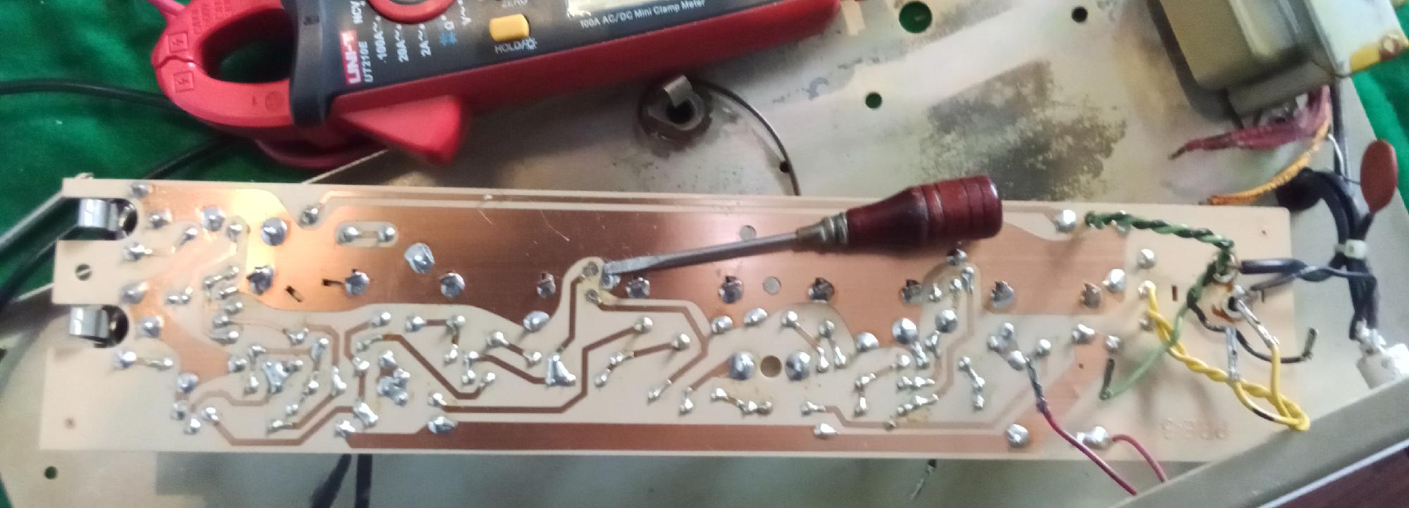

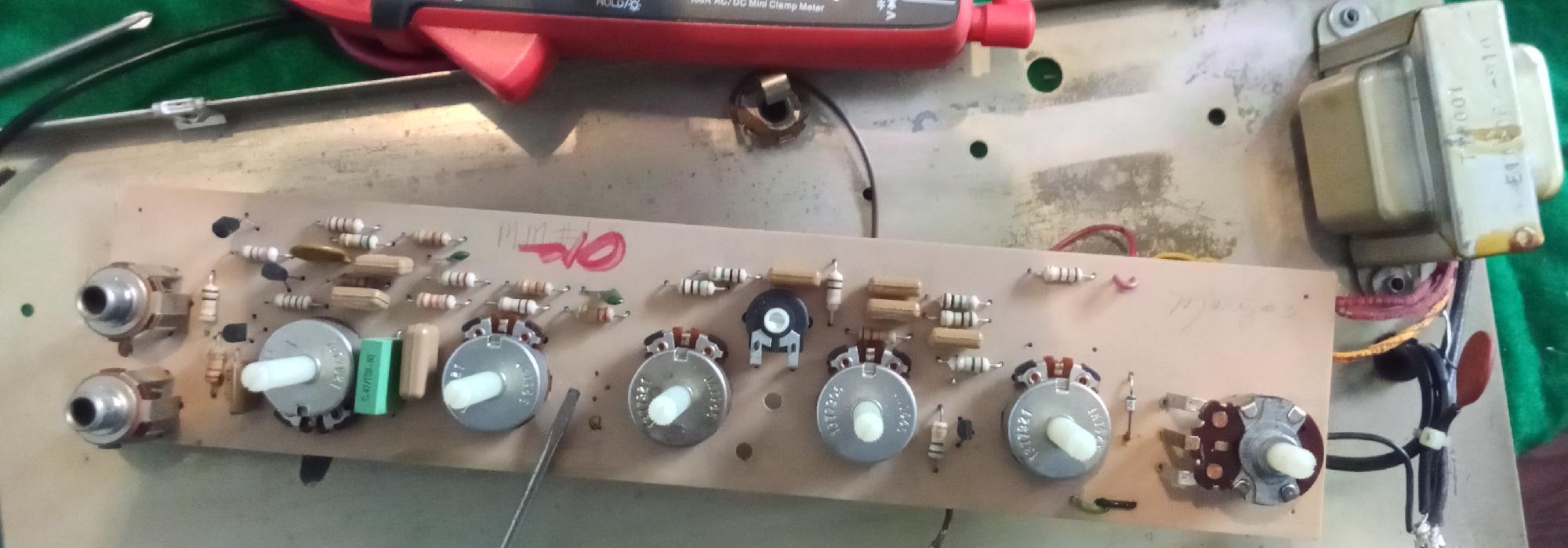

    Hello- This is my first real project, a Rickenbacker TR7 guitar amp, first generation, (tremolo, no distortion) not working, 100 watt dim-bulb tester stays glowing, though not brightly. The 2n5462 (JFET?) the screwdriver would be pointing to in 2 of the pics tests as a resistor between center leg and one end according to TC1 M-tester. Part seems to be unavailable unless I get 20 shipped in from unknown expensive source. The 4 caps test low esr, but amp is 45+ years old, so I imagine I should replace at least the 2200u35v, and the 470u,35v electrolytics, and it seems I might as well replace the 2- 22u25v while I'm at it. Any opinions?
    So, what I'm hoping for is a direct replacement for the 2n5462, and the directions as to which leg goes where in comparison to the 5462, and I would appreciate any advice as to which caps to use, Mouser, Digikey or ?
    Right Model No. but wrong schematic I think- Wrong, decade newer model, but right amp schematic I think- Closest preamp I could find- Pictures attached. Thank you for any help or advice you can give, I'm an old dog trying to learn new tricks. -Peter.

                • redwire
                  • Dec 2010
                  • 3900
                  Re: Rickenbacker guitar amp, need help with substitution
                  I think you need to first know what section is malfunctioning. Pre-amp? Power amp? Narrow it down instead of bouncing around.
                  It's normal for a JFET to read low ohms D-S, they are a normally-on device. I would suspect the TC1 M-tester because a P-ch JFET is an oddball and 2N5462 has a VGSoff of up to 6V and your tester puts out less than 5V or not enough to switch off the device, and possible to give a false report. As I recall the tester can't do P-ch testing properly, firmware bungles the test. The JFET might be fine although they do get static electricity zapped at the guitar jacks.
                  I would first focus on the power amp. The blue Philips electrolytic capacitors don't last, I would replace them. C3, C5 22uF 25V. Your power amp pics don't show the output capacitor C6 470uF, where is it? It's on-board in the Rickenbacker schematics.
                    Thank you Redwire. The 470uf is hidden under the heat sink. What is there now is a 500uf 25V. It looks like a good solder job, but I suspect it is a replacement. I'll replace it again anyway, with a 470uf 35V or better. No telling how old it is.
                    I'll put the JFET back and test with 4 new caps.
                    I was going to get the new caps here- https://talonelectronics.com/shop/item.aspx?itemid=5451 because they have the specified JFET, although I'll have to stretch a radial 470uf cap because they have no axials in that range- https://talonelectronics.com/shop/item.aspx?itemid=7239

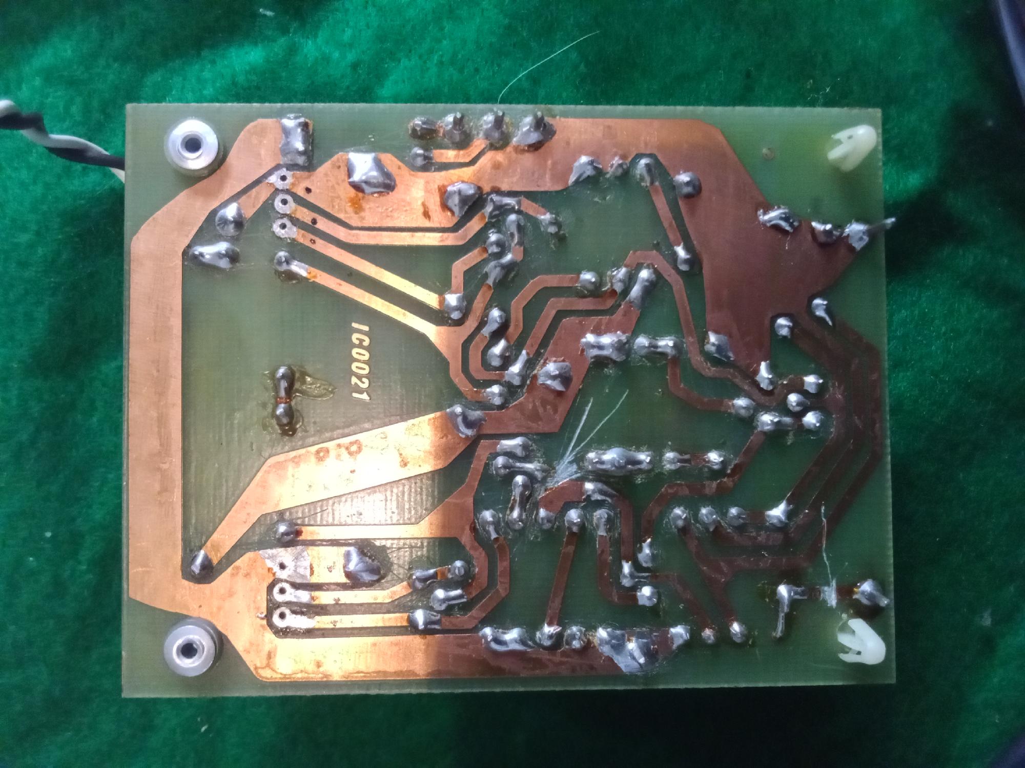

                        Thank you again Redwire. I removed the power amp transistors because they would not test; neither with my multimeter's diode setting, nor with the test leads on the TC1. Both methods tested one of them as faulty, and while I was removing one, I did the other because the testing felt iffy. Once removed, they both test fine both ways. Same reason I removed the JFET. I found a test procedure for an N channel, and the demonstrater said he had no P channel to demonstrate, but that it was done in the opposite way. I had hoped the tester would be smarter than I.
                        I just removed the 2200uf, which I knew seemed faulty, and off the board, it tests zero ohms both ways with a capacitance of 0.L so we know it's Out of Luck. It was glued on with the same hot glue(?) that is holding the 500uf 25V hidden under the heat sink, which seems to test good, in circuit, and the solder joints look the same, so I guess it might be original, though of a different make, and marked W-Germany, Which probably makes it old enough to replace. The blue 22uf caps also test good, but I will bow to the wisdom and replace all 4 electrolytic caps. Thank you again.
