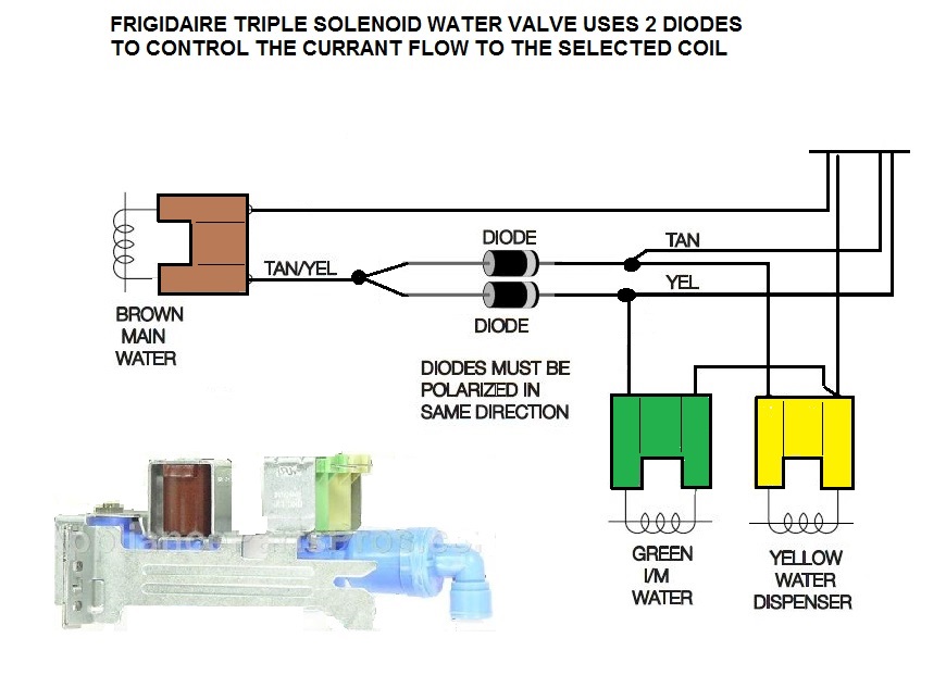

    Frigidaire Refrigerator Model FFHS2612LS0 Water Inlet Valve Diode Kit cost around $40 and is just two wires, each leading into a $0.25 diode which then exit into one wire. Does anyone know the type diodes used for controlling this water solenoid bank of three?
  • redwire
    • Dec 2010
    • 3912
    Re: Frigidaire Refrigerator Model FFHS2612LS0 diodes

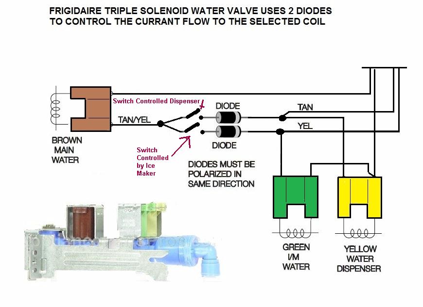

    I looked at Frigidaire Refrigerator Diode Repair Kit 5303918287, 789911908505.
    It's got three wires, two diodes inside. Seems to be an OR-gate such that the inlet-water main solenoid turns on if either the water dispenser is pressed OR the ice maker turns it on.
    Just use a plain vanilla 1N5408 diode 3A 1,000V rated. A smaller 1N4007 1A 1,000V might work fine as well but solenoids have inrush current and not sure if it's over the 30A surge rating. It is likely the solenoid spike voltage is what is killing the original diodes or Whirlpool cheaped out.
    Ultimate BY448 2A 1,500V $0.67 ea. at Digi-Key or Mouser.

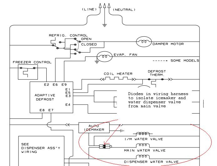

    I found this schematic but will check the diode's polarity...
    edit: seems to jive with other wiring diagrams. To test, multimeter on diode-test and (+) to common lone tan wire, (-) to each single wire for each diode.
            People complain the diodes either go open-circuit or short or one guy had smoke but that seems strange.
            Shorted diode: pressing the water dispenser, and water comes out of both the dispenser and ice maker tube.
            Open (dispenser) diode: no water dispensed
            Open (ice maker) diode: ice maker won't fill (it typ. runs for 8 seconds).
            The water solenoids are driven by 120VAC mains, their common leg goes to Neutral. But the single inlet solenoid gets the 1/2-wave DC from this diode module. I don't know what controls them on the board(s), it looks like relays but Service bulletin advice is a little strange:
            Water dispenser - yellow (dispenser) coil should have mains 120VAC, and the inlet solenoid (single valve) will have 54-78VAC.
            Ice Maker - green (ice maker) coil should have mains 95-105VAC, and the inlet solenoid (single valve) will have 42-58VAC.
            The voltage measurements are a big wonky? Fridge runs off 120VAC and ice maker gives 95-105VAC? It must have little triacs or something?
            You'd think by now Whirlpool would know how to reliably turn on a solenoid lol. Putting diodes in a wiring harness is expensive and this affair goes for $40!
            I think the back-EMF from the solenoid is damaging the diodes because they see two solenoid's worth of spike, there is one on each side. I've also seen a water solenoid kick back even more due to the water pressure kick on the pintle so they act like a generator and make an extra big pulse with the residual magnetism.
            As far as current drain, the one should only draw under a hundred mA plus inrush. The original diodes must be cheap or only 400V or something.
            For an appliance maker to add a snubber or MOV to stop surges, it's $0.25 and would break the piggy bank.

                                    I am not complaining about this fridge, after all it was purchased in 2005 and its not a daily problem. It just seems odd that at any moment, it can start peeing out the water dispenser and flooding the freezer with ice maker continuous over fill in the middle of the night because these diodes decide to give up the ghost.
                                    • redwire
                                      • Dec 2010
                                      • 3912
                                      That means it's likely the diodes are getting blown due to power surges.
                                      Mains transients from lightning etc. (Texas!) or locally generated i.e. by the fridge itself.
                                      Everytime the compressor stops there is a voltage spike and it could be taking out the ice dispenser/water dispenser diodes.
                                      I can't see Whirlpool spending $0.25 on a MOV to protect things and they end up a liability because they can burn up if hit with a really big power surge.
                                      If other electrical things at home are getting damaged, then I would look at some surge protection.
