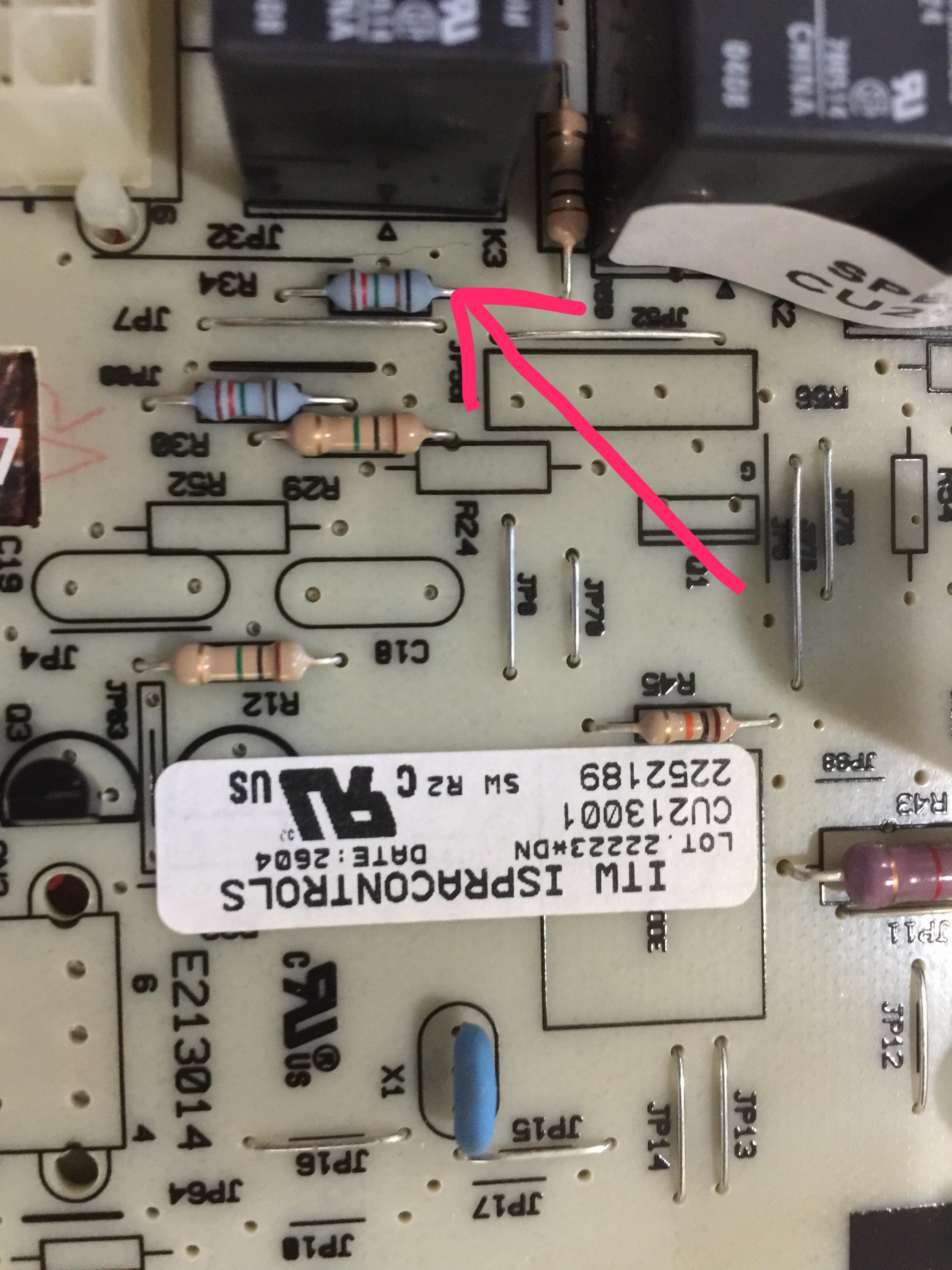

    So 2 days ago i went to get something in the fridge and the thermostat lights were off and the fridge lights were off as well. Fridge is still cooling but i am hearing a buzzing/clicking noise from the back of the fridge. Freezer lights and freezer still working. When i removed the back panel there is a box next to the compressor that it sounds like the sound is coming from. Im guessing a control board. Any ideas of what this could be?

        Please post a photo of front and back of the board

            If the fridge is still cooling then the compressor etc. is still working, I would go with what budm posted with the link to a bad controler board, here are a couple pictures of one, whats the chances of a bad cap on its power supply... relays coils don't like low voltage or unfiltered dc very much which could account for the buzzing, just a thought.
            On another forum a guy said his original board had a burt trace? http://www.diychatroom.com/f47/whirl...m-5577/index4/

              Thank you, i clicked on the form and the samething he is experiencing i am as well. When you open the door you hear a clicking/buzzing noise. When you close it it stops. I will see if i see any bap caps or any other stuff that looks damaged. Thanks again guys for all the input.

                Look for a switching or a buck converter IC chip most of time they have 6 to 8 pins if it does change it and the caps around or near that chip

                    There is a post on that forum where he found a bad transistor near the burt trace, he used a MMBT5401 from digikey, he also replaced a 220uf cap. you may get lucky and that could fix it, control boards arn't cheap

                          Sorry guys i was out of town. I opened up the controller box that is next to the compressor, looked at the board and it looked like a small burn mark on the back. Here are some pictures. It looks like it is R34 but it also looks like the flat thin pin next to it. Dont know if i should just get a resistor and replace it. I dont even know which resistor i need. Plus when i installed the controller board back in the buzzing/clicking noise stopped.

                            What is the part number for U5 ( switching IC chip ) that is probably the problem there is a small cap near that chip you will need to replace that in fact it would not hurt to just recap the hole board
                            You can try replacing the caps first and see if come back to life if not replace U5
                            I do not see any thing wrong with that resistor now it is hard to see if any of the solder joints look dull or cracking re solder then if they do or if they look question able redo them

                              seems to be a common problem, I would check if there are bad solder connections causing the problem, especially if the board is now working
