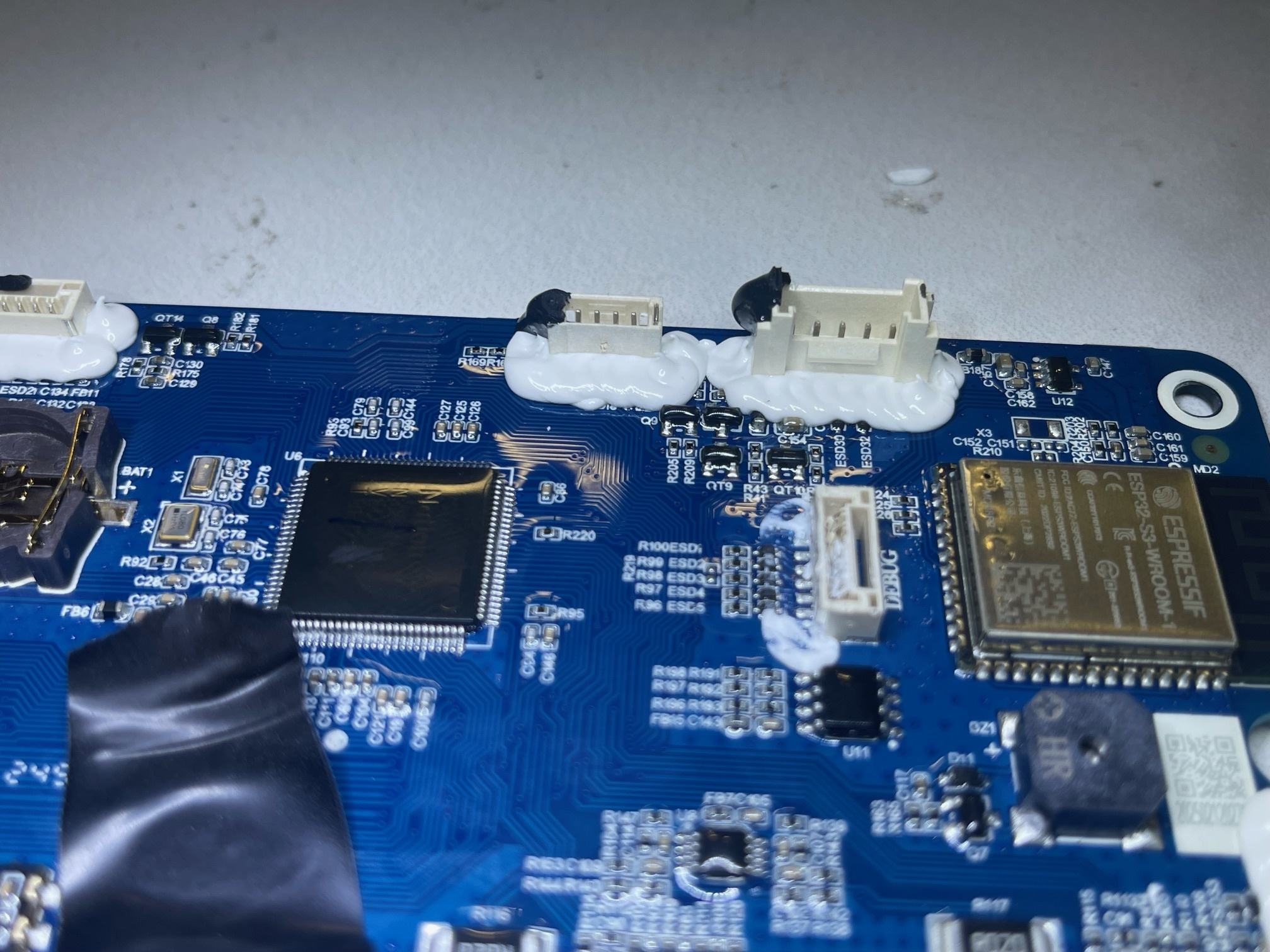

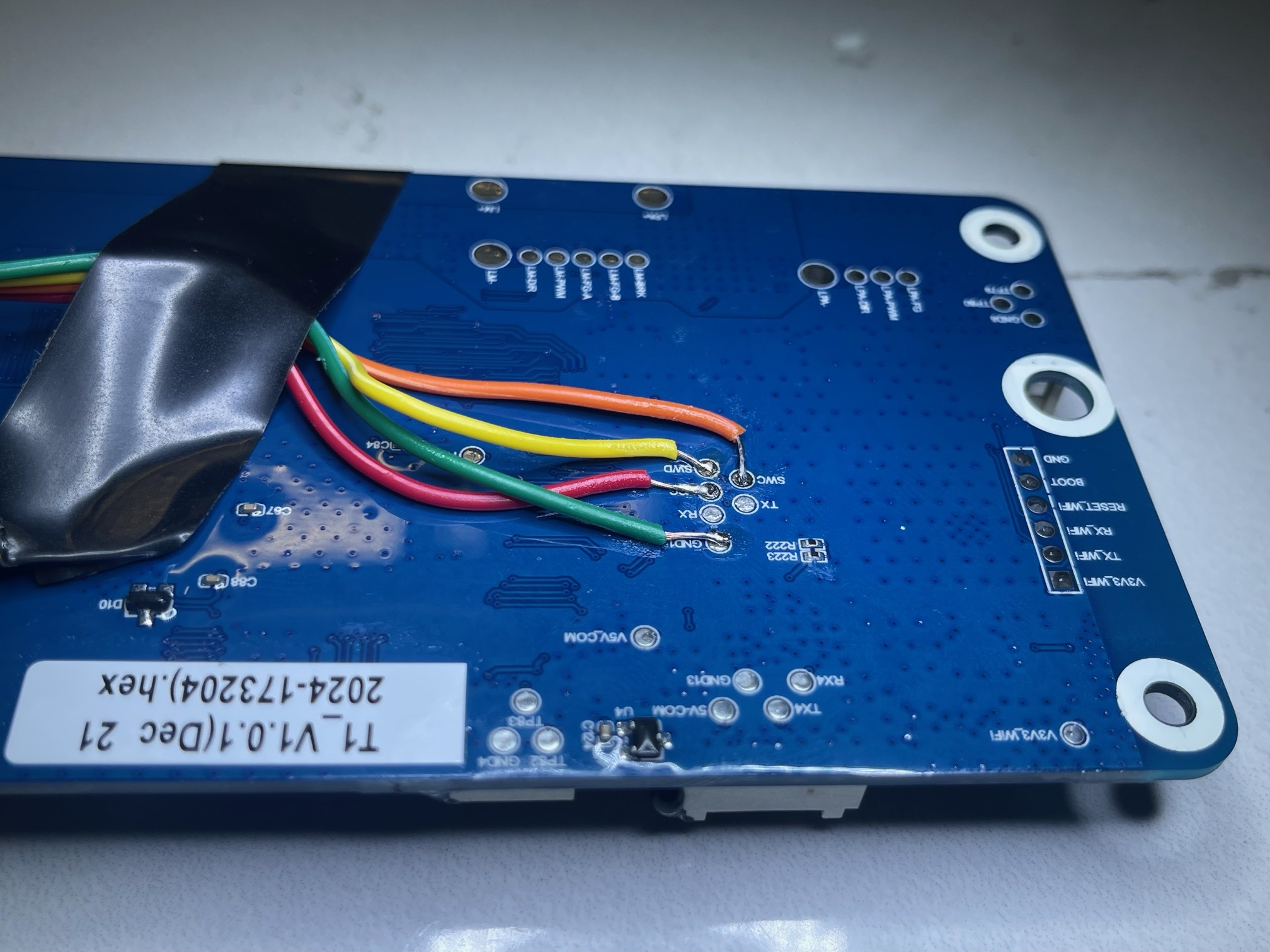

    Hello everyone, I'm not really sure if this is the right place to actually post about this, but i have Aiper Scuba X1 that I'm trying to read the Microcontroller data from. The chip is National N32G455. After dismantling the unit I found a Debug connector and on the backside of the board 6 point that reads: GND RX VCC SWD TX SWC. I'm familiar with Nuvotons, MECxxx, ITE chips but NOT these kinds of microcontrollers. I need someone who can direct me to what's needed to read it ONLINE as they have coated the entire board. I got the ST-Link yesterday and connected the wires as shown in the picture and installed STM32CubeProgrammer software but I can't seem to find the chip and I keep getting "Cannot Identify The Device", which I'm assuming referring to the Microcontroller itself. I've the latest version of the software.

    J-Link is supporting that chip. I think that N32G455 is a STM32 like clone. So the ST-Link programmer probably won’t work on it, because it can’t identify that chip.
    • iTec
      • Oct 2017
      • 31
      Awesome! Thanks a lot, I'll go ahead and order right away.
