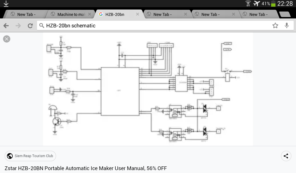

    I guys a friend of mine gives to me this thing, he said it's a machine to create ice. However it going on protection mode with led red (ice full) of course there's no ice, then I take the board control out and look it on the microscope, there are I rele blown up (A1) , (U5 it's like pwm) and other side of pcb there are two chip it looks not so good. My question is existing schematic for this pcb? Because if it's to expensive to repair of course is could be better to putting on the bin.. Thank you all for the answer 🙏
    Hi guys this morning i had some spare time so I'm focused to cleaned those chip to find out the marked on it they are very clear and I hope someone help me with the schematic. I don't know where find it. Thanks to all the community
      Guys I'm here again , so nobody tells me what you think about it? Every reply is helpful...The machine still show me led red (ice full). But there's not ice or water in the bottom...I check everything no short... Those ir led sems works.. I almost mad with this thing..Dammed ! Thanks again

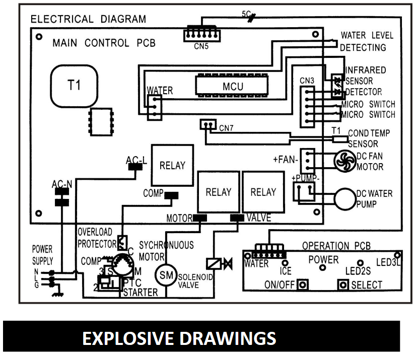

          Check the board has DC power, could be 12VDC. This goes to IC3 LDO SOT-89 to power the MCU likely 5V. It seems to have power if the LED lights?
          You can see the switched outputs:
          One mains relay output for "compressor"
          Two mains triac/opto outputs ("motor", "valve")
          Two 12V DC output ("fan", "pump")
          Ambient temperature sensor thermistor "CON6"
          MCU inputs are on CON1:
          Ice box temperature sensor comes in on CON1 pin 6.
          Three others going in. Might be switches or LED's.
          I would expect the (5) electrolytic capacitors to be a bit dead from the heat-the board is mounted at the condenser it looks like.
          Look at the ice box temp sensor, it might be open circuit sometimes water, rust get them.
          The switch to tell if the hopper is empty might be bad too.

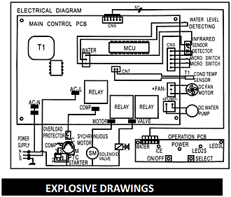

                Click image for larger version  Name:	Ice Maker GSN-Z1 wiring.png Views:	0 Size:	304.4 KB ID:	3241528
                Thanks for adding the model number! The control board is better known as HZB-12A, WZB-16 as well as the GSN-Z1, GSN-Z6 Portable Icemaker.
                There are five sensors:
                1. Check the tray two microswitches, they do go bad or get squished.
                Microswitch Ice Tray up (brown wire?)
                Microswitch Ice Tray down (purple wire?) blue is common.
                SS-5GL13-F
                2. Water Level switch (I don't know whart it looks like)
                3. Slotted optical-switch "Ice Full" 3-pin connector
                4. Condenser Temp Sensor ptc thermistor
                It should match the ohms reading on the CON6 ambient air temp sensor
                Wild guess maybe 10kΩ or 50kΩ at room temp.
                It must be time-out waiting for the hopper to go to home position? Or waiting for the hopper to fill up with water? But then the pump should run. The water pump is small 12V

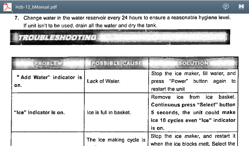

                  Read this... maybe help
                  http://www.hallikainen.org/hzb-12b/
                  Antarctic Star HZB-12B Portable Automatic Ice Maker Repair

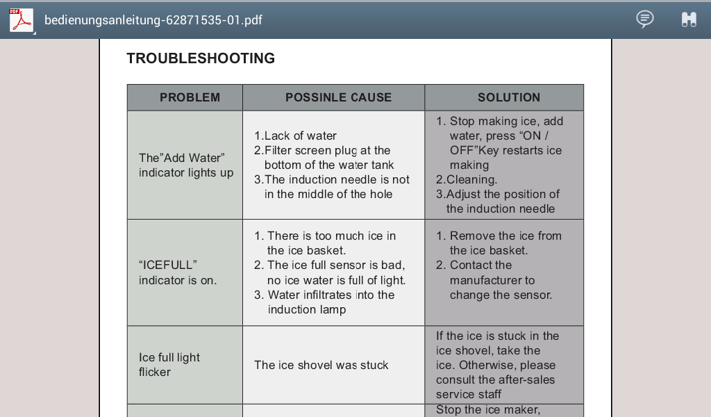

                  On attach are some troubleshooting from device manual but I dot understand wery well...
                    • The infrared sensor has an LED on one side of the area where the ice scoop pushes the ice into the ice basket and the sensor on the other. When the ice basket is full, the IR beam is interrupted. The system shuts down and the Ice Full LED lights. If the machine is in an area with a lot of sunlight, the IR sensor detects the sunlight and does not detect ice full. The system will keep making ice even when full. This could result in the ice making box getting jammed and parts breaking.
                    try looking for infrared light with a camera or shine light into receiver .
