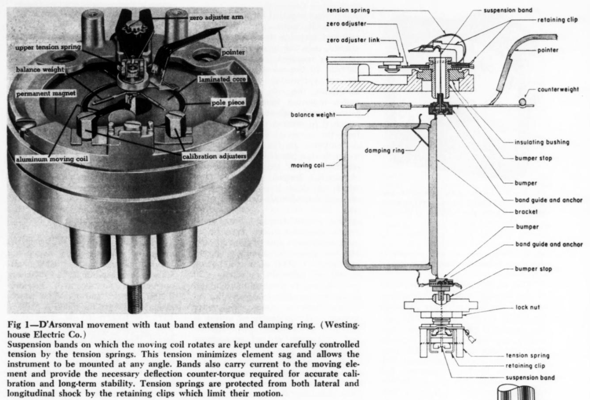

    I was wondering if it's possible/has anyone been able to wear out the bearings of a mechanical meter purely by using it?
    I suspect that connecting an AC voltage to a DC meter will vibrate it fast but does not do much movement, but what about a 1Hz source or something like that, would it cause enough wear over time to cause a D'Arsonval movement to wear out and break/become inaccurate?
  • redwire
    • Dec 2010
    • 3910
    Re: wearing out mechanical D'Arsonval movements?

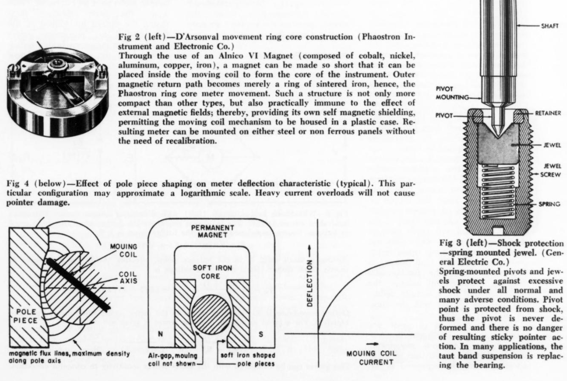

    There's many different types and quality for analog panel meters. I've never seen one really wear out, although I have one edge-wise from a trucker's CB radio that got sticky, I think damaged from vibration. It's a Taiwan cheap build.
    Better, older meters used sapphire jewel for the pivot but I think friction-less taut-band is used nowadays.
    "Conventional pivot-and-jewel meters often required bearing replacement after less than one million cycles."
    "... no movement deterioration was encountered on the taut-band meters after 50 million full-scale oscillations."
    "Particularly severe service conditions have demonstrated the stamina of the taut-band design in the field. One railroad reported that pivot-and-jewel ammeters on diesel locomotives required frequent repair, with overhaul and recalibration typically after eight months. Occasionally servicing was needed after only 30 days. Taut-band instruments in this same service for four years required calibration adjustment only twice, with no parts replacement."
    https://www.weschler.com/blog/the-ta...-analog-meter/
    If you have AC wiggling the needle, it gets smoothed out by the needle and mech mass as well as the shorted-turn damping on the moving coil. The meter's rectifier gives 2X freq. ripple so say 120Hz you can hear it.

        I think a panel meter's enemy is shock and vibration. The springs are coil like clock springs or taut-band and seem to not fatigue fail.
        In the old days, for shipping, you shorted a panel meter out with a piece of wire to prevent the needle from banging around, block generator-action.
        The slow meters seem to have heavier mech to dampen out noisy signals. There is a counter-weight as well. It depends on the meter's sensitivity as lower FSD say 100uA movements are wimpy compared to say 1mA which have more torque.
