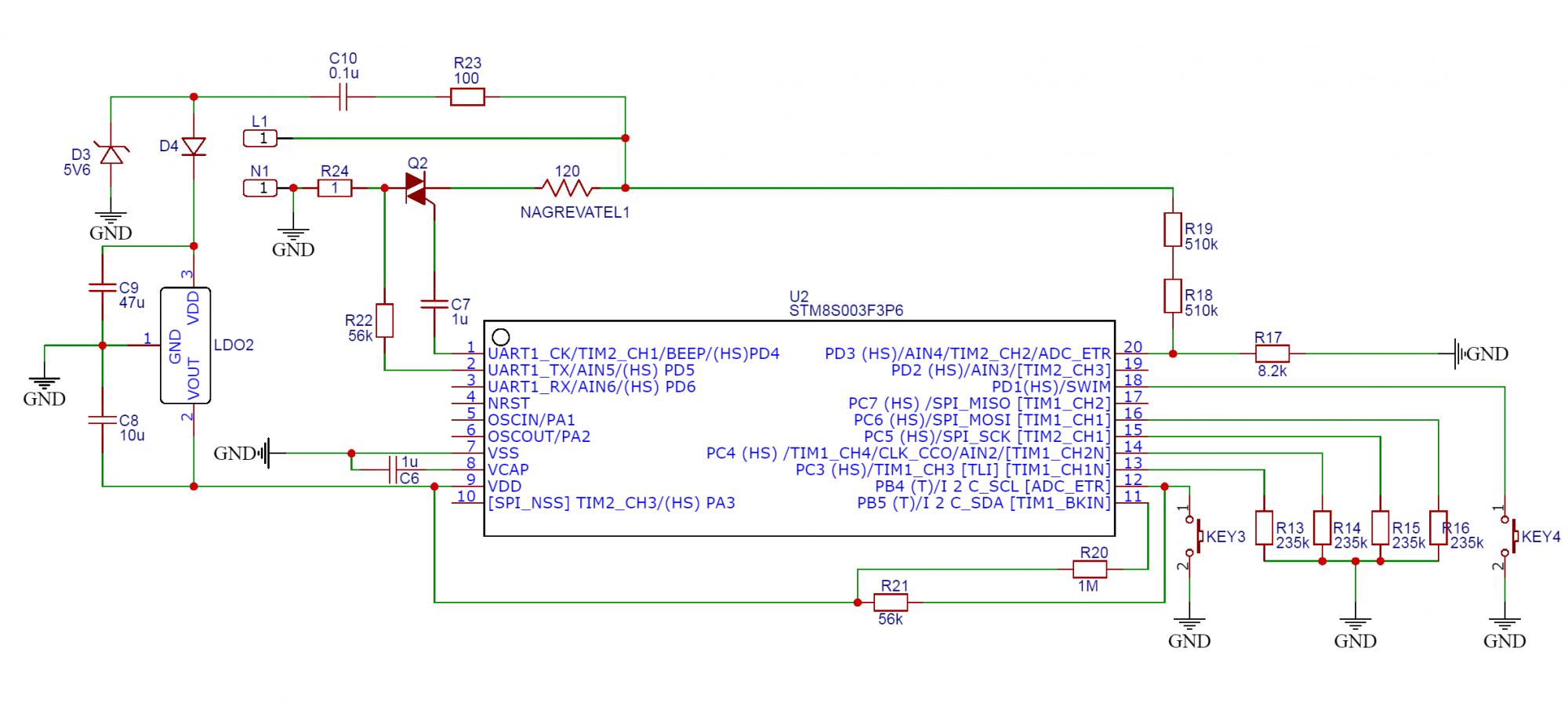

      Re: Schematics for JCD 908S adjustable soldering iron
      schematic
        Hi Lisa, thank you for this diagram, however, it's not the complete circuit,
        I also need the part that shows where the MCU's Vss pin is connected, as well as to which pin of the MCU the triac's gate is connected.
        In fact, I've followed some of the traces, and the only possible ones for the gate are:
        pin 4 P2.0
        pin 6 P1.7 (connected through R4 56 k to the regulators's Vss pin)
        pin 11 P1.4 has PWM capability (PWM0_CH1)
        Other pins connect to the +/- buttons, the display, etc.
              The information I gave regarding pin 6 P1.7 was not accurate.
              pin 6 P1.7 (ADC_CH0) is connected to R4 (56K) to pin T1 of the triac (BT136) and to current sense resistor R1 (1 ohm). R1's other end is connected to (Neutral, Q1.Vss, let's call it GND). Q1 is a voltage regulator chip (XC6206P332, 3.3 V regulator).
              To be able to perform A/D conversions, and measure the voltage across R1, the MCU's Vss (pin 7) should be connected to ground. This connection is gone on my board, I will fix it.
              Another melted connection is between the triac's gate and, I guess, MCU.P1.4 (pin 11) because it has PWM capability (PWM0_CH1). The other left pin on the MCU is P2.0 (pin 4) (nReset), so I guess it's not the one used to PWM the gate of the triac.
              I will try to fix these issues when I have time and post an update here.
              By the way, the output of the regulator Q1.Vout (pin 2) is monitored using MCU.P0.4 (pin 20) (ADC_CH5), and is also used to maintain the screen's pins 6, 7, 8, and 9 at 1.65 V using equal 470K resistors in resistor divider configurations between Q1.Vout (3.3 V) and Q1.Vss (GND).
                    Hello. My soldering iron began to greatly underestimate the temperature of the sting. For example, to warm up the sting to 250 degrees, I have to set the temperature to 480 degrees. Temperature correction does not work. It seems to me that the problem is in the firmware. Does anyone have a firmware for this soldering iron? Just in case, I attach a soldering iron circuit. The diagram does not show the display and its contacts.
                    P.S. I apologize for my English. I wrote with the help of a translator.
                        Visually, everything looks good.
                        The heater was tested in a similar soldering iron. He works fine with him.
                        The power supply voltage of the controller is 3.3 volts.
                        The resistors' resistances correspond to their nominal values.
                        Which sensor are you talking about? There is no temperature sensor in the soldering iron. When the heater is heated, its resistance increases. As a result, the voltage changes at the point between R24 and Q2. By measuring this voltage, the controller determines the temperature of the sting.
                          • 31113
                          i think pin2 on the mcu is for zero-volt detection.
                          your sense input is the voltage divider R17,R18 and R19 feeding pin20
                          • Pjatruha
                            • Aug 2023
                            • 7
                            • This is obvious
                            I think otherwise. The zero determinant is pin 20 of the chip. The chip determines the temperature on pin 2.
                            But I don't understand yet why you wrote this? How will this help me fix the soldering iron?
                              • 31113
                              because if any of the resistors have changed in value it will read the element wrong
                                I agree with you, but I wrote above that all resistors correspond to their nominal values.
                                  • 31113
                                  all thats left is Q2 having some type of resistance inside or bad mcu or maybe c7 being bad so Q2 is not turning on/off fully?
