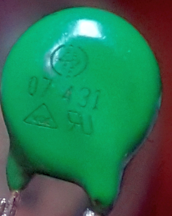

    Need help identifying component.
    It has markings 07 431 VDE

    Re: Help identify varistor
    probably a 430v VDR - is it 7mm diameter?
      around 7mm yes
      looking for replacement.
      I have SCK 053 as spare or it is not VDR.
        Originally posted by otoluk
        around 7mm yes
        SCK-053 is a thermistor (these are completely different components).
          So this is not inrush current limiter?
          How to verify if it is not bad?
            VDR is a varistor (has no resistance) placed in parallel with the power supply (AC or DC)
            SCK is a thermistor (has a resistance) placed in the gap (as a current limiter) of the power supply.
              Double checked yes it is parallel to AC.
                So what's the problem, it (VDR) usually explodes if the voltage has passed more than its nominal value.

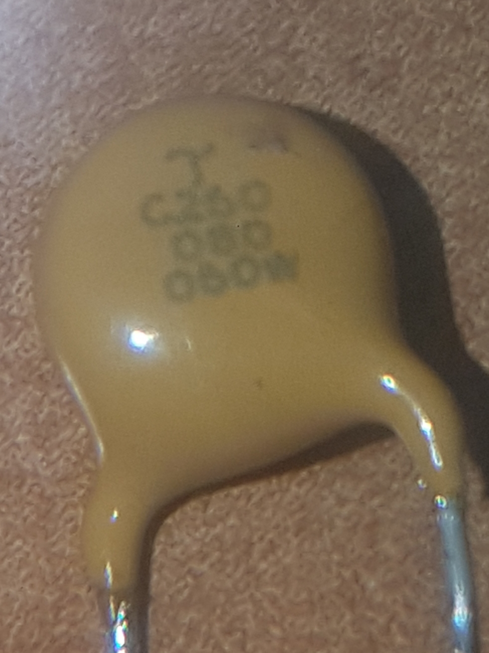

                    This is fuse?
                    C250 080 030W
                    measured resistance 19k Ohm
                      A fuse cannot have a resistance of 19 kOhm. What is the position number on the board (designation)? And on the other side there is no inscription?
                        This seems to be resettable fuse - https://en.wikipedia.org/wiki/Resettable_fuse
                        Position number on board F6 and other side is blank.
                          Well, if F, then yes it's a fuse, but it's strange that he's so pot-bellied. At 250v 800mA?
                            It is from Galmet wood pellet boiler controller.
                            Apparently it was left switched on all summer in tripped state. When it trips the LED backlight is not visible so looks switched off. Wood pellet boilers this year are very popular in our region.
                              Well, then you need to replace it, put the usual one on 1A, to check the block
                                Isn't it 0.08A?
                                  I can’t say for sure (I need a datasheet) somewhere they write 080 - 80mA, but somewhere it’s 800mA.
                                    Found manufacturer with similar symbol - https://www.made-in-china.com/showro...able-Fuse.html
                                      It seems to be 250V 80mA hold, 160mA trip PTC fuse, 6.5mm dia. Sea & Land Electronic corp. C250-080
                                      There is something else shorted for this PTC fuse to heat up and die. I would look for a problem in the power supply section.
                                        Thanks.
                                        The previous converter failed so maybe took this on the way.
