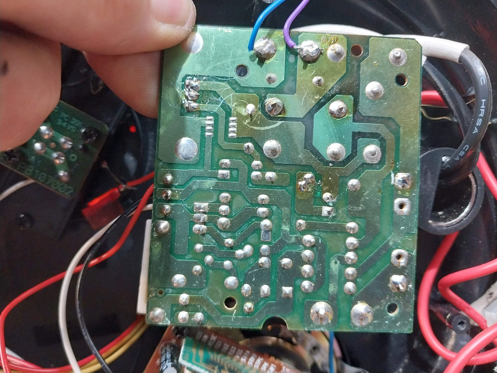

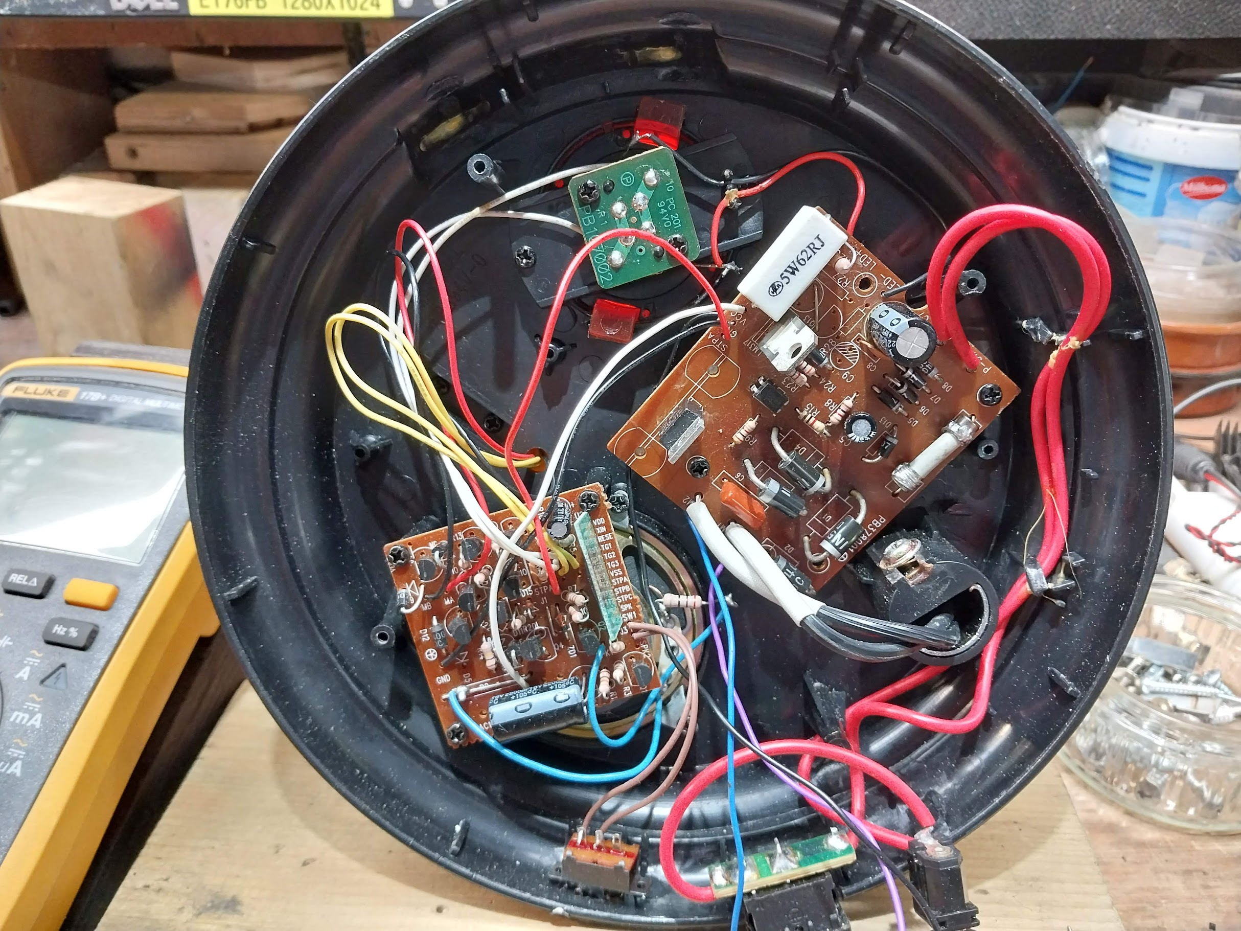

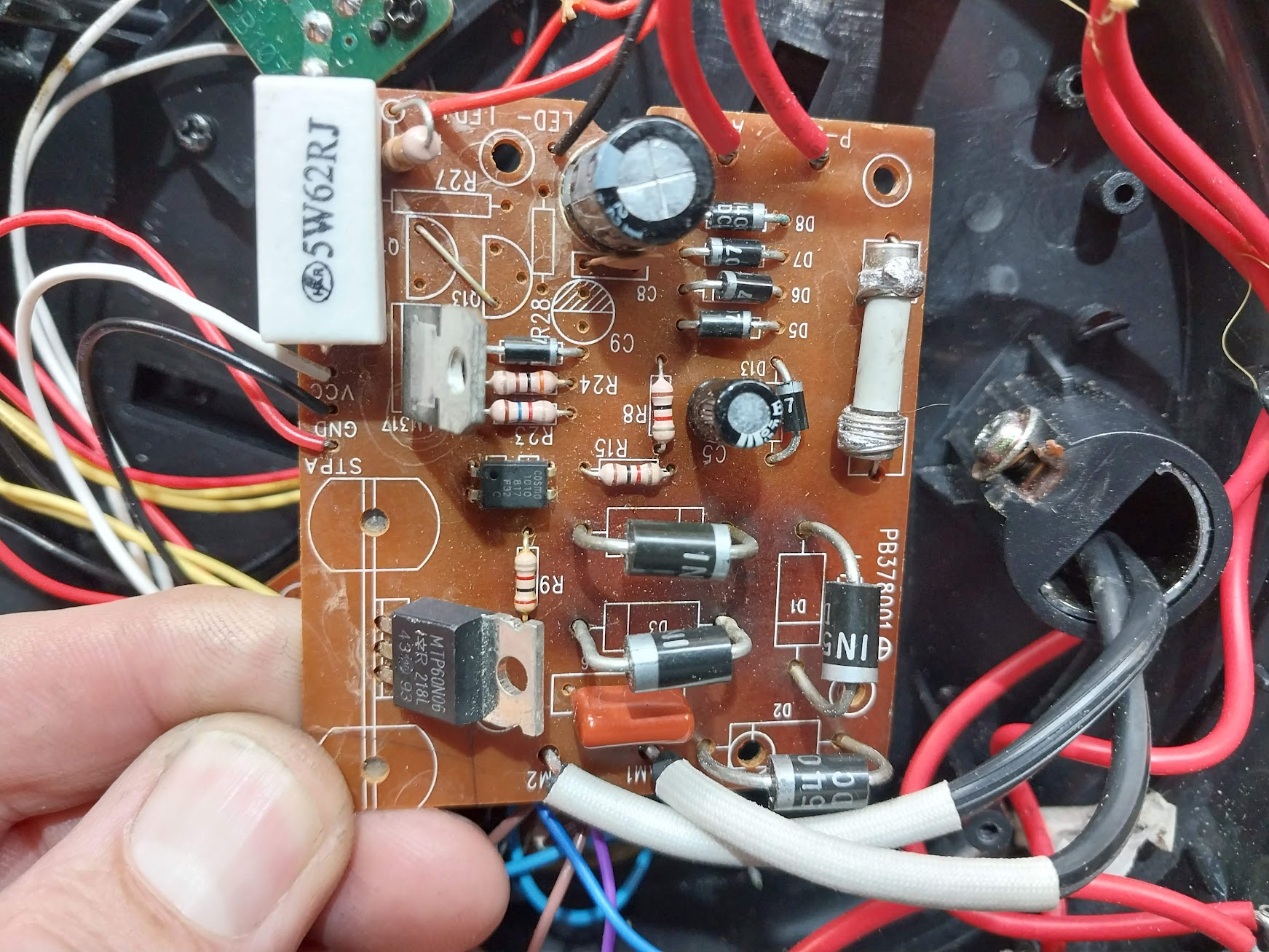

    Hi All,
    I am working on a Mickey Mouse novelty table light which is powered by an external 24V 3A AC supply.
    It was DOA and when I opened it I could see evidence of heat around the larger bridge rectifier consisting of 4x 1N5404 diodes. The internal 5A fuse had blown as had one of the diodes.
    I replaced the diode and the fuse which brought it back to life with the exception of the 24V DC supplied lamp which is switched with a MTP60N06 N-channel MOSFET via an opto-isolator.
    When the light switch (single contact button) is operated the lamp makes an appropriate sound and a motor powered animation takes place. At the same time +5V is fed via a red wire (STPA) to the opto which in turn is connected to the MFET. I have tested the opto & MOSF off the board and test OK.
    I have also tested all the other components on the PS board: LM317 (7.96Vo/p), diodes, electrolytic, resistors but cannot get the lamp to switch on..
    There are 2 boards: one with the power supply, LM317 and the MFET. The second board has the animation & sound control, etc.

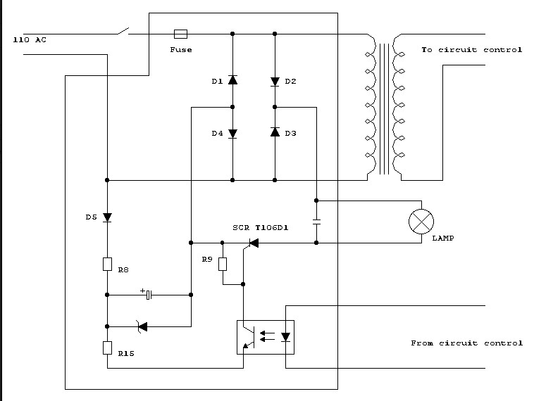

    The attached schematic is from a version of the light that has the mains transformer built in and a SCR for the lamp control.

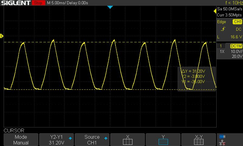

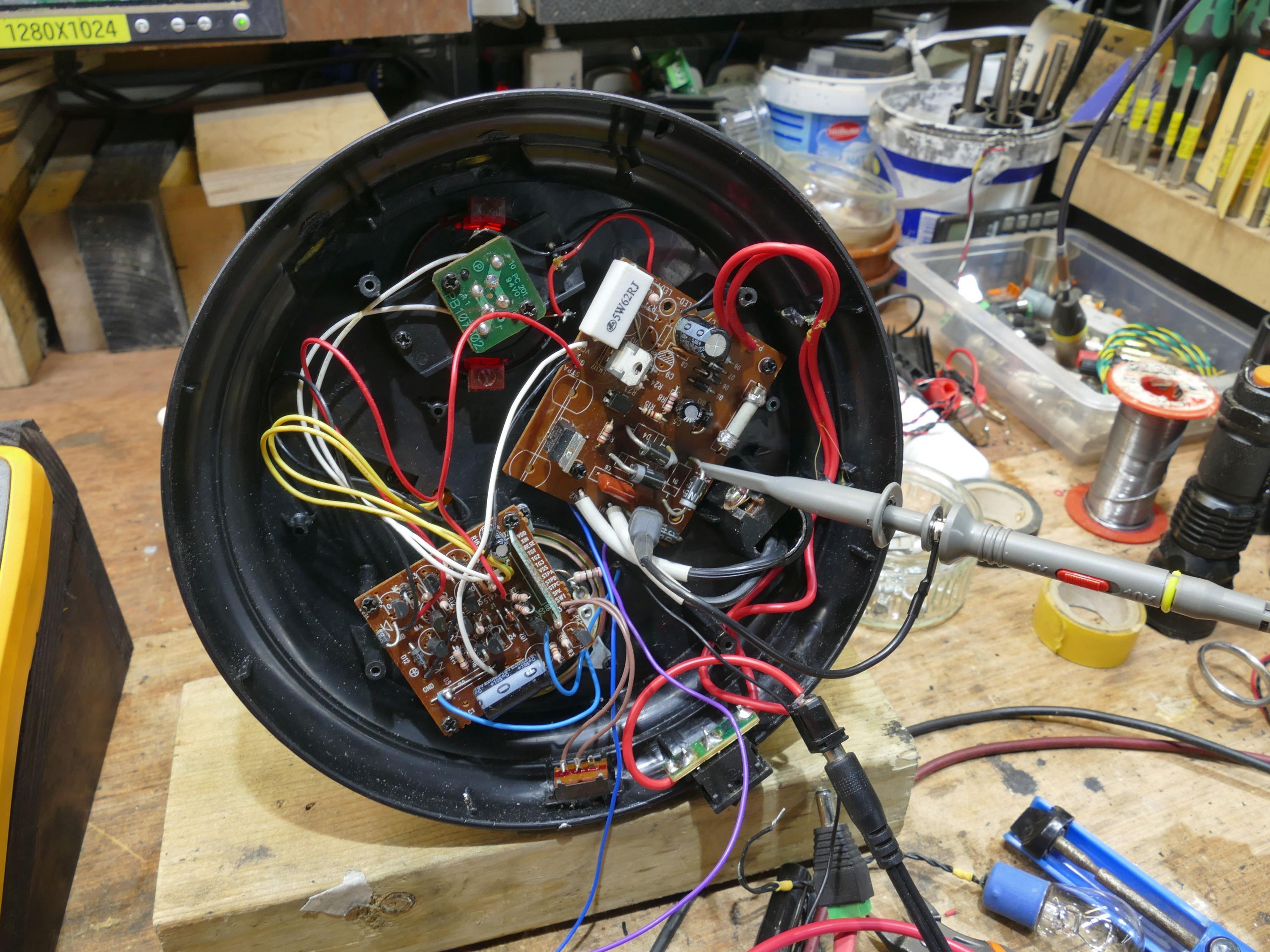

        Hi Both,
        I'm using a Fluke 187 and a Siglent Scope.
        Measuring between D1A to D2K I measure the following:
        25.95V DC
        2.64V AC
        And here is the scope trace between the same points
        (probe end on D1A & earth end on D2K)
        The 5W ceramic resistor is good as is the ugly looking fuse bodge.

                Re: MOSFET controlled table light help please
                I have resoldered the black wire connecting the power board to the control board.
                I think I have added some confusion to the thread by posting the schematic above.
                The circuit I have does not have a SCR but instead a N-ch MOSFET.
                I do not have the correct 24V/50W lamp so have joined some power resistors together that total 14.4Ω with a parallel LED & series resistor to indicate the lamp has turned the bulb on.
                When the light is switched 'on' the red wire feeds the opto-isolator anode (+4.85V) with the cathode connected to ground.
                On the other side of the opto, the emitter is connected to the gate of the MOSF, the collector is connected to R15.
                The MOSF connections are:
                Gate - connected to the emitter of the opto
                Drain - connected to the lamp
                Source - connected to ground
                If i short the drain & source the lamp (resistor load) turns on.
                If I short the Col-Emit of the opto the lamp lights (which I guess means the MFET is OK?)
