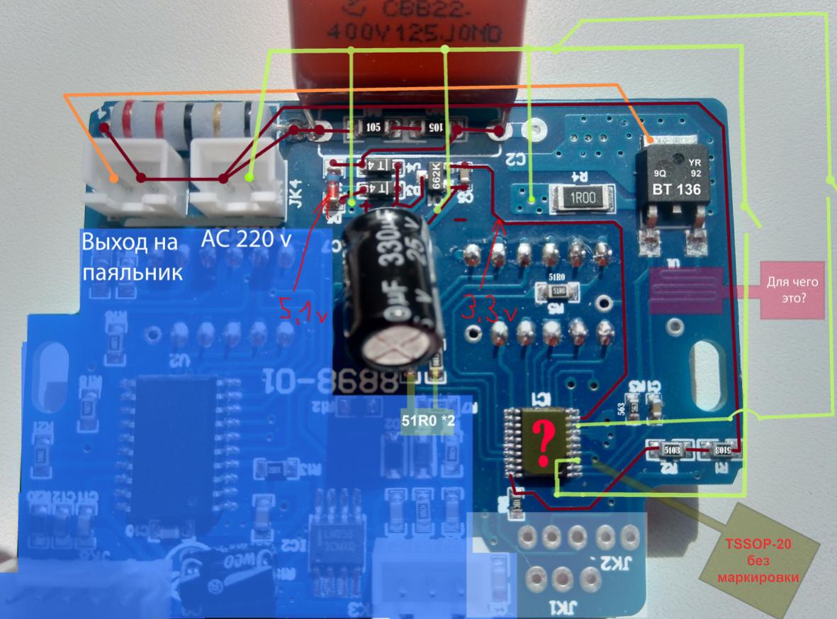

    I have a JCD 8898 has a faulty zener diode ,I'm looking for a replacement zener voltage rating.

    Does the zener have any marking on it?

        It's a glass zener diode with a single blue line

          The blue ring only states it is a zener diode, but does not give a value.
          I could not find a schematic, so you may need to trace out the circuit to try and figure out what the zener does in the circuit

              It's a strange soldering station - super cheap at ~$30 and the SMPS power supply looks so small.
              MELF diode D5 looks like part of a capacitive dropper arrangement for the top MCU board power. It's just strange that isn't powered by the lower board SMPS and it seems to use a triac for the soldering iron heater (as well as the hot air), which is odd/ The heaters must be all mains powered?
              Without clear pictures or a schematic, there's no way to guess the zener's voltage or to figure out the power system.
              I would suspect the dropper capacitor failing low value before the zener.

                The zener diode there is at 5.1v, it goes to the XC6206P332MR (3.3v, 662K sot23), and it powers the MS51FB9AE - Nuvoton controller.

                      I resurrect this topic to ask if original poster (or anyone else) managed to fix the rework station.
                      Mine suddenly stopped displaying in solder iron display and it would not go hot. Hot air display operates as before as well as the air gun.
                      Zener diode D5 was shorted but replacing it with a PH C5V1 to no avail. Now there is a voltage drop of 0.7V.
                      I tested all the marked path in the photo above with continuity and they are ok. I cannot find anything else shorted or burnt. All resistors measure within specifications.
                      Any ideas? Can it be the heating element in the solder iron? Can anyone who has the device confirm that by removing the solder iron from the central unit the display stays on?
