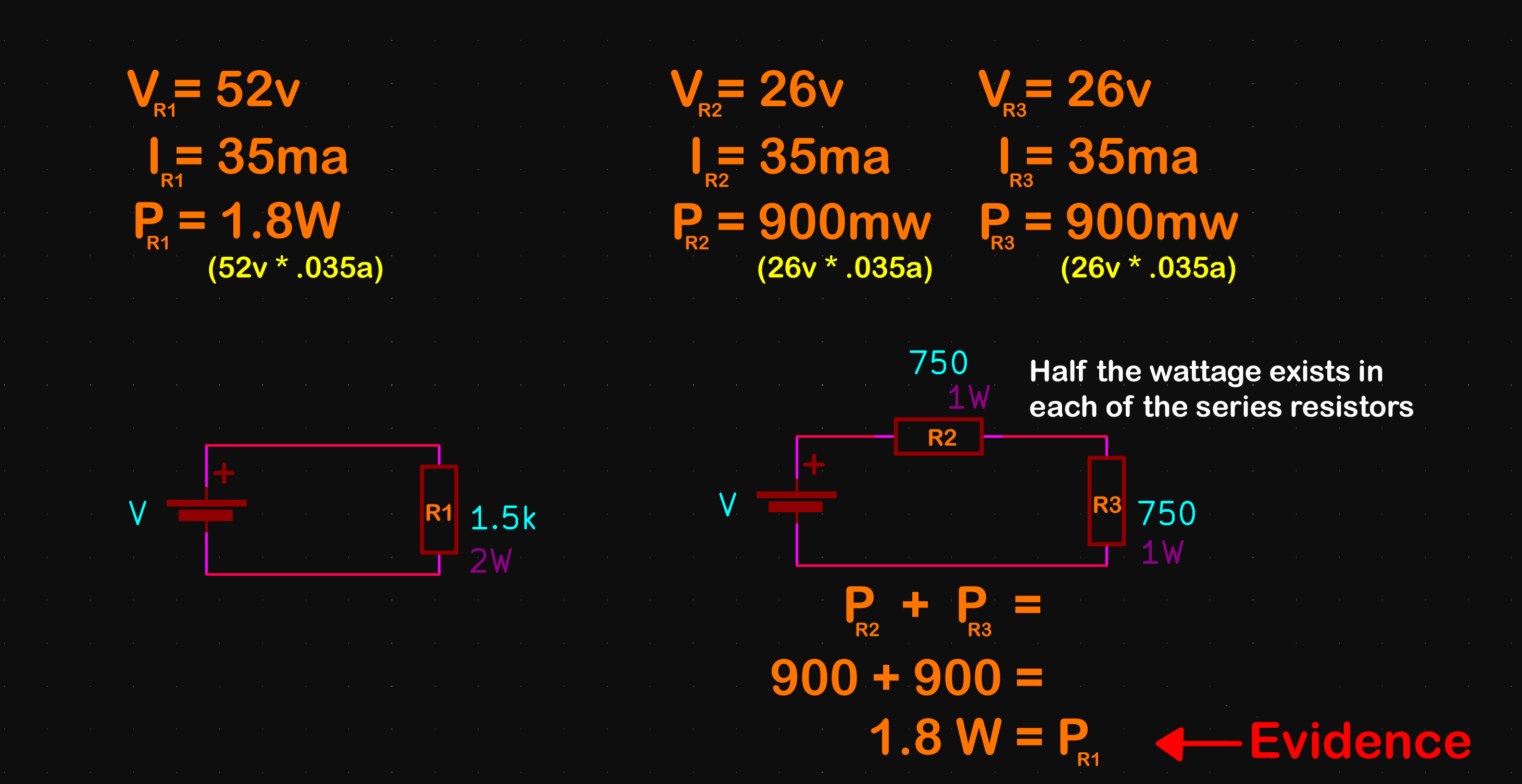

    resistors in parallel ?
    I need a 1.5 k 2watt resistor , can I use 2 1 watt resistors in parallel for testing purposes while waiting for a 2 watt to arrive?

    Re: resistors in parallel ?
    You can use two 3k ohm resistor @ 1 watt in parallel to get 1.5k @ 2 watt that you are looking for
      And two 750Ω 1W resistors in series would also result in a 1.5KΩ 2W resistance.
        Are you sure about this because I thought that if one was 1 watt total because it would just add more resistance but I could be wrong
          Do the math.
          BTW, should always do the math. You can even do funny things with nonmatching resistors but yeah it gets complicated when they don't match as the power dissipated will be different if resistances are different.
            The heat to be dissipated would be shared over two parts, each one dissipates a ratio of the value a single part would. Regardless of whether the two are in series or parallel.
            50-50 split so 1W each using two 750Ω series or 3kΩ parts parallel.
            If you used a 2.2kΩ and 4.7kΩ in parallel, each see about 1.36W and 0.64W - the same ratio as their resistances.
                Do the math.
                Here's the math if anyone is interested or ever will be interested ...
                What I find particularly interesting about this thought exercise, is that like sam, my knee-jerk reaction to the statement was to pause and question it. And I think that is because we are used to thinking about net values - where resistors are concerned anyways - differently depending on whether the resistors are in series or parallel ... so I think naturally the brain wants to continue that pattern of thought even if the value in question is wattage dissipation. Which as it turns out, does not care if the resistors are in series or parallel, wattage dissipation adds up linearly.
