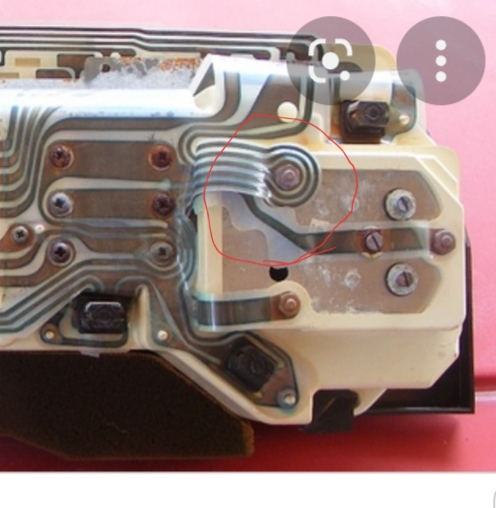

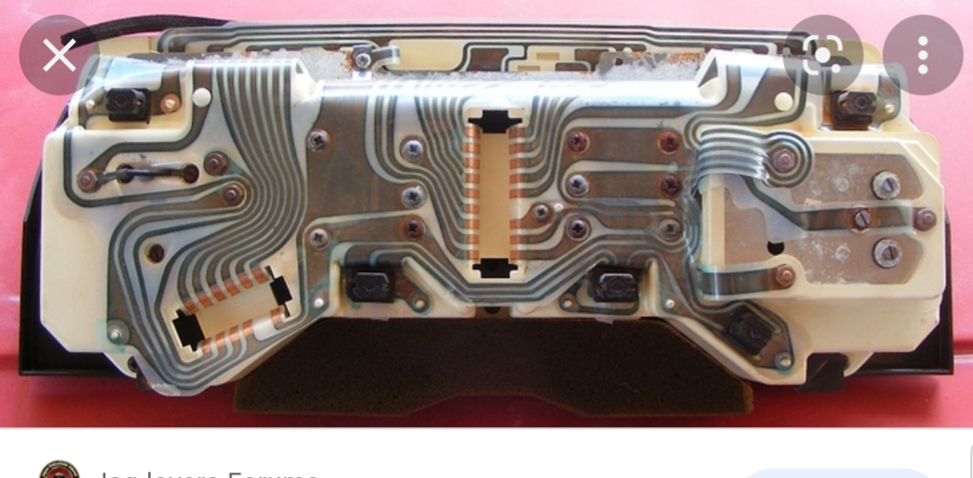

    Hello All.
    I posted this in the computer and laptop area first, and if that was a mistake, I apologize...
    I'm working on the printed flex circuit board (flexible type) of a 1990 Jaguar XJS Instrument cluster. If you Google that you'll be able to get a general idea.
    In areas, the plastic has come apart allowing the copper strip to kinda flop around and be exposed to the elements.
    What can I use to glue the 2 faces of the plastic material together trapping the copper ribbon inside...
    Again - thank you all for you help. This will be the 4th or 5th time now that I have come here to receive AMAZING advise and directions. Thanks so much!

      Sam, Sam, Sam... Thank for the amazing reply, and for taking the time. Sorry for the delayed response.
      Ohhhhhh, this cluster. I'll try to touch on your points.
      First I'll say, all gauges work LESS the speedometer.
      Like a dummy, I posted a photo of a cluster I found on line. Not my cluster. But I can. I created the post at work just to give folks a sense of what I was looking at - especially the particular type of ribbon. I've seen some ribbons that are near microscopic, this one ain't. The traces are almost huge - but ratty. The clusters, almost from new, in the Jaguar XJS, caused problems and as far as I can tell, for the 1990, there is no replacement. Salvaging what's left of them is all one can do.
      In the photo, if you look to the right hand side, there are three contacts that (if you can imagine or Google the face of the cluster) that serve the speedometer. Signal, ground and B+. The upper one (B+), with it's contact in the circular center, surrounded by 4 other traces, has completely opened up, allowing the center trace to become completely detached from the plastic support. The other four remain adhered, but exposed on one side due to the two plastic faces peeling away from each other.
      I'm my tinkering, I have used green scotch bright to carefully clean pressure type contacts (plugs etc). I have sanded, with 600grit, the face side of all the nutts and most of the screws. Like you said, I've éven bent up/out the contacts on the plugs and gave them a good rubbing. Added a redundant ground to the whole thing. And am thinking about replacing SOME of the smaller bulbs with LEDs (polarity?), definitely all of the larger. Anywho. I've been trying with this thing.
      My main issue is the speedometer. It has never worked. No one is clear (XJS forum) on weather it is driven by a varying voltage at the speedometer dial OR a pulsing voltage.
      Basically, there is a sensor in the differential, picks up 6 pulses per rotation,,, that signal goes to a module that reads this and translates it for a fuel info sender, the trip computer, the cruise control and YUP, the speedometer. All work but the cruise and the speedometer... If you'd be willing to follow along with me as my guide in this I would be eternally grateful, and happy to supply some supporting documents, take some readings and report, and whatever you ask me for. I WOULD BE super appreciative in that. Jus say'n.
      I have some E6000 on the way as my GLUE to deal with the flex board,,, unless you say that it's not the right thing. I was going to put it back together and hope for the BEST with the speedometer,,, go without one if not.
