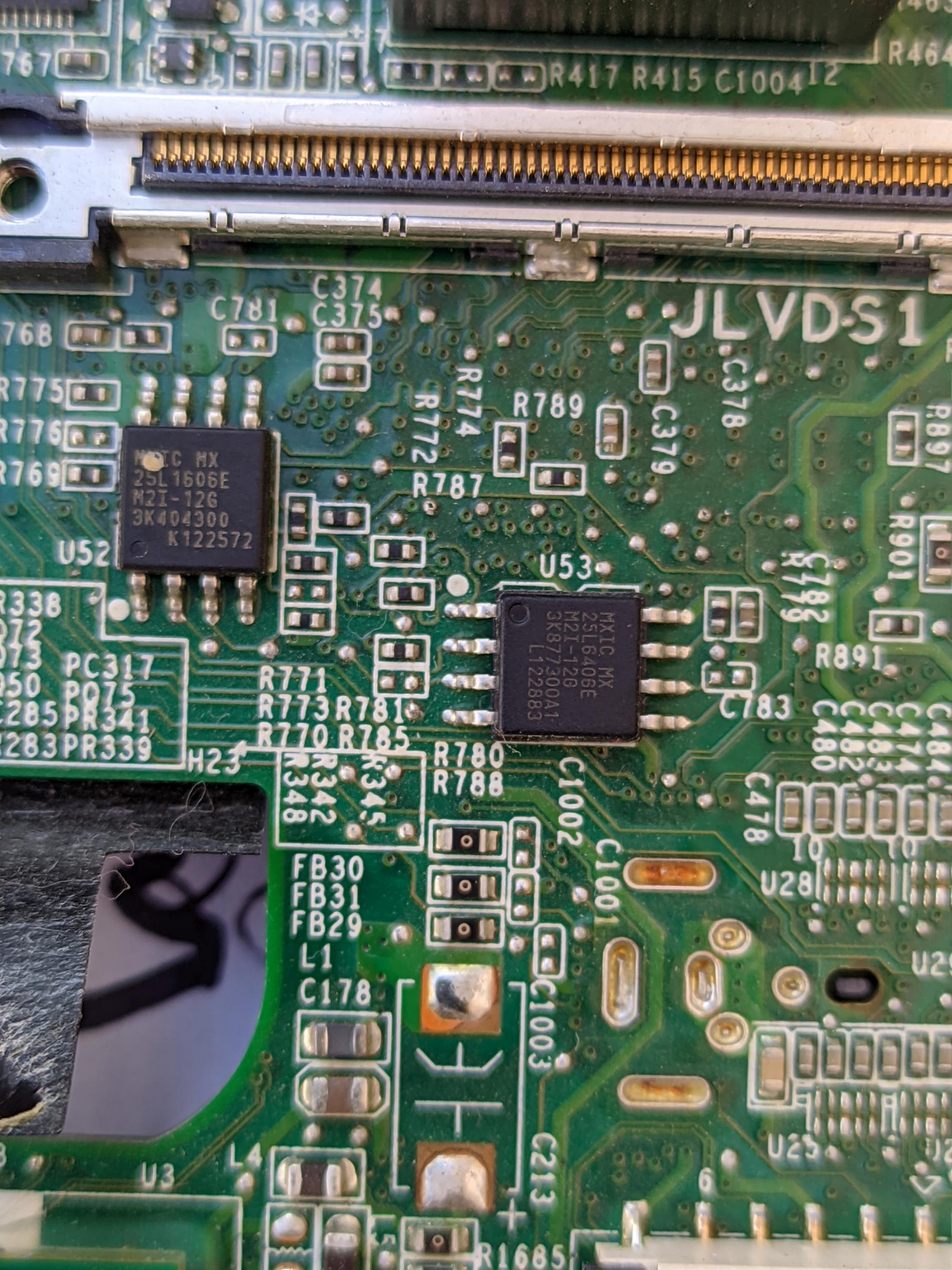

    am thinking of getting an adapter sop8 to dip8 to this bios chips
    MX25L1606E
    MX25L6406E

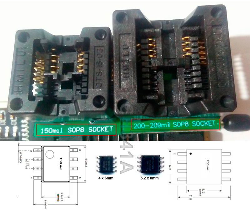

    adapter ask if 150 ml or 200 ml.??
    could not find it.

    It will be the best idea to see an actual pic of the flash device you wish to program.
    The adapters referenced in your post are very low cost, consider to source one of each and you will be covered.

      probably 200, but check your datasheets
      or by both adapters like i did - they are cheap
      https://www.aliexpress.com/item/32992825756.html
      https://www.aliexpress.com/item/32994770149.html

        bios chip on laptop.
        you can see the connector for the laptop screen on top.

          takes months to arrive. i can get them for about 15 shipped. in like 5 days.

            those look 200 in the photo
