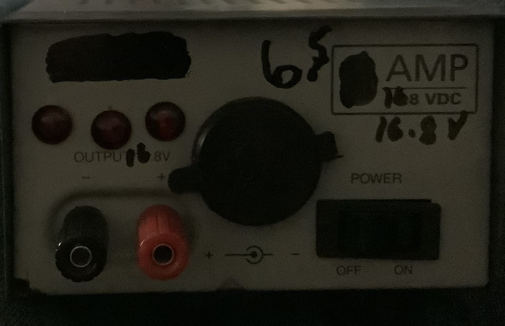

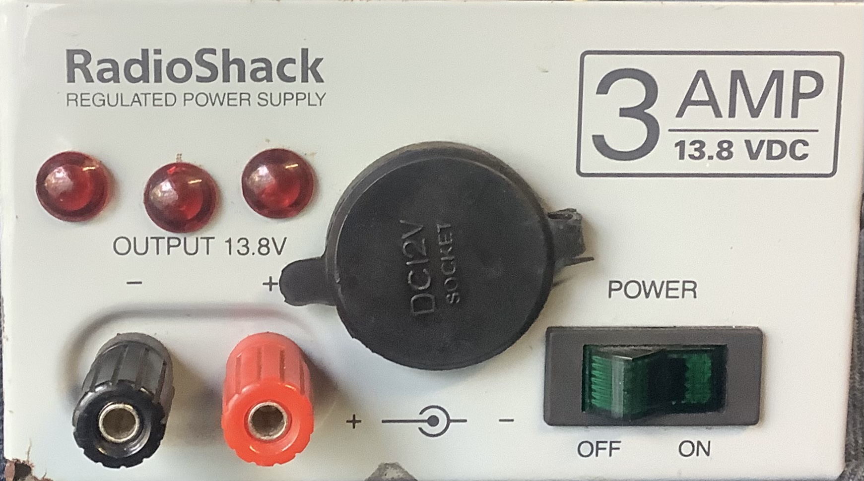

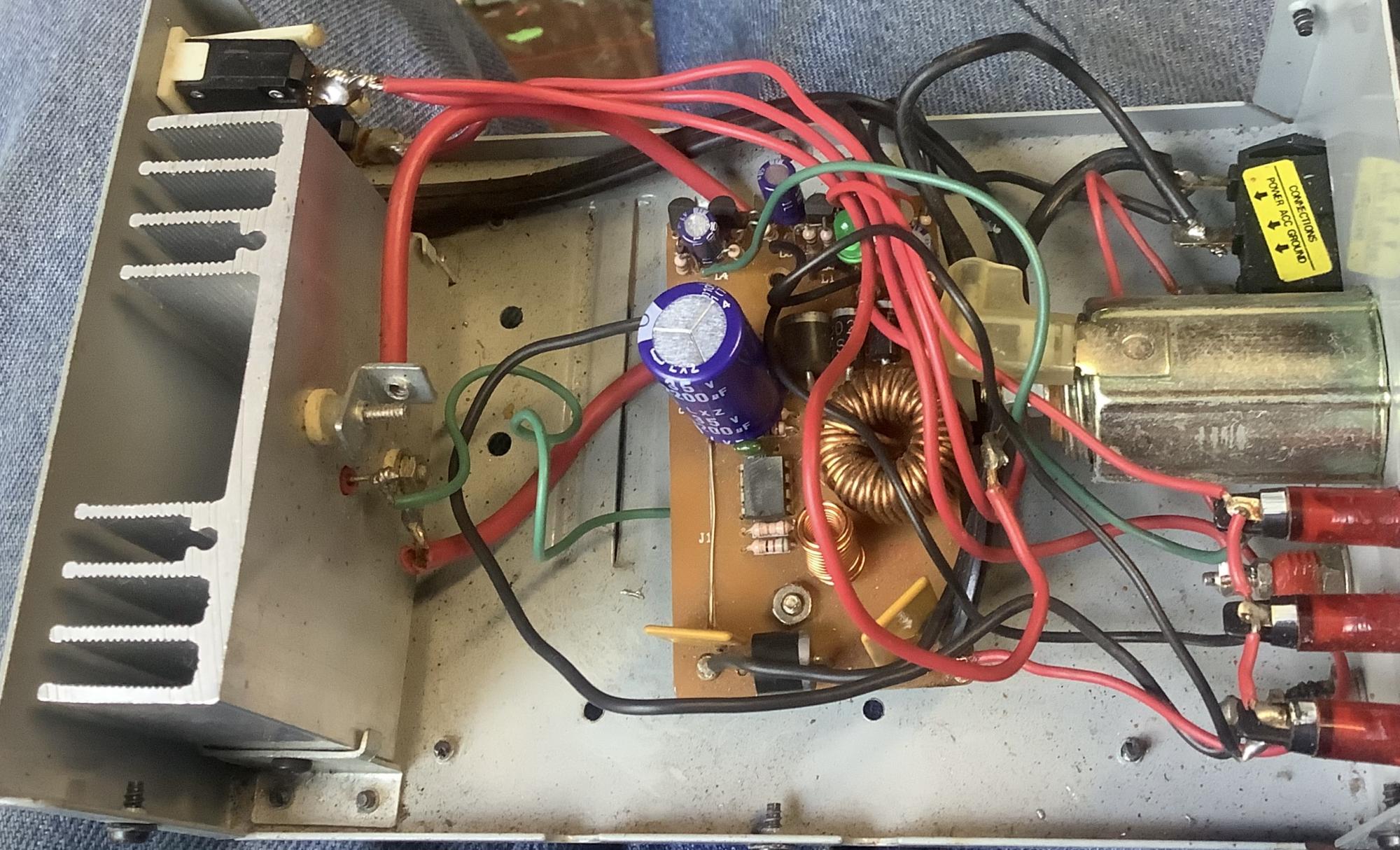

    I had bought this device many years ago and never really used it much because I never had batteries that were good enough to use this device on because it draw up to 10 amps and would drain a battery very quickly so I have made a battery pack for this device now ( and for inverter that I also have ) but I still have to buy a 10 amp circuit breaker for it for it be completely safe to use it
    The reason why this device end up in a Radio Shack power supply case was the transistor small heat sink would get very hot to touch after a very short time and I had these power supply that I bought when they were being closed out and had a newer version of it which I did not think much of so I bought as many as I could back then I still use one of and to power small devices every so often
    This device did get recapped because it had been in storage for a very long time and because it had non brand name capacitors on it
    The output is 16.75 volts with no load on it and with a one amp it still maintains a 16.75 voltage ( incandescent light bulb load interesting results ) I put this device on a 12 volt li-ion battery pack that was discharged 9.75 volts but could not keep it working because I only have a 2.5 amp circuit breaker on it right now it was showing over 6 amp going to the battery pack
    After I do some testing I might end up putting a 12 volt temperature controlled cooling fan over the heat sink to cool it

                Well this project is done for the boost converter for jumping a car battery
                I replace the 2.5 circuit breaker for a 7 amp circuit breaker and now it does not trip out
                I ran it for about 5 minutes and the heat sink got warm and transistor got real hot but not hot enough that I could not keep my finger on
                To test this device I use a 18650 12 volt battery pack that was discharged to 9.35 volts and it got a little bit over 10 volts while charging it a 6.78 amps yeah I know that this is a little bit high but it has 9 battery cells in parallel so I was not to concerned about it because it has so many batteries in parallel and I was only doing for a short time
                Now I have have to build the 18650 battery pack for this project to be completely done
