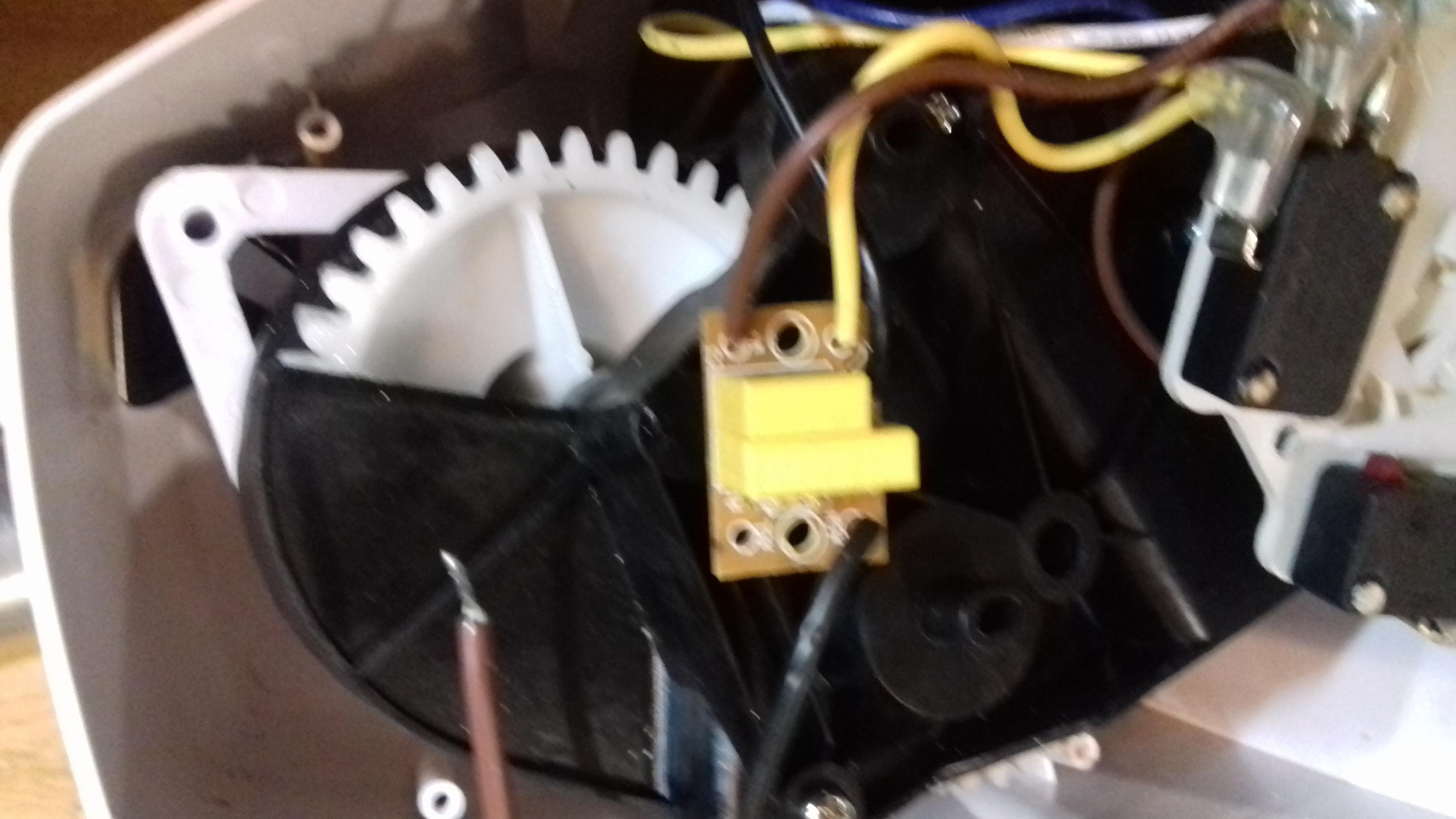

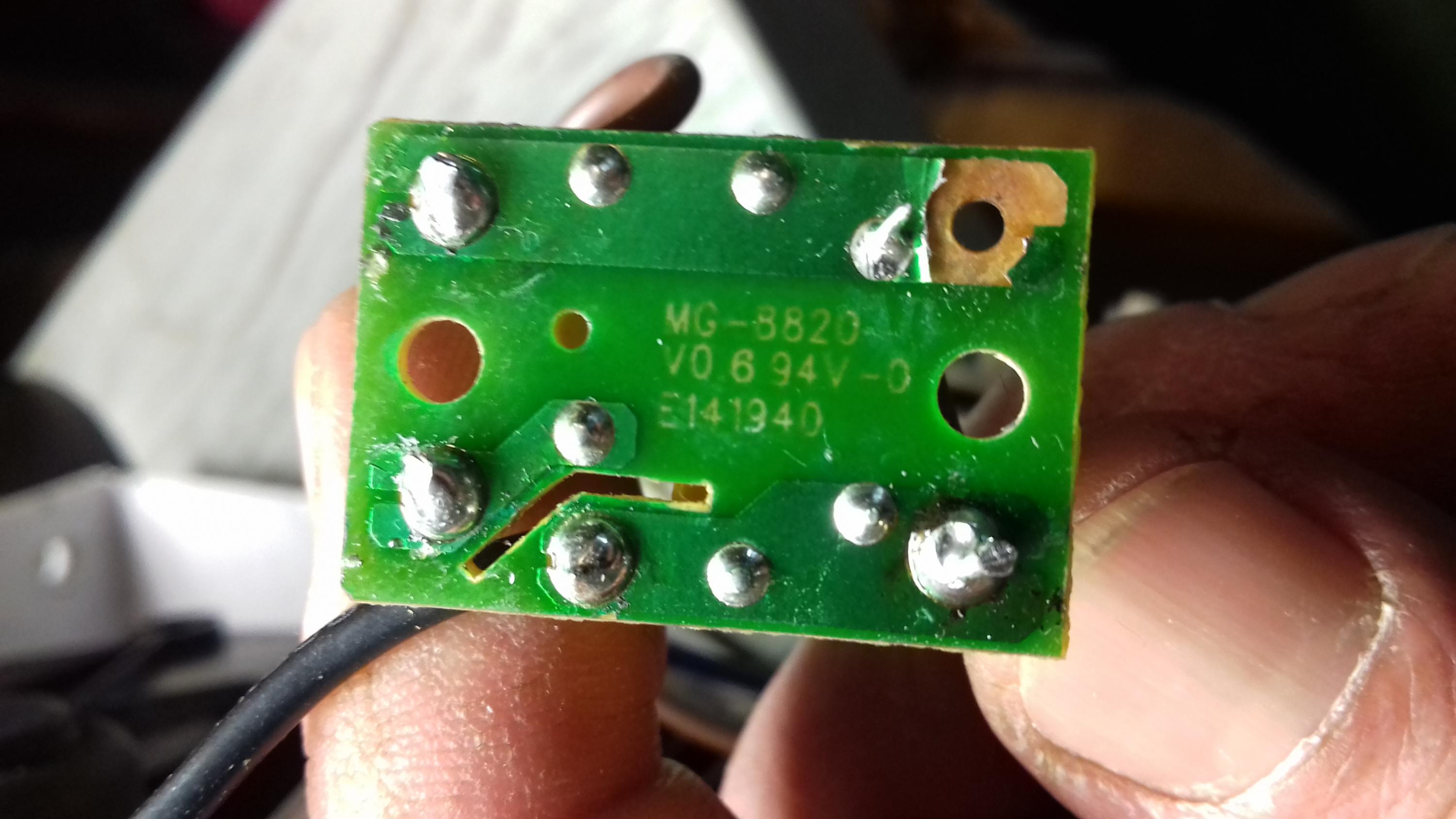

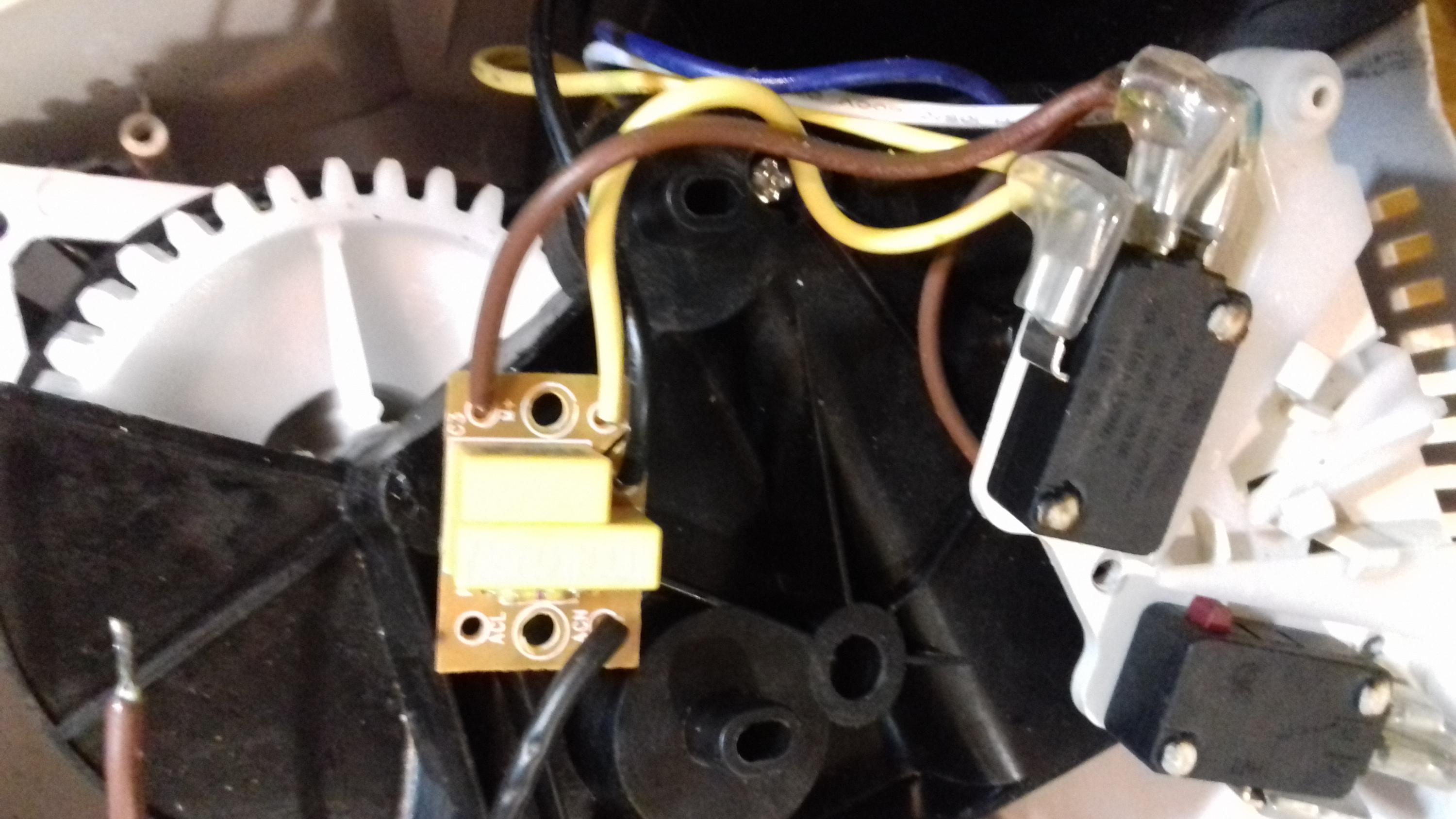

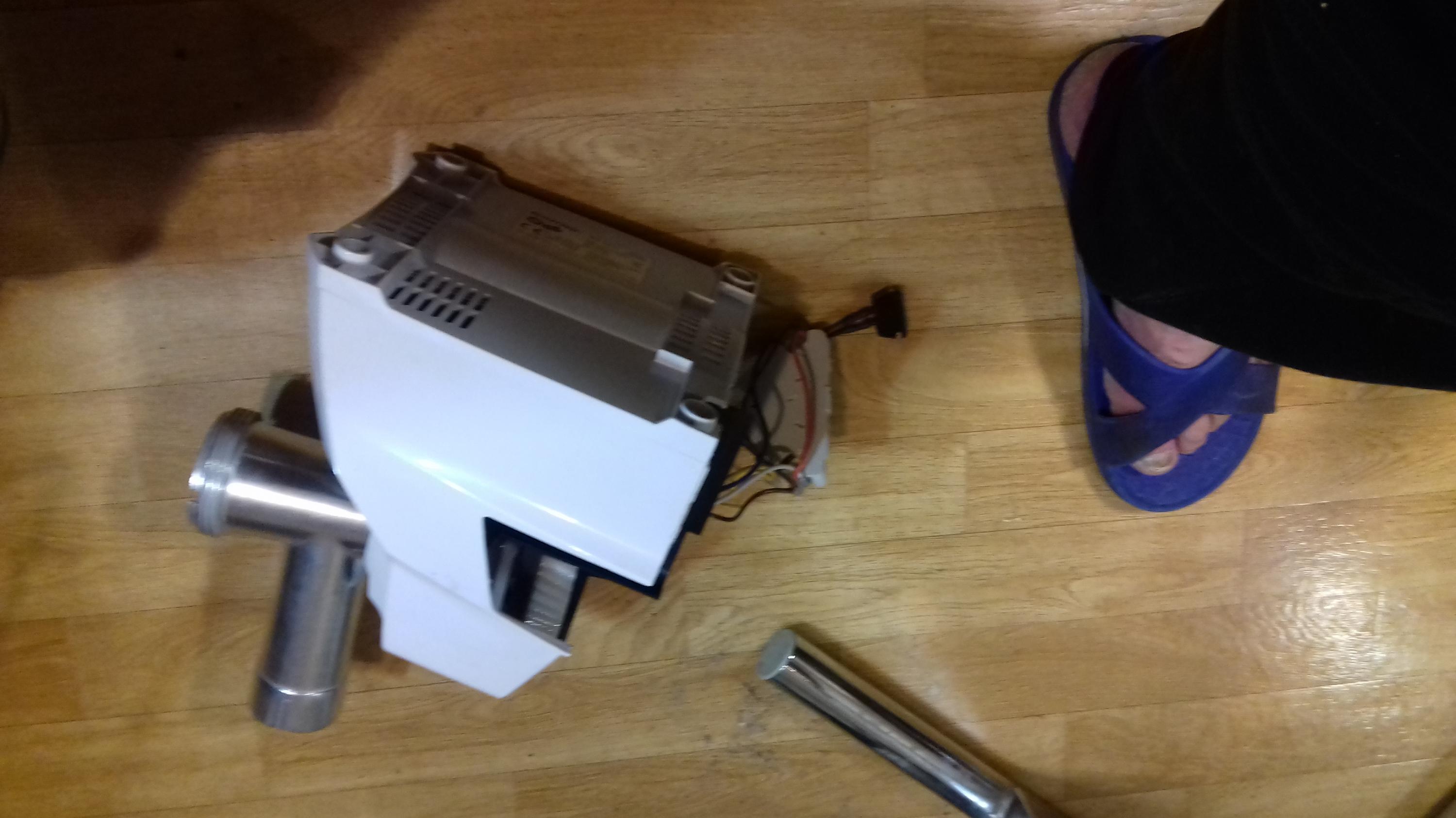

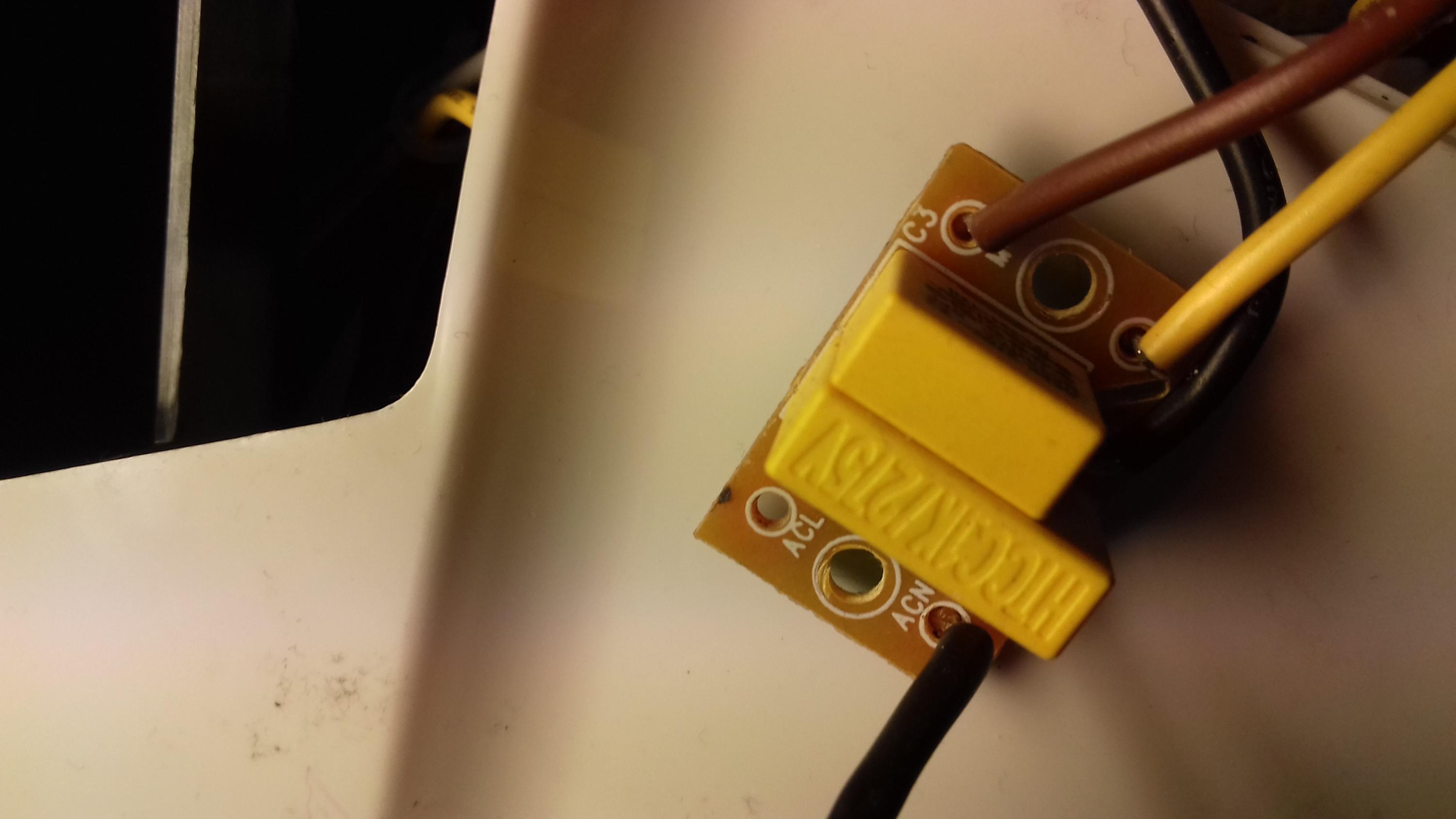

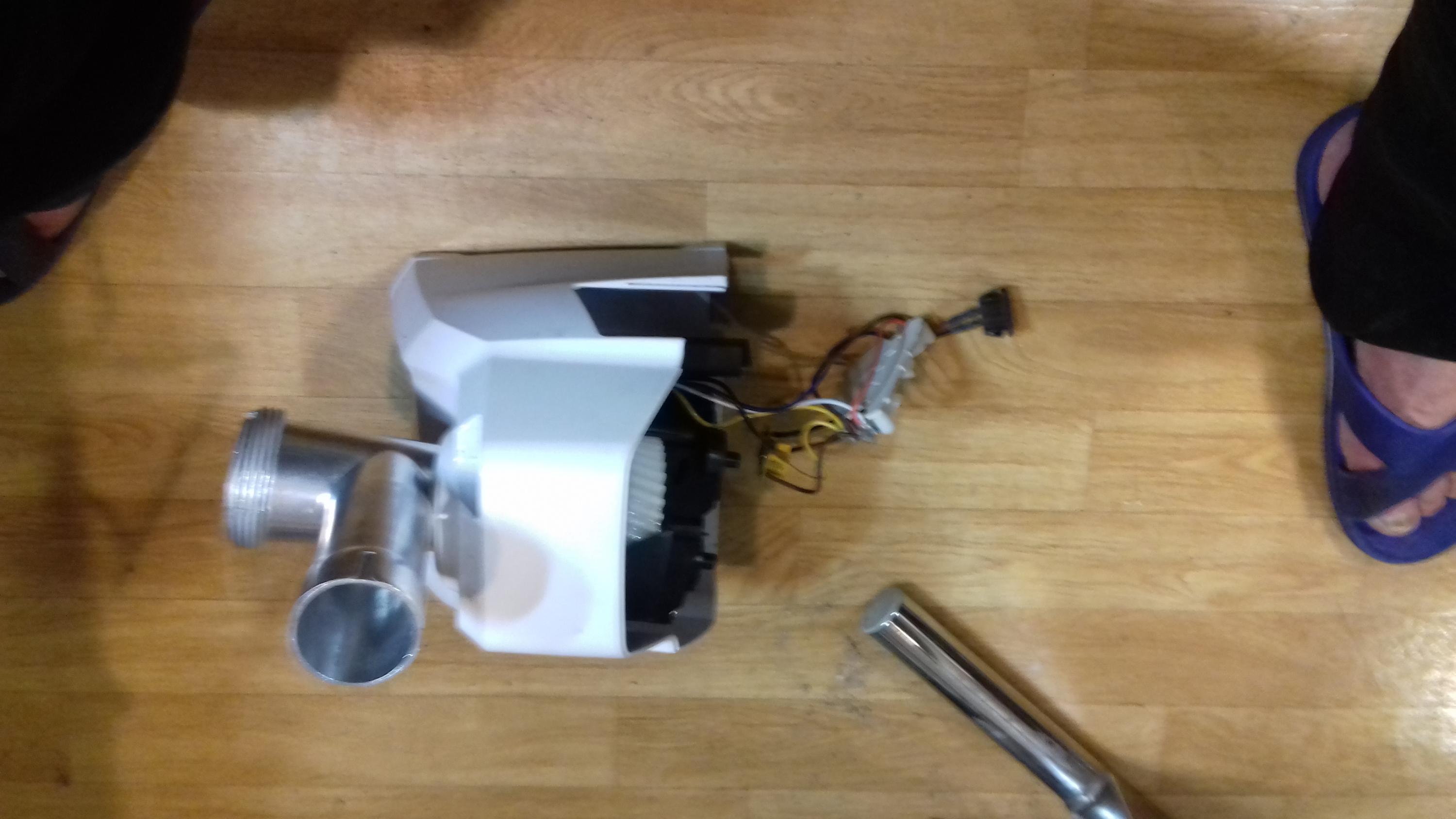

    Hi all this is a circuit from a cheap "SilverCrets" meat grinder soldering contact has dragged and is there anyone who can suggest where or how to attach the negative in this position

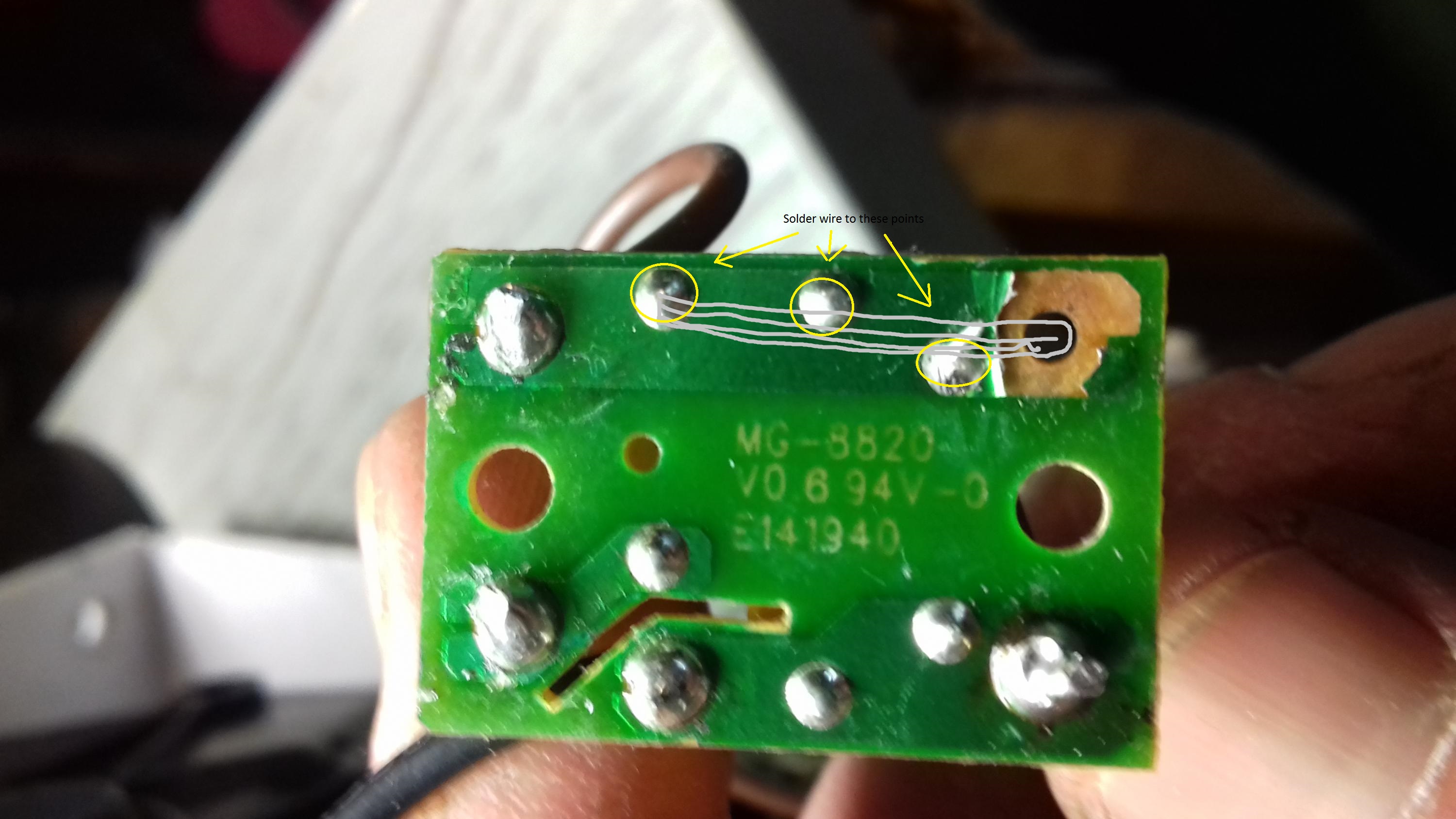

    just connect to same track ..scrape mask off and solder to it

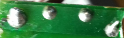

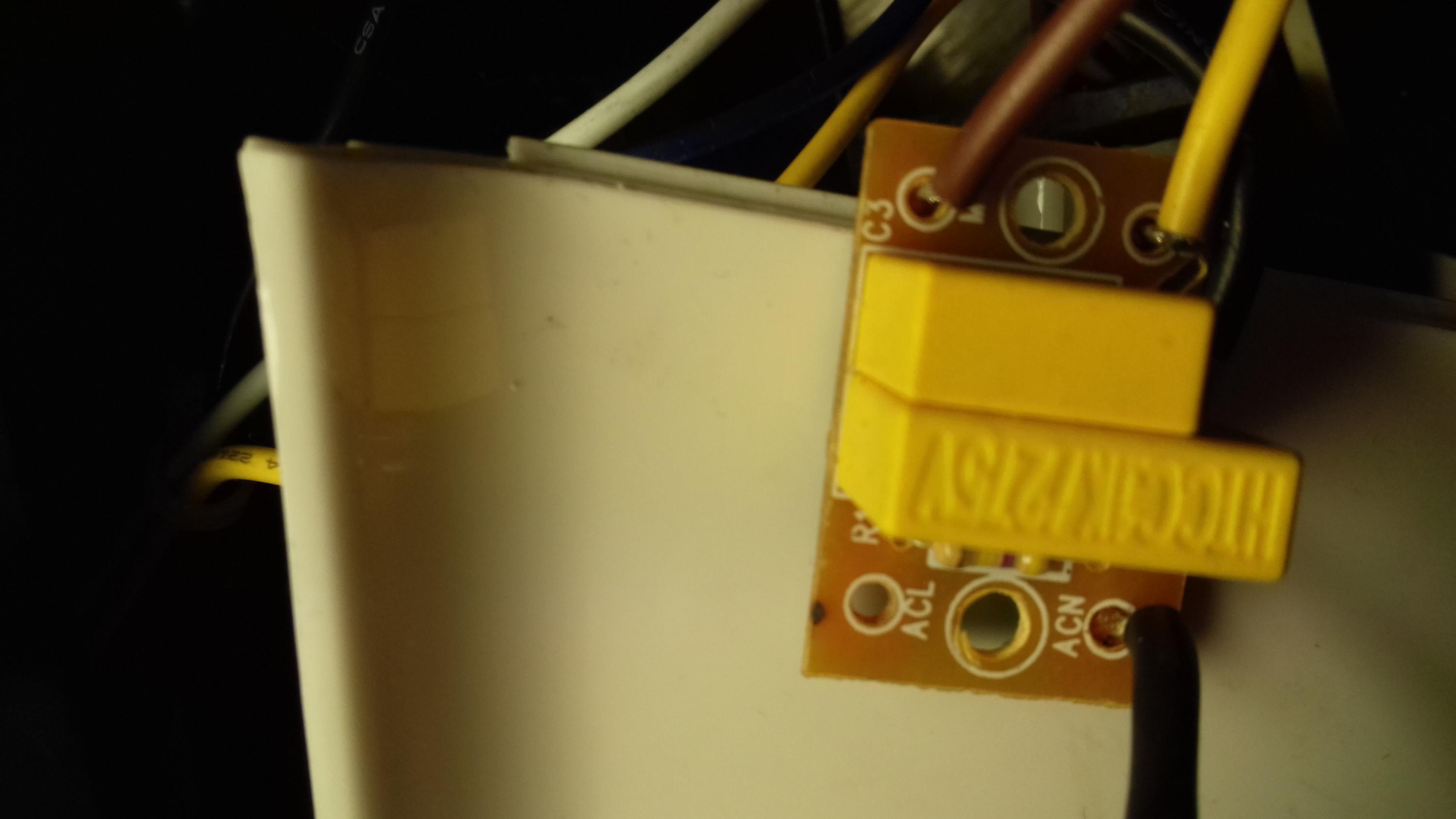

      as you can see there is nothing left to scrape and right next to it there is a resistor pin can i connect it to the resistor?

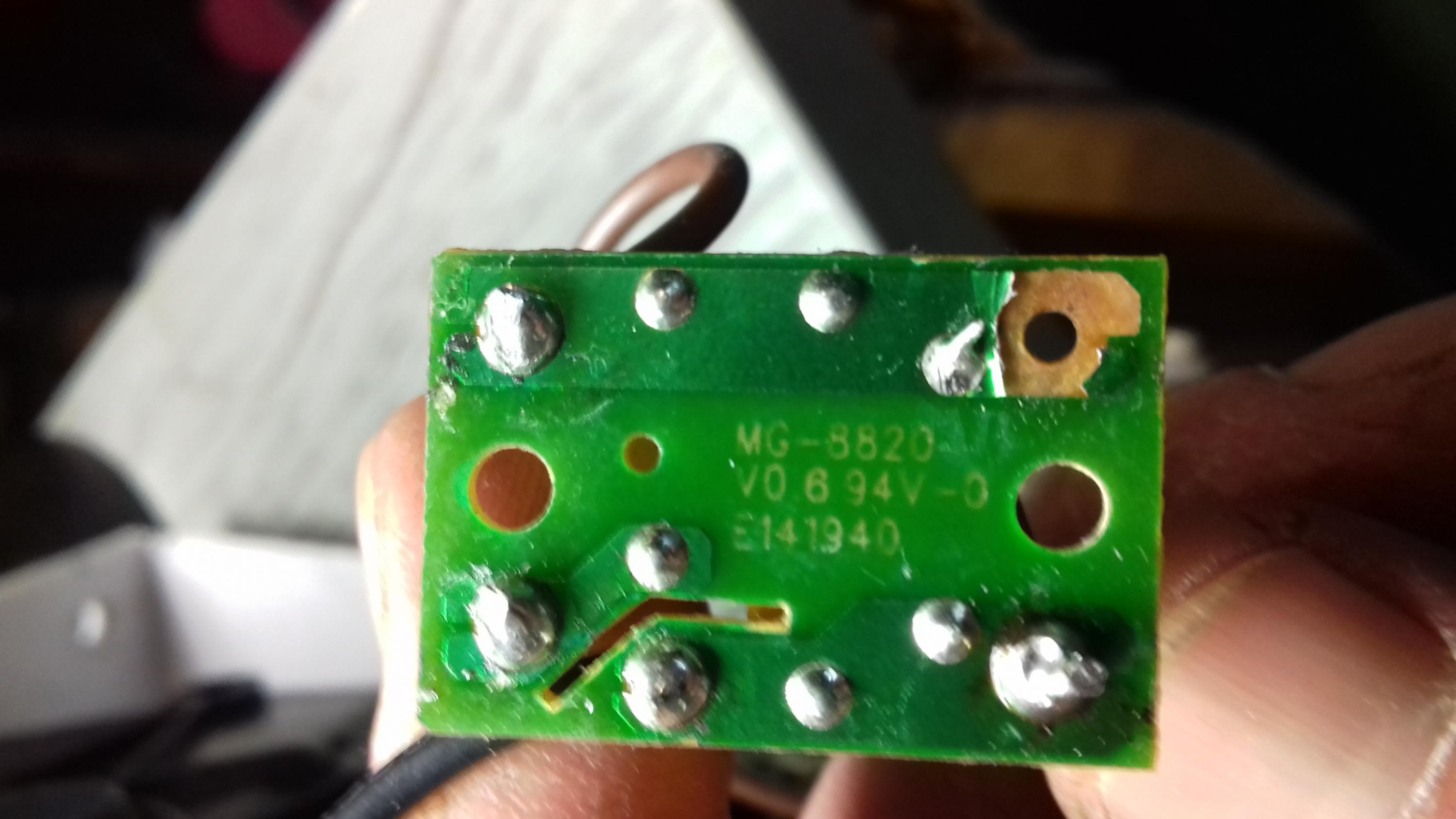

        scrape anywhere here ....

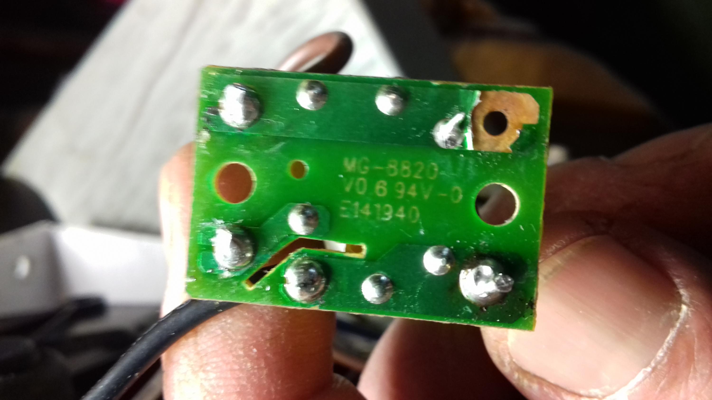

          Strip the wire back enough, run the wire through the hole and solder it to a couple of the other solder connections.

            ok thank you petehall347 and R_J
