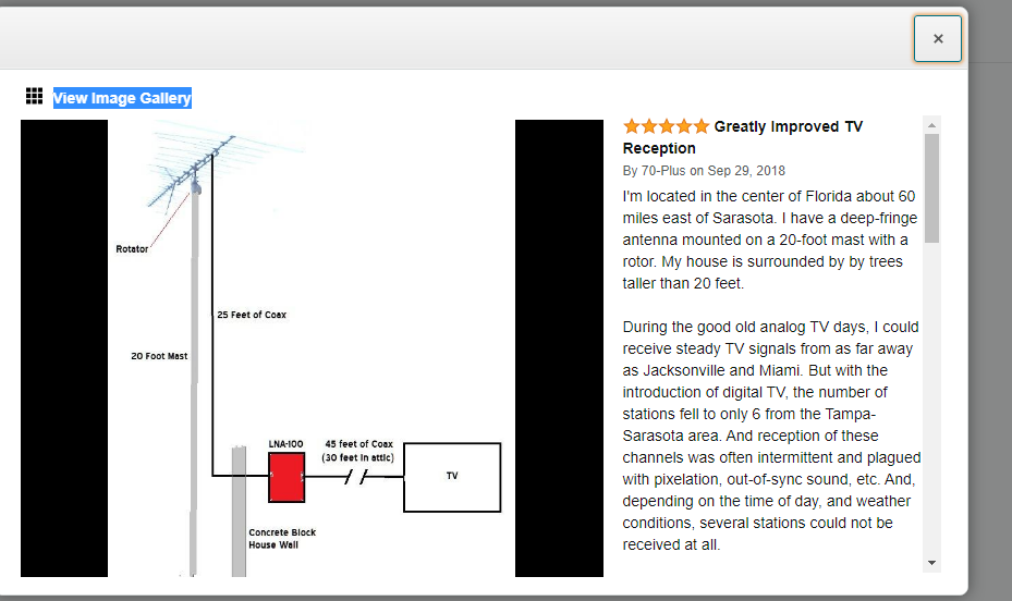

    Hi guys,i bought this hardware for my my outdoor antenna, but i'm confused these seems to be 2 antenna amps? or the white with the power supply is an inside power inserter? https://www.amazon.com/Winegard-LNA-.../dp/B00DQN3R9O

    amplifier bolts to antenna and power supply at tv end between tv and antenna wire .

      The black unit with the two F's and waterproof is the amplifier that should be placed near the feed point on the antenna. The white unit with two F's is the power inserter which is not waterproof and should be indoors. The thing that plugs into the wall is the power supply.

        Thanks guys for the info,i only asked because i have seen people use only the white inserter with power supply by itself inside as an amp,{See Link bellow} i already installed it the way you said and it works great, i have the best reception i 've ever had here in Boston area 60 miles away.

            Thanks for replying , still you don't address the question i asked if the LNa 100 white inserter and power supply can be used by itself without the black LNA 200?

              Who knows what's in those things. It may or may not have another amplifier. Also the DC offset it introduces may affect the receiver stage. The coupling from the power lines could also add to signal strength. So it's hard to know definitively what's going on, from hidden amplification stages, offset effects, injection, and of course the placebo effect.

                Thanks mate, appreciate your explanation and your great expertise. I have it installed just like suggested. LNA 200 near ant. and LNA 100 in the cellar 100 feet from ant. and 10 feet from Tv, Works great. If i was younger i sure would go up there to the roof 30 feet high and just would try antenna connected just with LNA 100 only, but at my age i already did too much 1 time, hope i don't have to go up there for the rest of my life, i already took precautions for that, installed matching transformer and Amp 200 LNA inside weather prove box attached to the ant. mast .

                  The lna-200 is meant for use with an outdoor antenna to boost the signal from the antenna to the tv, The lna-100 is meant for use with an indoor and not to be used together, The white power inserter (for the lna-200) has no amplification, it is just to insert the dc voltage onto the cable going up to the amplifier and it also blocks the dc from going into the TV's rf input.
                  The white LNA-100 does not supply voltage out the R.F. connector, it is a stand alone signal amplifier.

                    Thanks R-J now i've got it , the white piece and transformer that comes with LNA 200 is just a 5 v power inserter.
