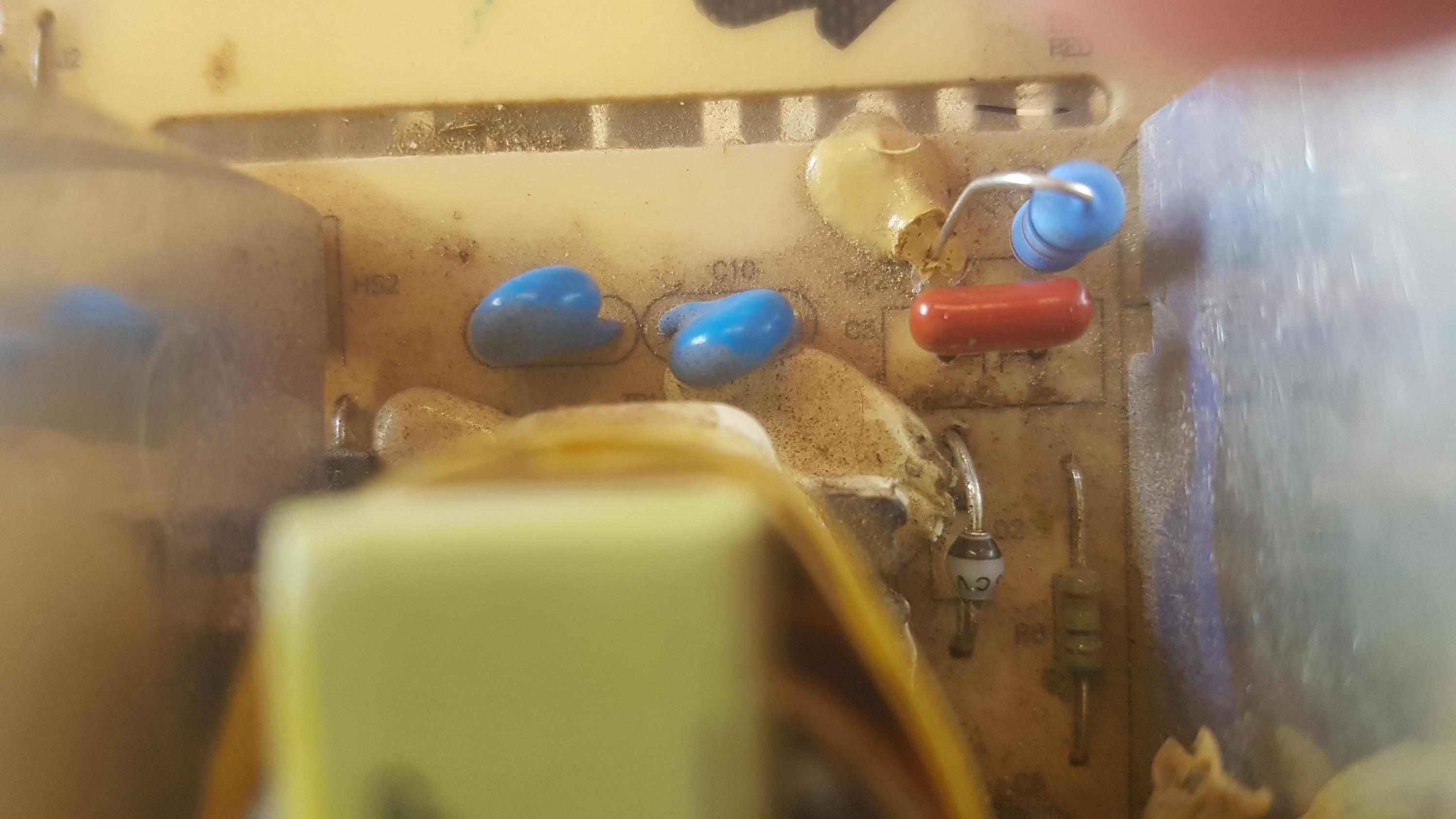

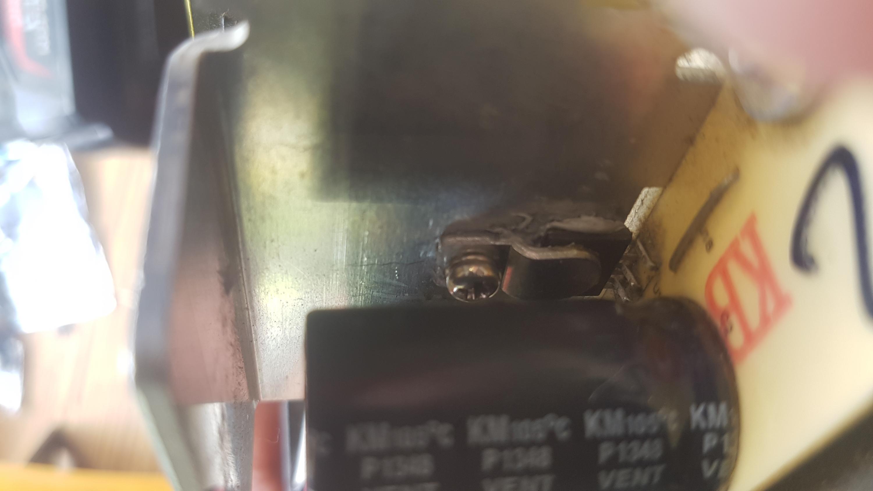

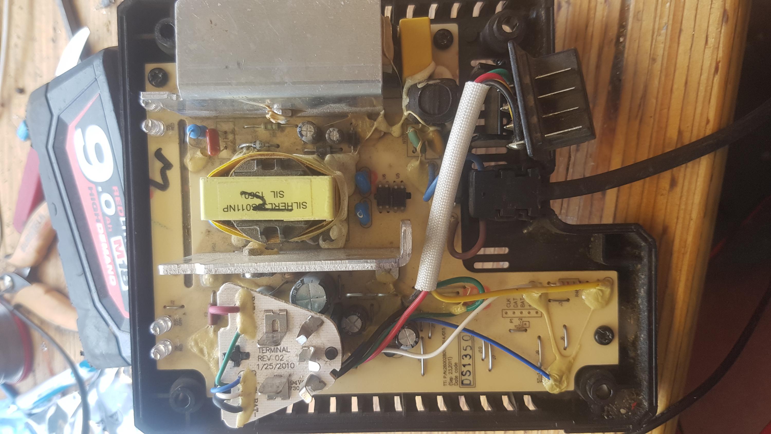

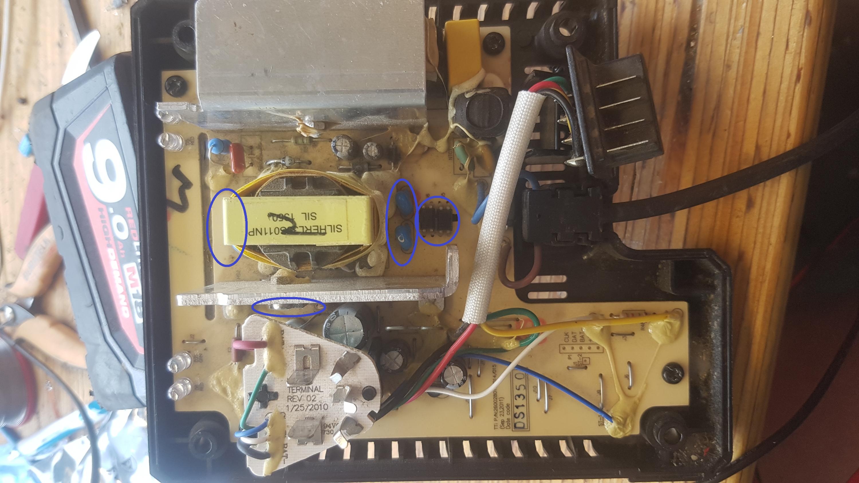

    Thought to post up a repair I recently did on two of these chargers.
    After replacing U1, TOP256EN, which seems to be a common failure and one I've done multiple times, these two ICs blew again, not instantly, but upon removing and reinserting the battery.
    What I found was the snubber circuit had failed.
    So after replacing U1 again, along with a resistor, polyester cap and a diode, all was well.
    The parts and locations:
    Replaced U1 - TOP256EN
    Replaced D2 - 600V 1A Diode
    Replaced C5 - 630V 4.7nF Polyester Cap
    Replaced R12 - 68khm 2W resistor
    Hopefully someone finds this info useful.

      They were older models going by the dust in them.
      They regularly come up on the local buy and sell sites. All the ones I've repaired have had the U1 chip fail, except for one, which was a faulty plug, and I ended up replacing the U1 IC first thinking it was that.
      It could be a similar issue similar to the C4 cap in Yamaha amps.
      On these two chargers, the cap was out of spec and the resistor open. I replaced the Diode just to be safe.
      It'll be just another thing to check.

          Check output diode, Optocoupler and cap beside the transformer.
          If the transistor blow up, could be several factor including Output diode shorted.
          If snubber goes blow up, maybe the optocoupler failed to make main transistor turn off so the energy goes to snubber, or the cap for "balancing" the transformer worn out (look at C10 and their friend) the cap usually use high voltage rating 1KV or 2KV or use safety Y Cap.
