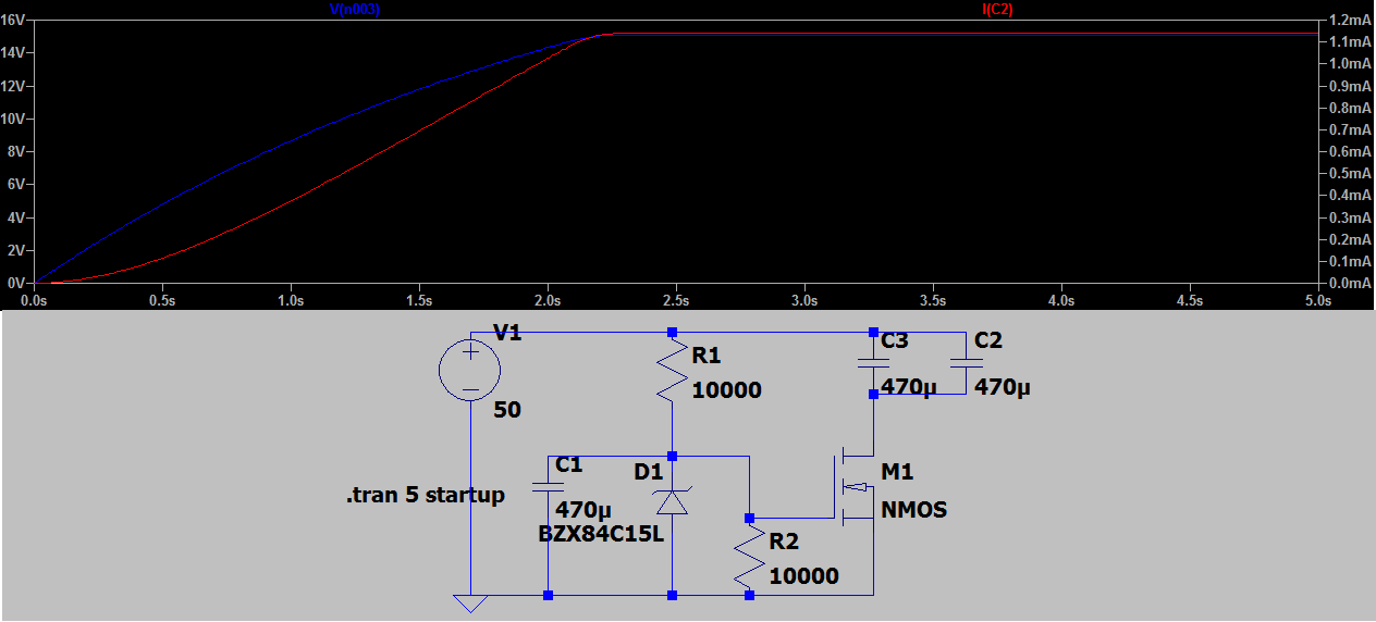

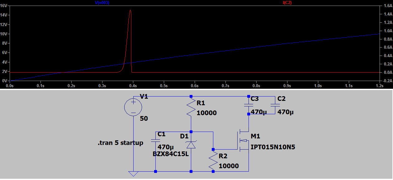

                    #29
                    Re: Master power switch for E-bike ideas
                    I finally gave LTSpice a try and tried simulating my circuit. Here's the weird part: if I use a blank "nmos" model for the transistor, I get the curves in the first picture. This is clearly wrong, because the cap current (red) is WAY too small there - doesn't looks particularly realistic. The voltage at the gate (blue) IS acting more like what you'd expect though.
                    If I try replacing the "nmos" model with an ACTUAL transistor from the database, I get the second plot: the current just spikes when Vgs is around 3.6v then immediately drops back down. Even if I increase the R/C combo, it doesn't smooth out that spike any further... It obviously doesn't have my exact transistor, so I chose one which comes fairly close in terms of resistance and Vds. I have no idea how to use LTSpice yet - I just clicked on stuff, so I'm probably doing something wrong still

                      #30
                      depends on your default model. Looks reasonable though, you should expand out the waveform.
                      TBH the "real" waveform is what to expect, and not much you can do about it, though you can slow it down even more by messing with the rc delay but it'll slow turn on time even more...

                        #31
                        Out of curiosity, I tried hooking up the caps directly to the power supply in LTSpice and of course the current went off the chart to like 350a at startup, so I'd say around 1.4a is reasonable there

                          #32
                          Now that's a really low ESR capacitor... Then again it is an ideal capacitor, and ideal capacitors have 0 ESR.
