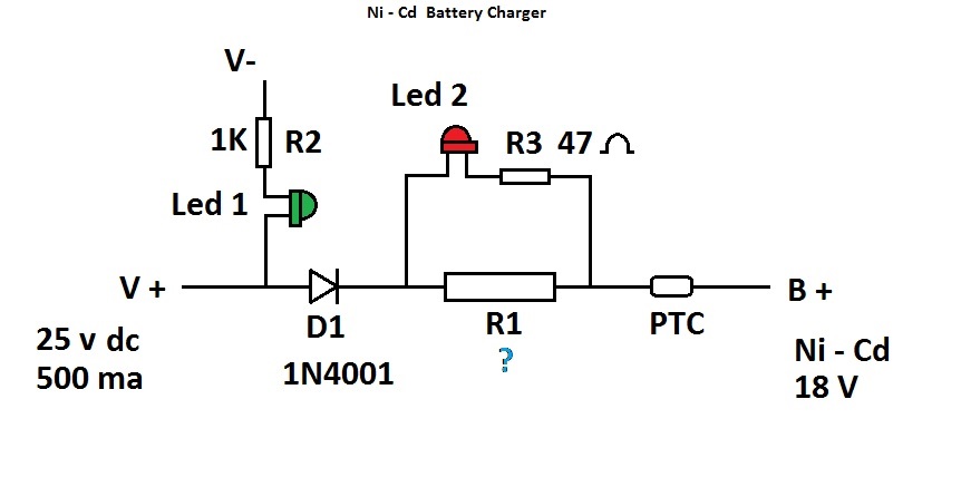

    I would like to know how to calculate the value of resistor R1 in the enclosed Ni-Cd Power Supply photo.

      Re: Ni-Cd Power Supply Resistor
      Use an online ohm calculator you need
      18 volts @ 500 milliamperes or
      25 volts @ 500 milliamperes the resistor value will a little bit higher
      Use at least 2 watt resistor for this device at a minimum
      If you use this method above do not leave the battery on the charger continuously this will shorted the life of the batteries
      However you would be better off if you used something like a LM317 voltage regulator in current mode this will give you better current control which can also be found on how to use it in current mode in the data sheet for this device
      If you use a voltage regulator in current mode I would recommend that you use 50 milliamperes and 500 milliamperes if you want to leave the battery on the charger all the time use the 50 milliamperes mode and if you want a faster mode charging mode use 500 or 750 milliamperes just make sure that you switch it back to the lower current mode after charging if you leave it on charger
        14ohms
        and it's going to generate 9w of heat!
        (so maybe consider a chinese intelligent charging module instead!)
                My diagram is of a Jobmate Ni-Cd charger
                Board # KW14-V0
                R1's outside coating has burned away,leaving no color code bands
                In circuit R1 measures 3.9 ohms
                Are these formulas correct
                VR1=1.17 x Battery Voltage + 3.3v
                R1 = 3.3 / (1/4 of Battery Voltage)
                Thanks to everyone for your information.
                  Board # KW14-V0
                  Okay
                  Like what was mentioned earlier in this post if just replace the resistor the same exact thing will happen again because this is the cheapest way to charge a battery which has all kinds of issues
