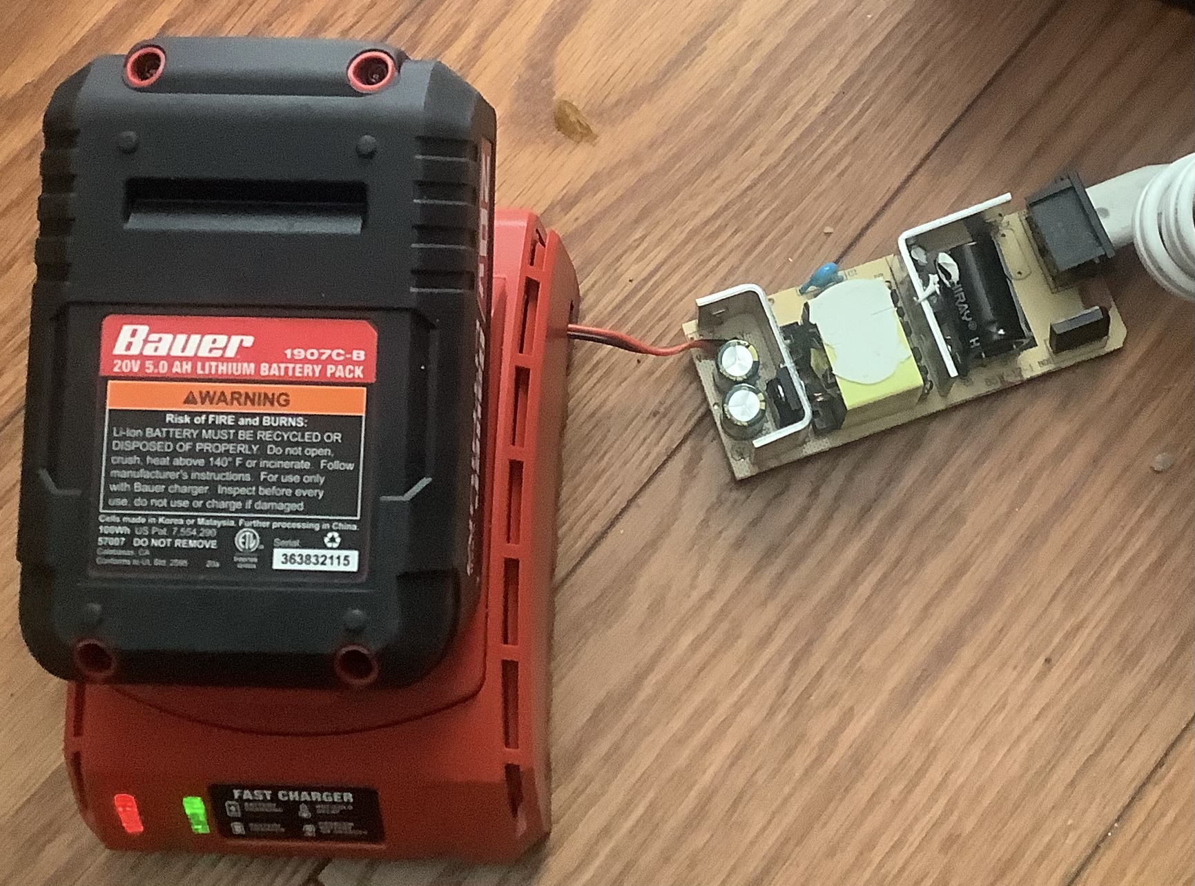

              Well I had some time to work on the issue of battery charger for the air compressor that I bought I found a 21 volt switching power supply from EBay and found that at least this switching power supply charging the batteries with out over heating in a short time
              Here is some results after 20 minutes of being on the center of switching power supply transformer has only gotten to 100*F and the top of switching power supply transformer is only 98*F which is hole lot better than the original switching power supply transformer was
              https://www.harborfreight.com/20v-li...ger-63529.html
              https://www.harborfreight.com/20v-li...ger-57006.html
              If this works and does not get extremely hot then I will probably buy a few more of these switching power supply’s that are supposedly 3 amps
              One note the battery packs that I am charging are mostly charged but this did not matter with the original switching transformer it still would over heat after a short period of time being on charging the battery pack

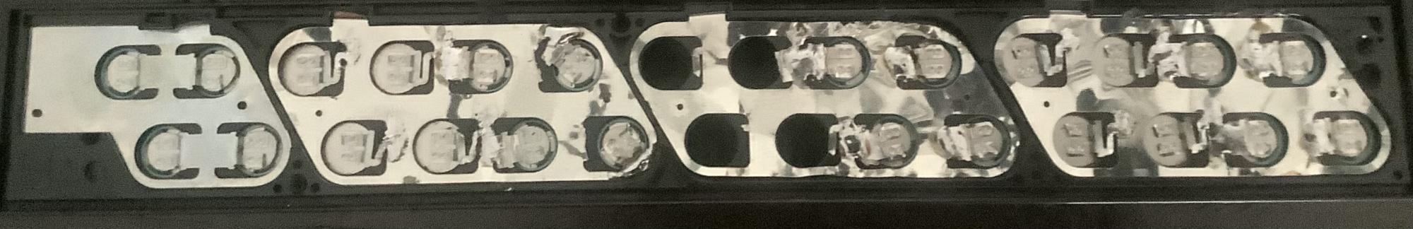

                              • Jul 2011
                              • 6037
                              #174
                              Re: Here is a good used source for 18650 batteries
                              Here are some pictures of the 7S4P modified to 3S8P fairy easily to do but a little bit time consuming to get it this way
