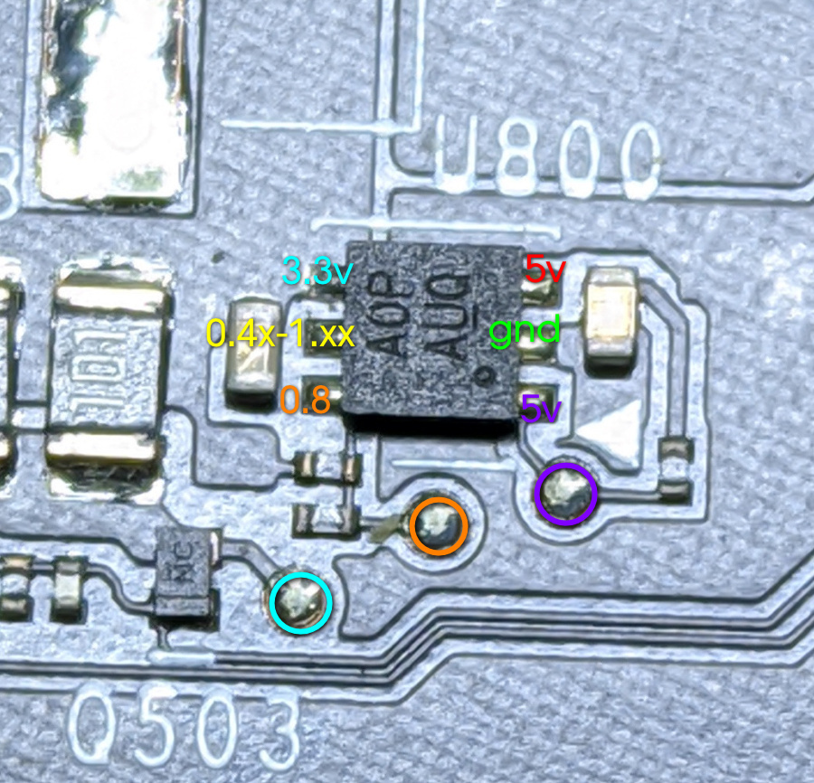

Mosfet marking AOP (AUQ) datasheet or ID
  • m3g4tr0n
    • Aug 2011
    • 88

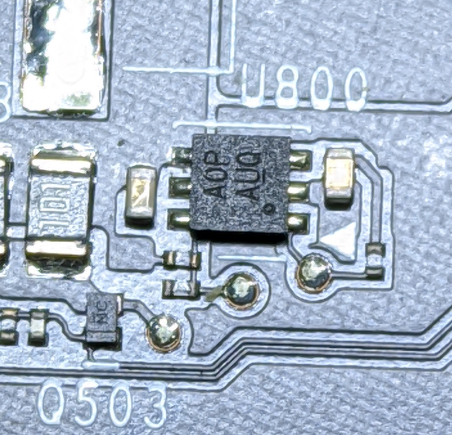

    looking for datasheet or ID of the chip has marking AOP AUQ. I checked on two other boards that i have and they show AOP AUR and AOP AUK.
    or its A0P?
    thanks

    Is it on a laptop motherboard
    • m3g4tr0n
      • Aug 2011
      • 88

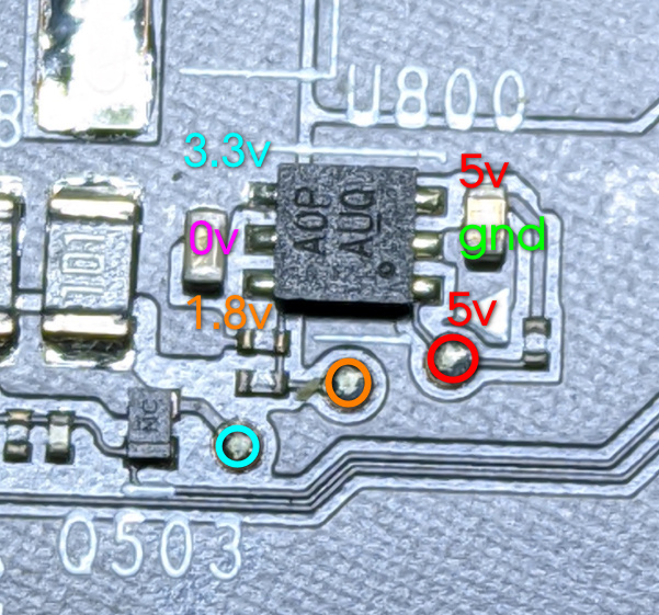

      Re: Mosfet marking AOP (AUQ) datasheet or ID
      it's on an Nvidia Shield.
      attached a picture of voltages on a working board.
      on the non working board, i have 5v only on pin 3 (under letter Q). other pins read 0 volts.
      • R_J
        • Jun 2012
        • 9623
        I found the Micrel MIC5320 that is a dual output regulator, but has the wrong pinout
        • m3g4tr0n
          • Aug 2011
          • 88
          just an update on the image with voltages. 1.8v should be 0.8v and pin with 0v should be between 0.4xV to 1.xxV voltage changes depending on load?
