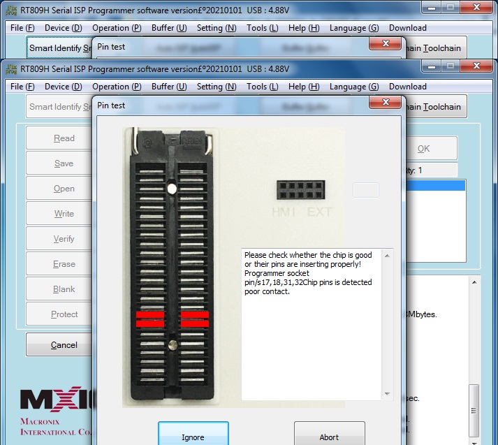

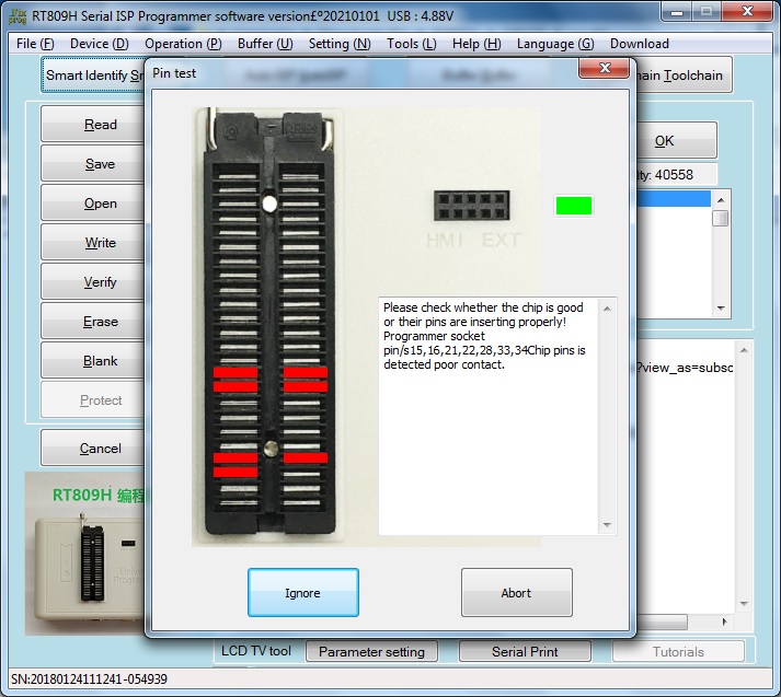

    Hi guys
    My RT809H is not detecting any chip. Whenever i try to detect any chip it's keep showing me messages.
    Chip pins is detected poor contact, operation has been terminated.
    chipPin: 6-30-24
    Chip ID identified error, the chip not well placed or has been damage.
    No matter which chip i use or which adapter i use it's keep giving me random messages and random errors.
    If you look at the picture 1 and 2 same thing happen here is well. random errors here is well.
    when i bought new i used only once and even then it wasn't reading any chip.
    I have tried 2017,2018,2019,2020,2021 version software ;(
    it's showing 4.8v with usb cable, is it enough voltages to run this programmer or do i have to give external power is well.

    Re: RT809H Programmer Not Detecting Any Chip
    The VUSB voltage is fine.
    Do you have other USB cables you can try? Consider to use the shortest cable you can source and if possible, a branded or known good cable.
    There is so much garbage in the USB cable business. A good cable will be truly USB IF certified which implies that the proper shielding, etc. are in place for the cable assembly.
    Next, it is possible that your programmer is a dud. Perhaps can be fixed once you take it apart (carefully) to review the soldering onboard. Perhaps a dry solder connection or two.
    Be sure that you are placing your device to be tested (read / write, etc.) properly inside the zero force socket.

            try on another PC,
              • 30952
              test it with a dip packed chip that doesnt need any adapter.
              adapters are a pain in the ass with pin detect errors - the more pins the bigger pain.
              i specially hate reading 48pin Tsop chips!
