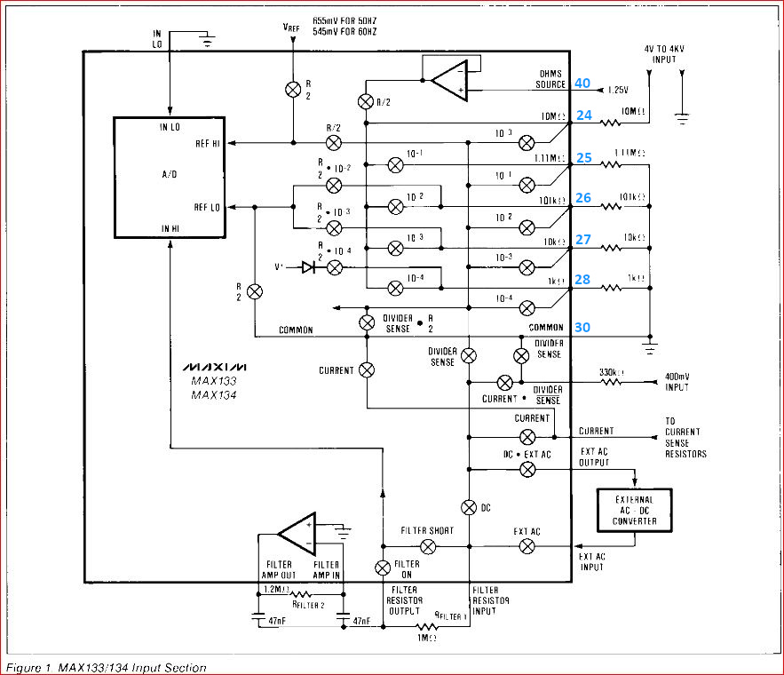

          In that schematic of the MAX134 that you attached (Figure 1 Input Section page 6 of datasheet), there are circles with "X"s in them; do they represent unnamed components?

            I looked at the MAX134 datasheet, the circle with an X represents a CMOS switch like a CD4066, that the MCU can control. So the MCU is doing the auto-ranging by reading the A/D and deciding which switches to have on/off.
            If it keeps going back and forth, the MCU must think the range is over-range, then move up a range then sees under range and it just keeps flipping back and forth.

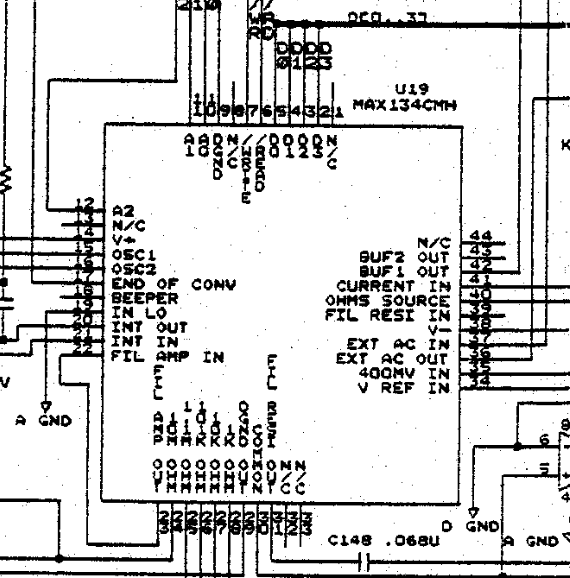

                                I get a reading of 0.2 Ohms between AGND and BATT(-)
                                Where does AGND and DGND come from, or go to?
                                On the schematic, there is an arrow coming from the DGND at pin 29 of the MAX134, pointing to a "cartouche" with some letters in it, but as it is on the crease of the original schematic, I can't read it.
                                I can't see on the schematic of the MCU, which pin/s are supposed to be supplying 5V.
                                I've tried to find a pinout drawing of the MCU, which is a Samsung S3F84DBXZZ-QXRB TQFP100, but every link to the datasheet turns out to be for an 80 pin MCU, not the 100pin MCU that is used in the subject meter.
                                For what its worth, I've measured some voltages at CN9, which is one of the two 12pin connectors joining the two boards. According to the schematic, the first four are named as:
                                1 (a circle with a + in it): 2.9V
                                2 V+: 2.9V
                                3 Vss: -5.69V
                                4 DGND: -1.9V
                                Does it mean anything?

                                  Uh that seems like a short between AGND and BATT(-)
                                  From the MAX134 datasheet:
                                  "Analog Common is derived from a zener and is nominally 3.0V below V+"
                                  "...MAX134 also generate a Digital Ground voltage, which is nominally 5V below V+ and which will remain in the range of 5V +/-10%..."

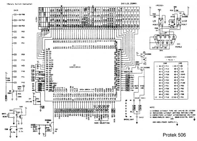

                                  I did find this (different) Protek 506 CPU schematic. There is tantalum capacitor C65 2.2uF between BATT(-) and AGND, might be shorted but at this point I think it's the multimeter IC that is shorting those two grounds.
                                  Your voltage measurements seem weird, which point is your reference?
                                  Circle with + is switched 9V BATT(+) that Q2 does so it (CPU) can turn off the multimeter.
                                  V+ is raw BATT(+) after the mechanical on-off switch.
                                  VSS I can't find where it's from.

                                    Re: MAX134CMH+D A/D Converter: Faulty or OK?

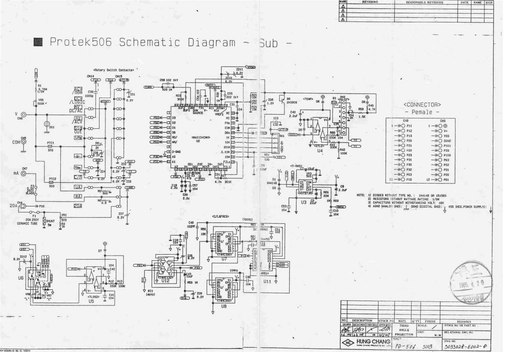

                                    Thanks, redwire, for supplying that clearer schematic of the CPU (U1). Is there a clearer schematic image of the MAX134 (U2) and rotary switch connections to be found?
                                    So, are you thinking now that there may be a fault within the CPU (U1)?
                                      I found that schematic at https://www.elektroda.pl/rtvforum/topic360033.html (run through google translate) but nothing more other than Excel file about calibration.
                                      I think the CPU is OK although likely running at over 5V so I would wait until the new MAX134 comes in. I'd just use sharp side cutters and carefully cut the pins to get the old IC out, and then a quick wipe with the soldering iron to clean off the pads.
                                      The A/D is pretty much crippled with the bias voltage being gone. It can read some voltage values OK but not ones that are -ve or close to the rail- there it would read incorrectly.
