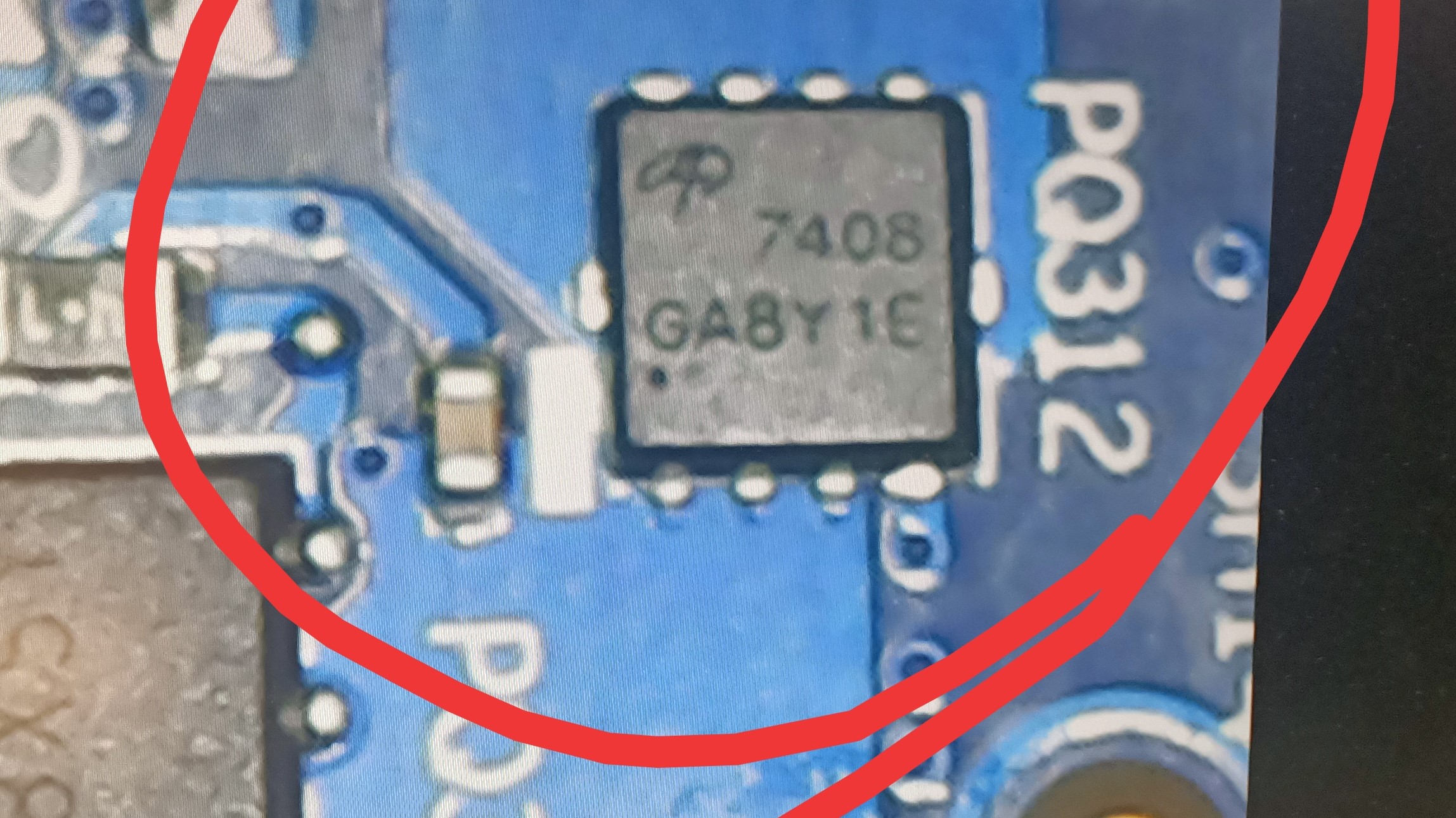

    Hi guys, this chip appears to be shorted to ground. Continuity tests to 20V power pin on one side, then the entire other side is continuity with ground. Also heats up to ridiculous temperatures.
    What alternative chips can I use in place? Or where could I source a replacement. I can't even seem to find documentation on the chip.
    Thanks in advance

    It is a mosfet, Alpha & Omega AON7408

      Thanks so much, I've managed to source a replacement.
      Could you tell me please, how you found it? whats the easiest way to use the numbers on a chip to find online? thanks

        I would also like to how you found this part number
          • 31283
          Re: Help sourcing replacement / alternative chip
          part number is etched on it - next to the company logo

            once side is all drains .maybe they all are supposed to go to ground .

              it takes a lot of heat to swap that package type - the entire underside is metal
                If you just google 7408 nothing comes up I did not recognize that company logo

                  If you know the logo, all you need to search is "alpha & omega 7408"
