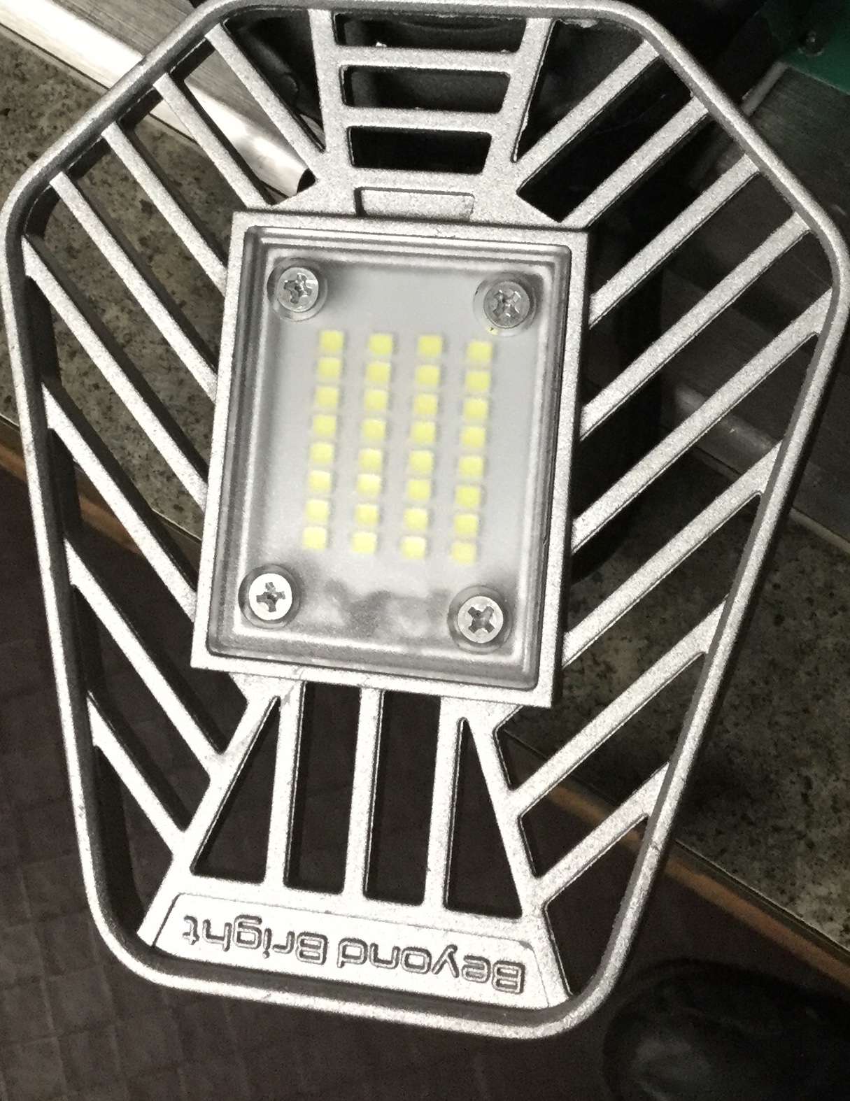

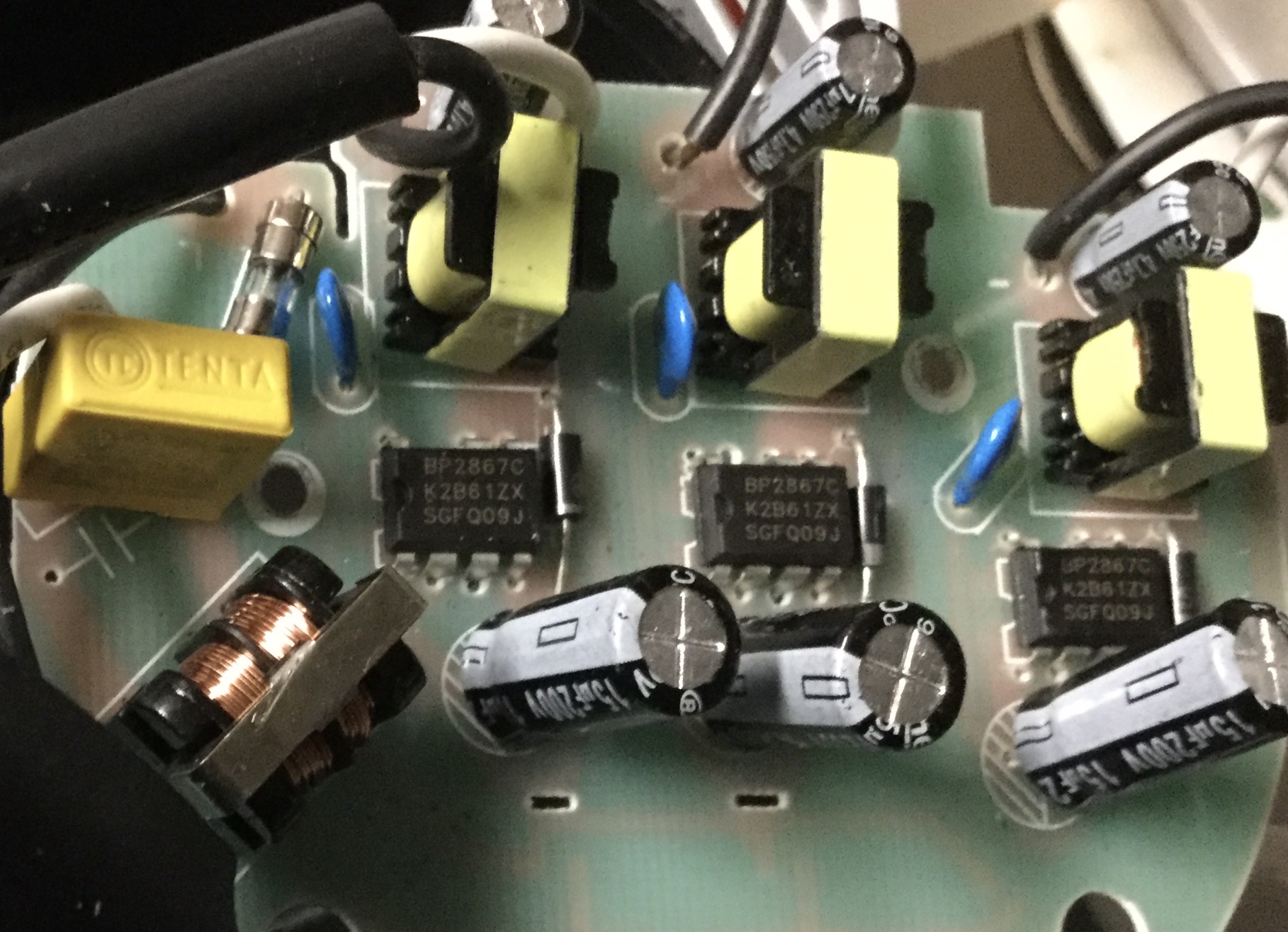

    I bought this LED lamp that uses this ic chip
    This light is bright as shit each LED light pad has one of these ic chips the board is nicely designed and layout

    BP Semi: http://www.bpsemi.com/en/product.php
    They probably over drive the LED's as usual.

      I found out what voltage that these LED modules 48 volts @120 milliamperes this has decent light output
      At 280 milliamperes the voltage is 52 volts and that where the LED light is bright as shit
      They are the data sheet says this <280 milliamperes @ 72 volts
      I have some 48 volt at 300 milliamperes power supply’s which means that I can run two LED light modules on one power supply

        The question is, what are the LED Vf and If spec? It is got going to be easy to find out.
        120 mA should be OK, but not so sure at 280mA.

          When powered at 120 milliamperes the heat sink only gets moderately warm but what I paid for it I not going to be overly concerned about it
          I have used this approach before and for most it has worked for me before
          Yes I agree with you about the 280 milliamperes is way over powering them because when you start going higher than the 48 volts the amperage goes up very quickly so I think at 120 milliamperes should be just fine
