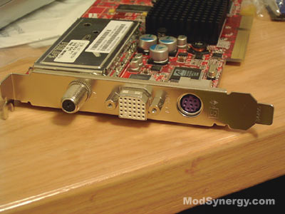

    ATI AIW-9600 Pinout
    I have an ATI All-In-Wonder 9600 here and I need to find a way to adapt this connector to a regular DVI or D-SUB connector. Can anyone help me with a pinout?
  • kikkoman
    • Jul 2007
    • 691
    Re: ATI AIW-9600 Pinout
    http://pinouts.ru/VideoCables/ati_le5_pinout.shtml
    i think this is the one.
    may be quite a fuss to build a reliable adapter.
    there's only one cable on ebay that should fit:
    http://cgi.ebay.de/ATI-Radeon-All-In...item3357997465
    (or the card itself +cable for 21$ +16$ S&H)
