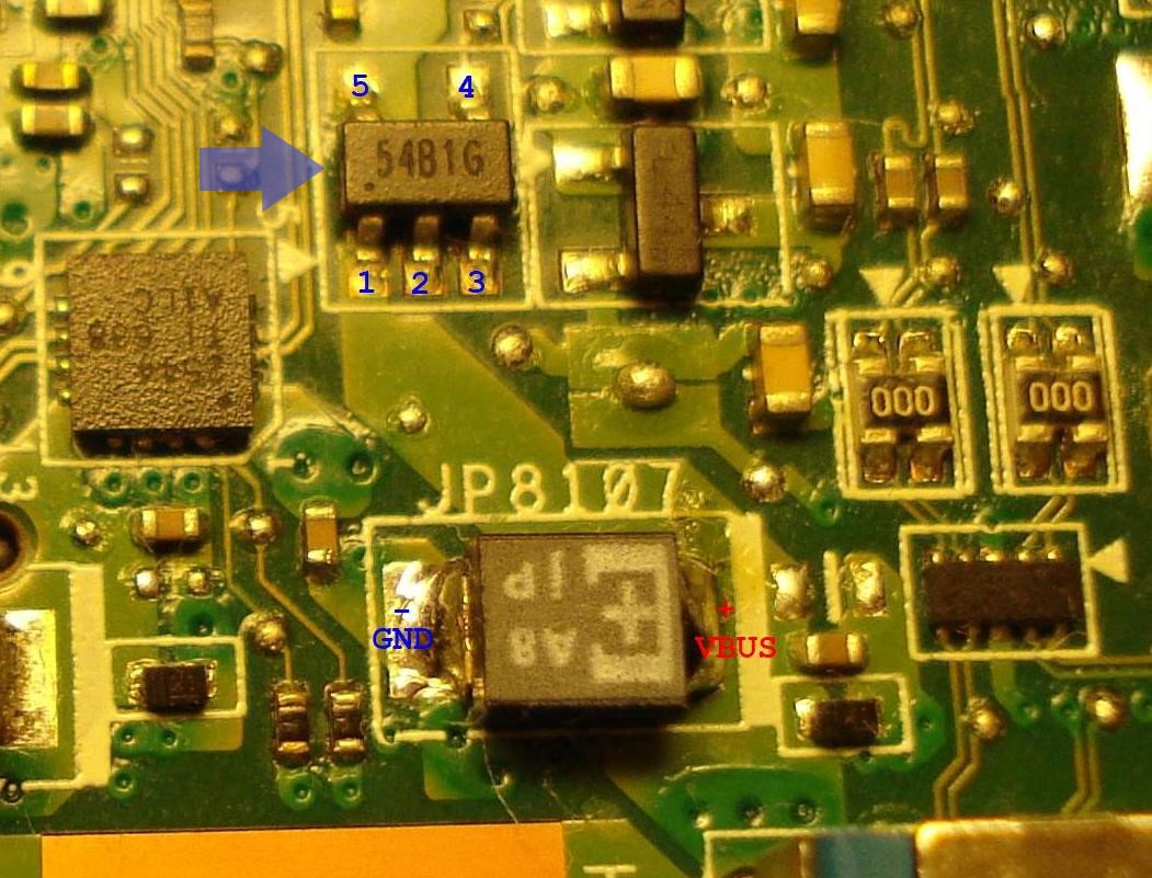

    This little element is marked 54B1G
    is it some kind of power switch for usb?
    I can't find anything online.
    I burned the USB port when I connected 12V to 5V by mistake. I replaced the tantalum capacitor and now the USB is working but my resistances between VBUS and GND on that USB port are doubtful. Something else is probably damaged.
    • 31281
    Re: Component identification
    aat60054b-s5
    maybe
      • 22104
      The part is a Seiko S-1339D15-M5T1U3 ,you can use a silergy SY6288C20AAC as a replacement part .
      • diif
        • Feb 2014
        • 6978
        • England
        This listing suggests it's a G524B1 https://www.ebay.com/itm/10pcs-G524B...-/401903391376
          • 22104
          You`re right diif ,the part numbers i got were from russian forums .
            Thanks!

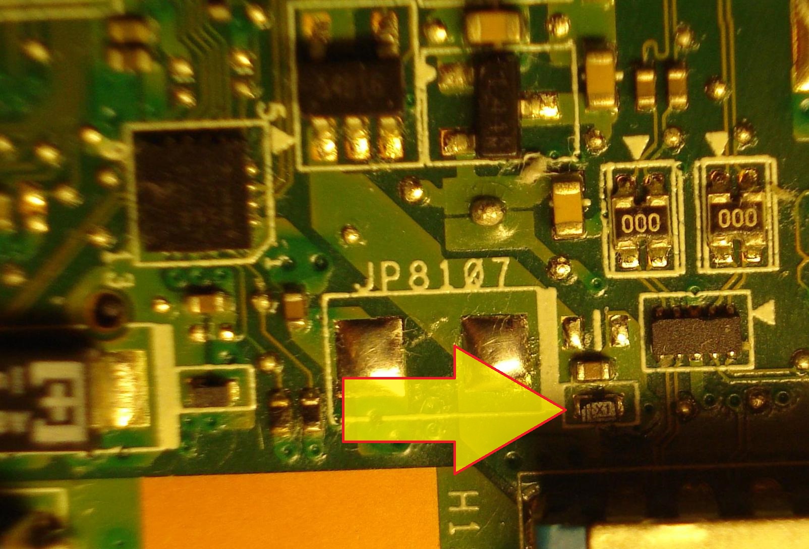

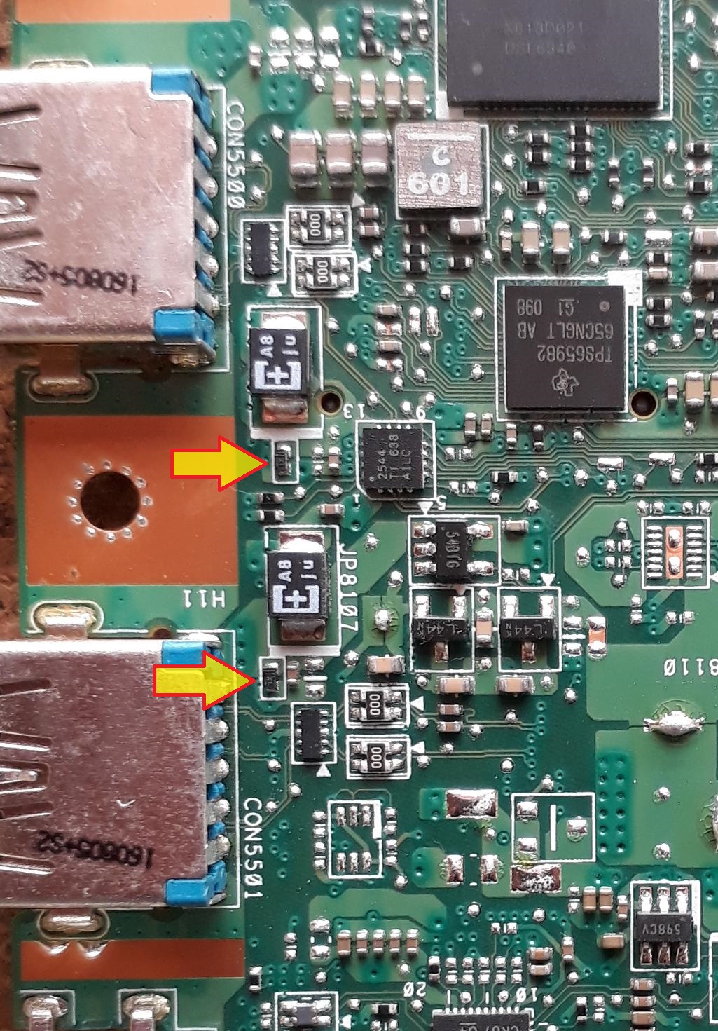

              There is another component to which I can't find anything online.
              It is marked with X1 and is connected in parallel with a tantalum capacitor and a small ceramic one.
              Can anyone help me identify this component?
                • 31281
                its a diode probably - the line at one end gives it away.
                • sasam
                  • Nov 2019
                  • 16
                  • Croatia
                  Yes it look like zener diode, or some kind of ESD protection diode but I cannot find specification.
                  • sasam
                    • Nov 2019
                    • 16
                    • Croatia
                    Could this be that diode?
                    https://cdn.badcaps-static.com/pdfs/...e424351f2d.pdf
