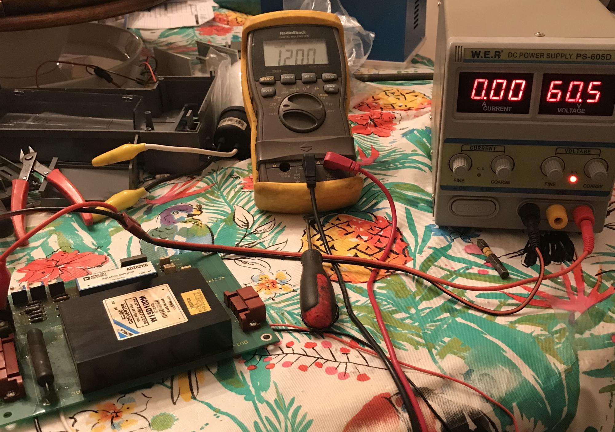

    I have this problem with our plasma cutting machine
    That the plasma head crash into the plate
    I have talked to tech support and he was telling to check the voltage divider board which I did
    The voltage input to output voltage is 50 to 1 ratio
    Which you have the following hook up-s
    are as follows
    120 volts ac input to power the board
    Input voltage from the chopper board about 350 volts
    Output to the PLC input card 0 to 5 volts
    Well I tested the board at 60 volts input and the output is 1.200
    Which is correct
    So either the on the PLC input card or the wiring from the Plasma Unit to CNC controller
    I just have to make sure that the voltage divider board is getting 120 volts AC

      I have some things to checking on the input card and make sure that I have 120 volts at the voltage divider board as well
      Now we have check to see if I get the same results from what I got on the bench testing
      Because at 0 volts input I got 0 volts output or do I get something else
      Because at 60 volts input I got 1.200 output or do I get something else

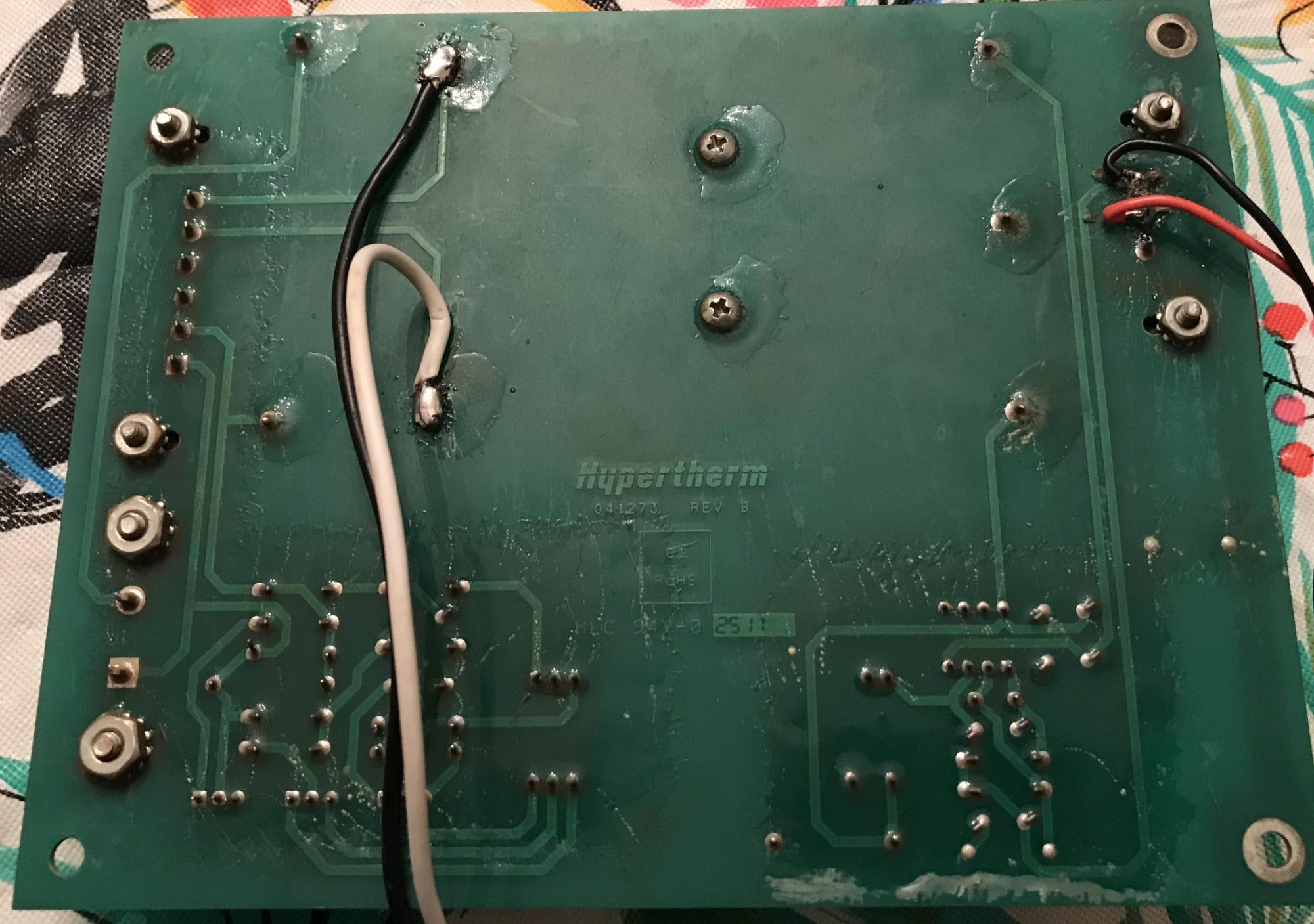

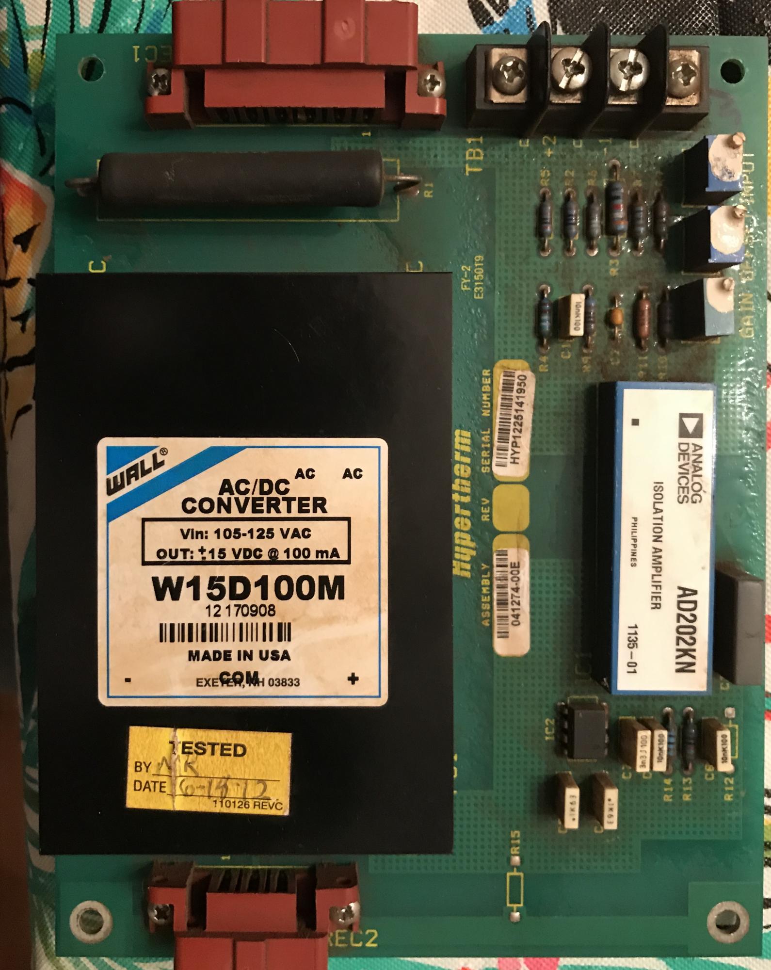

        I would check the +/-15V rails to the AD202KN, in case the PSU brick is the problem. Does it work at low line 105VAC and ripple is not present.
        I would expect shielded cable for the voltage-divider board output.
        Why does this make the head crash into the plate? It's not all stepper motors for height control?
            I give some real though if I see problem with the voltage that being reporting in the diagnostics screen
            I did check the voltage going to the voltage divider board the voltage was showing 127 volts on volt meter the diagnostics screen was showing 125 volts
            If it turns out that the problem is intermittent I will take it back out again do some more of this type of testing on the board again
            No it is only twisted cable

                      The problem looks like it is in the communication board that senses the voltage off of the power board
                      But the manual seems to be wrong about how to check the functionality of it
                      Because it says that the voltage on this connector should be 120 volts X ( 2 ) AC but this is a switching power supply board but the connector in question has 24 volts DC and a 5 volts DC that the four wires that are connected to board one note the board really has three voltages it also has a 15 volt DC but is not being used

                        The problem was on the communication board power supply connector
                        The connectors on the low voltage 24 v , -15 v , +15 volts and 5 v to the communication boards these connectors give problems every so often
                        This is why it not reporting the 120 volts AC input correctly
                        But I did check the switching power supply and the power supply with a transformer power supply regulators to make sure that I had the right voltages coming out of each regular
                        So the plasma machine is back up and running again
