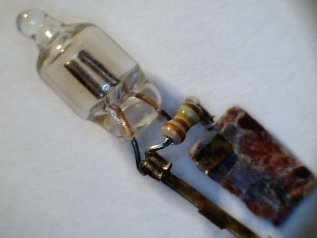

                        Having said that, the pilot light *inside* the dishwasher failed about a year ago, but when I took it out, the bulb looked ok, but the component (resistor) had turned to dust. I never got a replacement, as when I looked up the full correct replacement part, it was something ridiculous like €20-€30, so we've been coping without the light.
                        Can someone tell me what the resistor would have been? Is it worth trying to rebuild the light? I still have the whole assembly, with bulb, housing, wiring, connectors.
                        Or if I wanted to go the LED DIY route, what do I need to do? We're on 240V.

                            post a photo of the lamp - i find it hard to believe a neon could incinerate a resistor unless the resistor dropped in value first and made the neon arc.

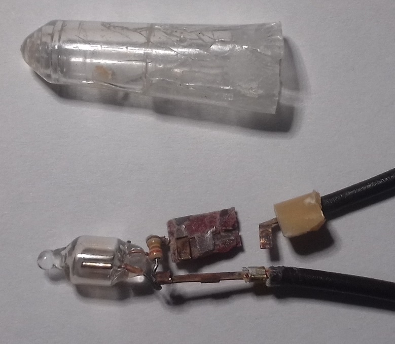

                              Here it is, you're right, I'm a liar (it's been a long time, I'd forgotten), the resistor is still ok, it's the part the other side of the resistor from the bulb that got fried, whatever it is.
                              The yellow thing to the right is just remnants of resin/plastic that was used to pack/seal the assembly into the clear capsule at the top.

                                Re: Orange lights - energy usage (power strips, wall switches)
                                i have no idea what the hell that was!!!!!!
                                i also dont understand the wiring, the resistor is across the neon but it should be inline with it.
                                *unless* the brick was a capacitor and the resistor was to discharge it - but that would be a really stupid way to drive a neon!!
                                if the black wires are just fed with mains then just get a neon with a resistor to replace it.
                                  I am wondering the same thing that might some type of capacitor and if this is the case something happened to that capacitor
                                  Because if you hook a neon light to the mains with no inline resistor it would blow the neon light completely out

                                    Some neon indicators have a resistor across the lamp, plus the one in series. It helps the lamp go out completely as some circuits have stray leakage currents/capacitance that can keep it lit dim and confuse people. That red phenolic, it looks like a terminal strip? There should be a second resistor somewhere.
                                    A neon lamp across mains will explode if you don't use a current-limiting resistor. I tried that once by accident.
                                    The resistor can be from 10k-330k ohms, to give 0.3-3mA. It depends on the size of the lamp and if it's the high brightness type i.e NE-2H.
                                    The old NE-2/A1A was 1" and around 0.7mA
                                    Stubby little 10mm neons popular now A1B are 0.3mA these are the ones that are overdriven and don't last in power bars. Ali has complete replacements, some neon or LED for $0.85 so cheapest to buy a new one, or do surgery on the old one.

                                      the resistor for 220-240v is often 220k
                                      btw, a neon acts like a high voltage zener or gdt,
                                      when it hits the right voltage the gas conducts and it goes from open-circuit to a total short.
                                      they used to be used as over-voltage discharge devices instead of spark-gaps in some crt monitors.
