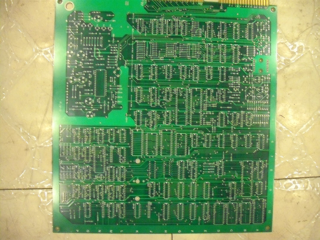

      I have nowhere near that amount of patience -- nor TIME! (And, clients would cringe at my hourly rate for such a menial task)
      Here's a pic of the first board I "scanned", many years ago (the design is now almost 30 years old). A crude count shows (about):
      • 3 DIP40
      • 4 DIP28
      • 5 DIP24
      • 13 DIP20
      • 18 DIP18
      • 28 DIP16
      • 22 DIP14
      • 6 SIP10
      • 240 2-terminal discretes
      • 20 3-terminal discretes
      • (neglect connectors)
      So, about 2,200 nodes in ~150 sq. in. of board -- that's not even 1 DIP16 per sq in... incredibly low density, by any standards! (my last thruhole design was 2 DIP16's per sq in; I now do SMT work, exclusively) Laughably so compared to SMT designs!
      2,200 items, taken two at a time (combinations, not permutations) would mean probing 2,418,900 sets of points, recording the result and transcribing to real components on a schematic.
      At 1 per second, that would take 672 hours (remember, you actually have to USE the data you are collecting from these probes).
      Granted, you can make semi-intelligent guesses as to which pins you NEED to probe for any given starting point, but that leaves you vulnerable to overlooking some potential connection (and, besides, YOU claimed to patiently probe every pair). And, each such assessment requires time to consider.
      If it was something as banal as a PC motherboard, you could probably make huge assumptions about "what's likely to go where" -- cuz they are largely similar to each other. OTOH, the boards in your TV are very disimilar from each other and neither resembles any of the boards buried in your vehicle or microwave oven.
      Having refined my tools and skills (in addition to technological advances in the COTS tools I use), I suspect I could have a fresh new schematic from scans of this board in less than two days -- ready to prepare a new layout on the third day (I'd need to consult a stuffing list to fill in the values of all of the discretes; the actives are legended in the silkscreen). I imagine it would take a draftsman longer than that just to capture the schematic from "paper".
      There are firms that now offer this as a service -- though I have no idea what their rates are (likely high as they are competing with ad hoc and "highly manual" methods)
