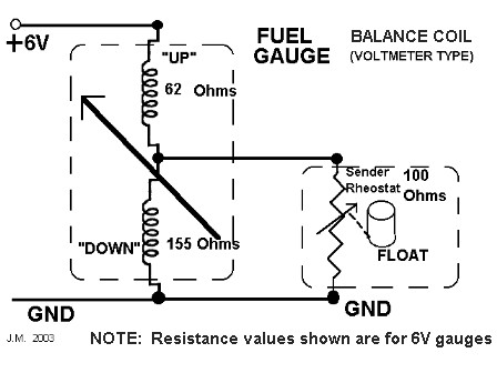

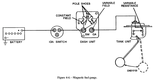

      Re: Automotive fuel gauge and sending unit issue
      It sounds like a fun project.
      You would need a circuit to amplify the signal, and possibly invert it because some senders are low resistance empty, others low ohms when full. You could do it with a couple op-amps.
      The hardest part is the gauge driver, these old gauges need several watts of drive, so a transistor there will make a little heat.
      At least three different types of old car fuel gauges:
      1. "balancing coil fuel gauge" with two coils, an Full and a Empty coil.
      2. "Thermal type", one heating coil and a bi-metallic strip, which is probably matched to the really low resistance senders. Usually a 'voltage stabilizer' used. 1958 Ford, VW Beetle.
      3. Two coils, one is a field coil.
      1,3 are current-operated. With a car's voltage constant i.e. 13.8V, then the tank rheostat's changing resistance gives a changing gauge current.
      2 heating is I^2*R so a parabola for needle deflection and current.
      That challenge is linearity, where 1/2 tank is accurate. If you really want that, then you have to have the sender's curve known and probably use a little MCU to correct the curve.
      I could work on a circuit but don't have a gauge cluster to test it on, unless I hit up a wrecking yard.
      A modern approach is to use stepper-motor gauge motors in the cluster.

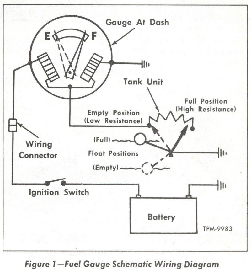

          Old GM 1930-1964 senders are 0-30 ohms; 30 ohms=Full. So the gauge wants to see Full=30 ohms, Empty=0 ohms.
          New aftermarket senders are 240-33 ohms; 33 ohms Full, 240 ohms Empty.
          So you need to invert the signal and scale it, if I'm hearing OP correctly.
          Hot rodders want to keep the old (6V or 12V) instrument cluster but use a modern tank sensor.
          Some Ford and Chrysler gauges do not have the backwards reading problem.
          You could use an Arduino, or stay analog and use a bunch of op-amps.
          I have to do research on controlling old gauges.
