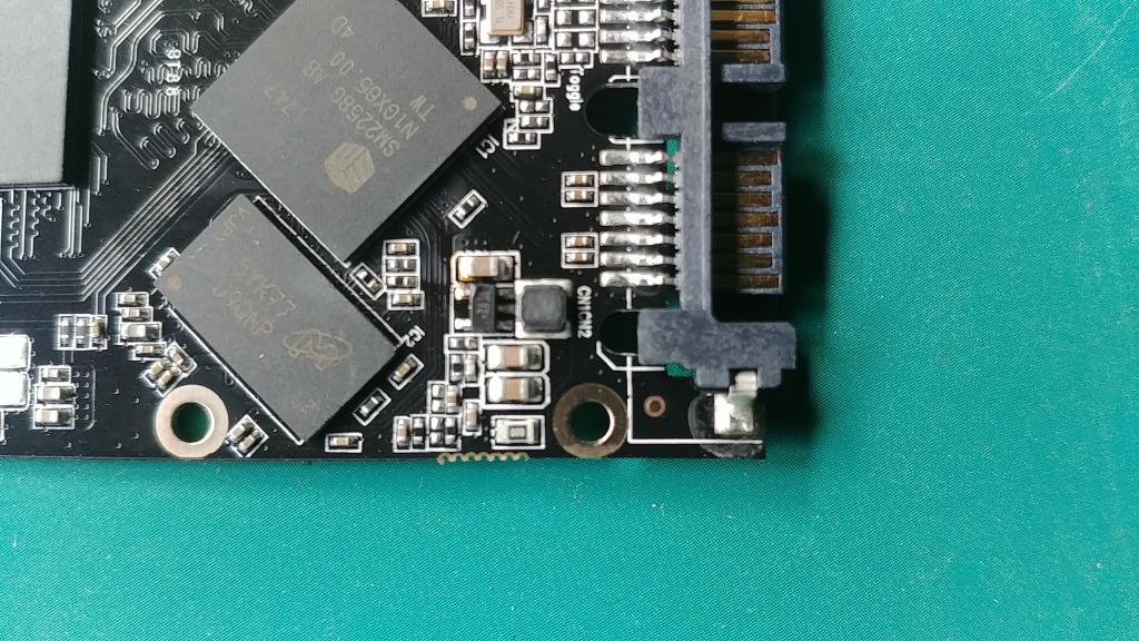

    sorry if this is in wrong discussion ...
    I had a little problem with my power supply (used the wrong cable), and burned 2 components on my SSD ...
    the one is 3012 743J4 SOT25,and the other 3013 (other is burned) TSSOT 8 pin
    here the pictures ...
    https://www.dropbox.com/s/8mdpyd2dz4...52912.jpg?dl=0
    https://www.dropbox.com/s/4s0cybehnk...62956.jpg?dl=0
    can anyone say what for a part it is to order it ...
    thx

    Can not see photos

      Sam - I pulled them from OP dropbox, here you go:

        Re: Unknown components
        thx delaware74b for pics

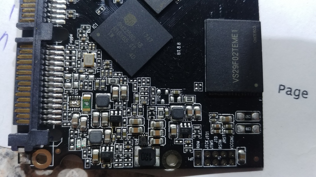

        On the second board the U14
          [QUOTE=nbdy;872612]thx delaware74b for pics
          It might be this part
          https://cdn.badcaps-static.com/pdfs/...62cb5cc01f.pdf
          It might be this
          https://cdn.badcaps-static.com/pdfs/...f476750c92.pdf
            THX,
            The 5 or 6 pin makes no difference for the 3012 ??
            the AOZ3013 i faund late yesterday ...
