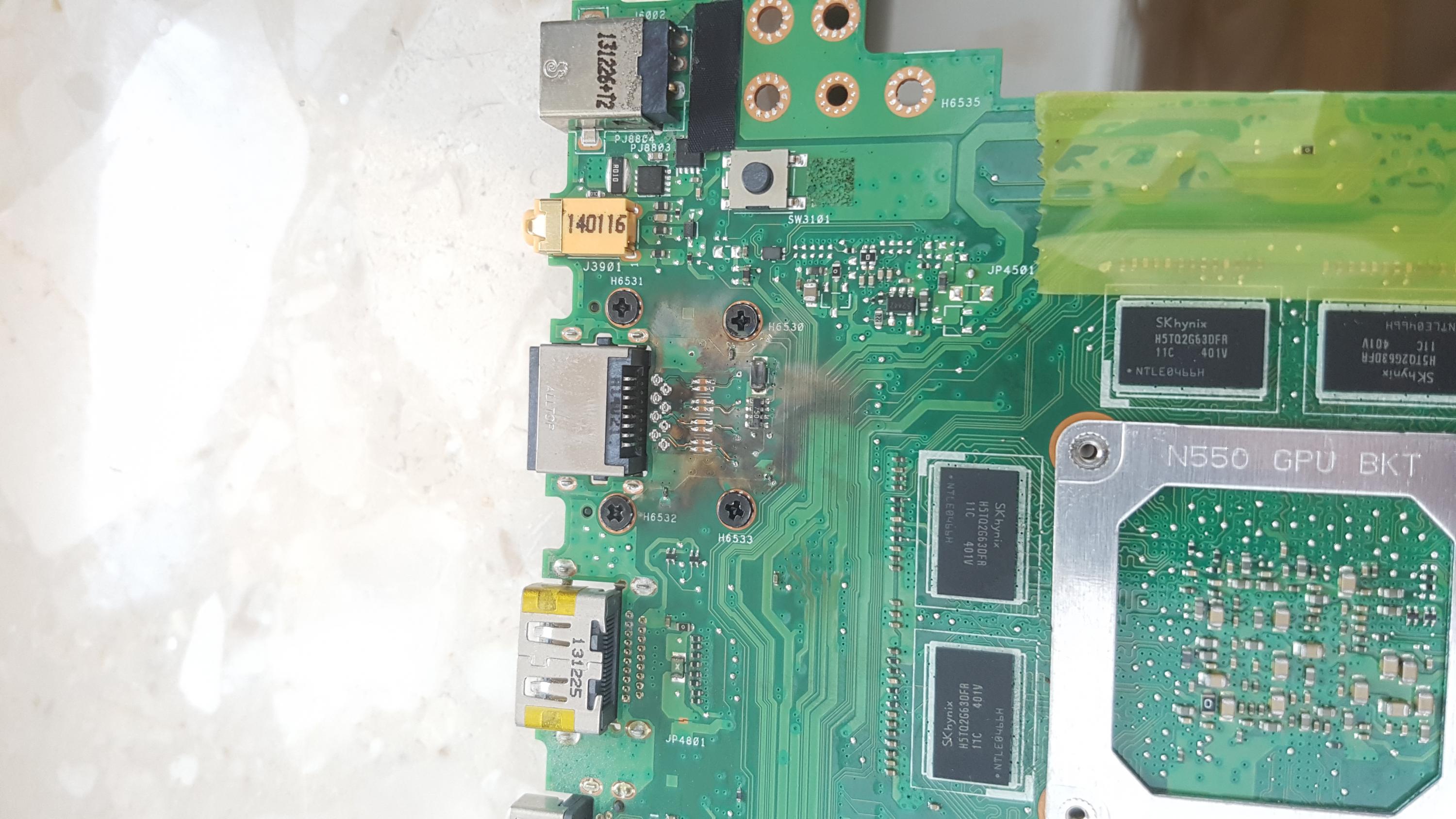

    Could you help me identify burned components on asus N550LF mainboard please?
    I am sure that main LAN IC is burned, this is the Realtek 8112G.

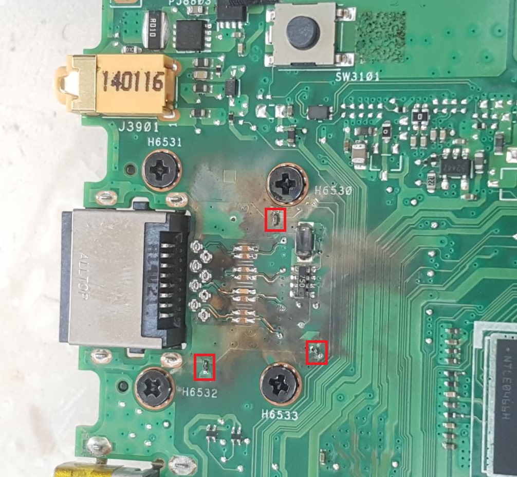

    Please check photo attached with burned components, tracks are easy to repair, resistor is 75 ohm but what could be that big capacitor which seems to be dead and three others probably capacitors (tiny ones).
    Any suggestion would be much appreciated

    UPDATE:
    - replaced main IC of the Ethernet controller (Realtek 8112G),
    - restored all tracks,
    - replaced all 75 ohm resistors,
    - replaced 1000pF / 2 kV capacitor,
    Did not touch these 3 tiny caps, I am not sure if these are really important.
    Anyway Ethernet controller is still dead, I mean in Windows device manager it shows as not connected (drivers are fine).
    Any suggestions what I could check now?

      There must be some interconnect or part that is defective on the rj45 side.
      Review the 75 ohm resistor network array. Confirm it is still at 75 ohms. Also the long inductor (?) that is beside the array. What is the resistance across this part? It looks burnt.
      This board had a lightning surge travel through it to cause this damage.
      Best to review a realtek example schematic for this part to understand the parts required to rebuild it.

        Thanks for your response,
        You are correct, board had a lighting surge.
        Saying Ethernet controller is still dead, I meant Ethernet controller is completely not visible in Windows device manager.
        75 ohm resistors are 100% fine, cheched them twice.
        That long inductor is a 1000pF / 2 kV capacitor (Bob Smith termination), also has been replaced.

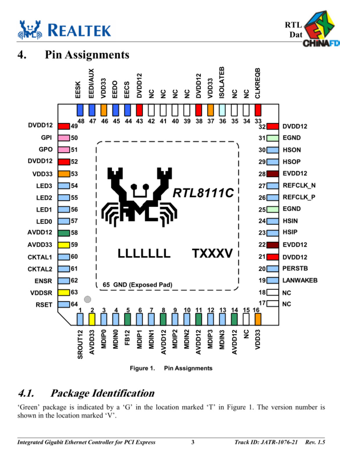

          I do have some pinouts for the Realtek 8111G which appears to be similar in pin count and can post it if there is an interest.

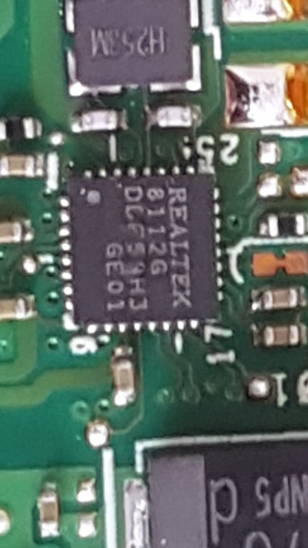

            I did use a flux, it should not be a problem, I visually checked every single pad under scope, I am more worried I bought a fake 8112G chip, ordered it from Aliexpres.

                  See attached. This may be the pinout for the Realtek 8112 QFN package. Confirm it by reviewing the power and ground pins.
                  Just noticed, the pinout for the 8112 appears to be a USB to Ethernet controller.
                  The 8111 Realtek is a PCIe to Ethernet controller.
                  First of all, can you confirm that we are dealing with a 48 pin QFN package? 12 pins per side on your device? That is what is showing on the Aliexpress stores.

                      The one which I bought is 32 pin package, 8 pins per side.
                      I ordered from that guy, here is a link: https://m.pl.aliexpress.com/item/400...yAdapt=glo2pol
                      The original one was the same, see attached.
                      I checked aliexpress store rating and it's really low, only 88% of positive reviews and rating of 3,6.
