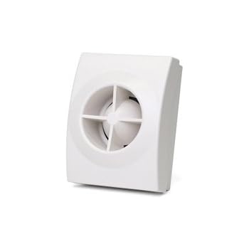

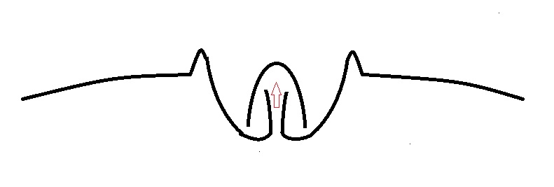

    I've got several of these "sirens"/noise makers:
    I want to modify (or replace) the top plate for cosmetic (and mechanical) reasons.
    E.g., in a couple of cases, I want the cover to appear as a 5" diameter, FLAT circular plate with the "port" located in the center. In every case, these will be subject to reasonably close (though casual) inspection so I really don't want them to look amateurish.
    Note that the current "top" is rectangular (instead of square or circular). And, that it has a bowed shape along the long axis, instead of being flat.
    First thought was to 3D print a replacement. And, hope I could solvent wash it to get a reasonably smooth finish.

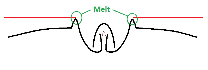

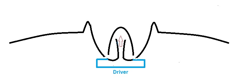

    The problem is the center portion of the port. It's a horn loaded driver for extra efficiency. So, what you don't see in the photo is the shape of the interior surfaces! If you were to slice the cover in half directly through the center, along the long axis, you'd get a cross section similar to pictured below.
    The pressure wave begins at the bottom of the arrow and winds its way around the folds in the "horn" until exiting through the visible port. Getting the shape of this curve correct in CAD would be a PITA (I know the principles but not the details!).
    So, I'd like to cut out the center portion of the cover and mount it to -- or build around it -- something more easily fashioned. E.g., cut a hole as large as the exit opening in the port in a sheet of plastic and "glue" the port assembly to that.
    But, I assume this will be a noticeable kludge. Any pointers as to how I might make it "more presentable"? I'm tempted to try a solvent wash (and paint, thereafter) but don't have any "spares" of these to experiment on so want to be reasonably confident of any approach before starting.

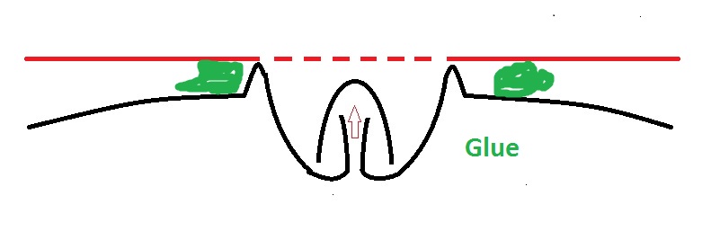

    Another approach would be to perforate a plain cover plate (instead of cutting a big hole in it) and mount this to the rear. I'm not sure how that would affect the SPL. And, the "exposed port" looks cooler! :<

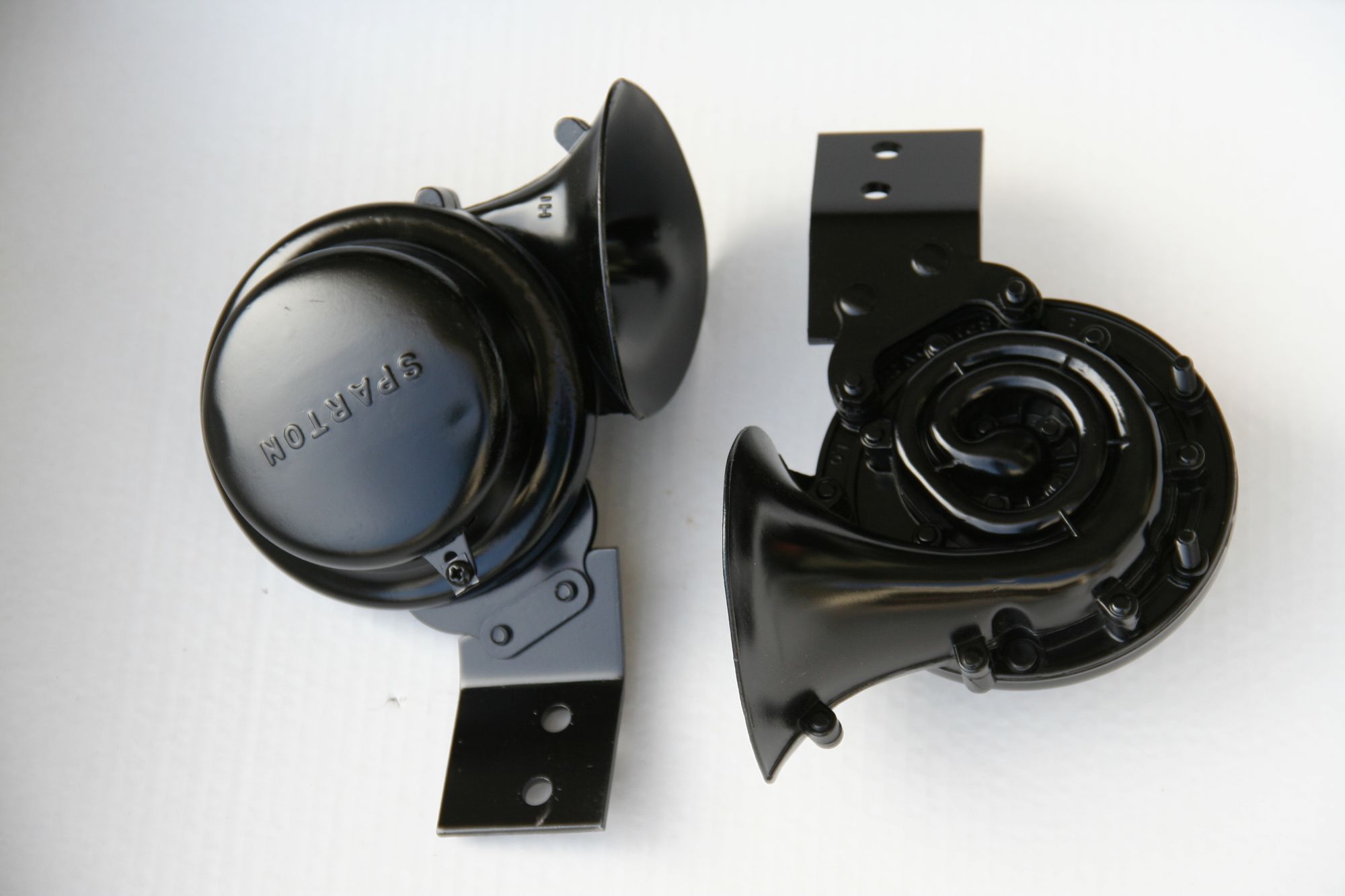

    Those Honeywell, Ademco alarm sirens all use that folded-horn.
    If you want it flat, I see no easy way to keep the horn. Horns needs depth at least an inch or two and the only slim horns I see are in car horns. There, the throat is wrapped on edge (see pic).
    Without a horn, you will lose many dB SPL and the piezo transducer will move more as it is not (acoustically) loaded.
    I don't know how much room you have to make the siren worthy of a beauty contest. People put then in furnace ducts/cold-air returns to hide them.
    pic from https://en.wikipedia.org/wiki/Horn_loudspeaker

      I only care that the top surface be flat (instead of crowned). I have a few inches behind the surface for the driver, wiring, etc. But, want the "exposed surface" to be flat -- so, envisioned a flat plate with a (large) round hole cut in it having the inner diameter of the outer horn envelope. The rest of the mechanism tucked up behind that surface.
      Exactly. The whole point is to preserve the intensity of the siren and the relatively small package.
      Code doesn't allow that, here.
      If I can (solvent?) "melt" a plastic flat cover plate to the existing horn assembly, they will fit nicely in the spaces I've set aside for them. Merging those two surfaces ("melting") in an aesthetically pleasing way is the problem. My fallback position is a perforated plate behind which the horn assembly can be mounted (adhered with glue applied indiscriminately as it won't be visible)

        I tried to come up with some ideas but the best is using a cloth or louvered grille to cover the barnacle.
        Built-in vacuum cleaner outlet, or an outdoor louvered (dryer) vent would have some plastic bits. Ideally an electrical outlet wallplate. I'd just silicone seal where it meets.
        These are 12VDC sirens, code here allows them anywhere as long as the wiring is plenum rated and there is a Class 2 fuse in the alarm panel.
        A 3D print would have to be two or more pieces and snap fit together. The original piece is injection molded so it must come apart.
        Horn tweeter pics also give some ideas.

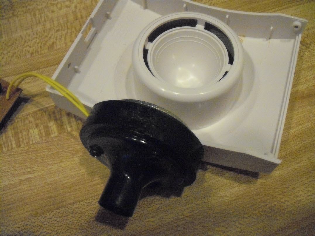

          In a sense, it's a two piece assembly -- but, I think it can be 3D printed as a single piece, even if the throat of the horn was not part of the driver assembly.
          Note the "step" on the driver (just outside the circle formed by the screws affixing the throat to the driver) forms an acoustically continuous surface with the "lip" in the cover, when they are mated.
          Presently, the driver is mounted to the back plate of the "siren assembly". Manufacturing tolerances ensure the (hinged) cover closes on the driver to form this "seal" (step to lip).
          My thought was to remove the cylindrical center portion of the cover (anything "outside" that cylinder is "outside" the acoustic path of the horn). Then, adhere it to the driver so I have a cylindrical assembly with the driver at rear and the horn mouth at the front.
          If I could adhere this to a flat plate (with a hole bored for the acoustic pressure wave's exit) then that plate could support the driver (a pair of mounting holes in that plate could fasten it to a typical 3" round Jbox)
