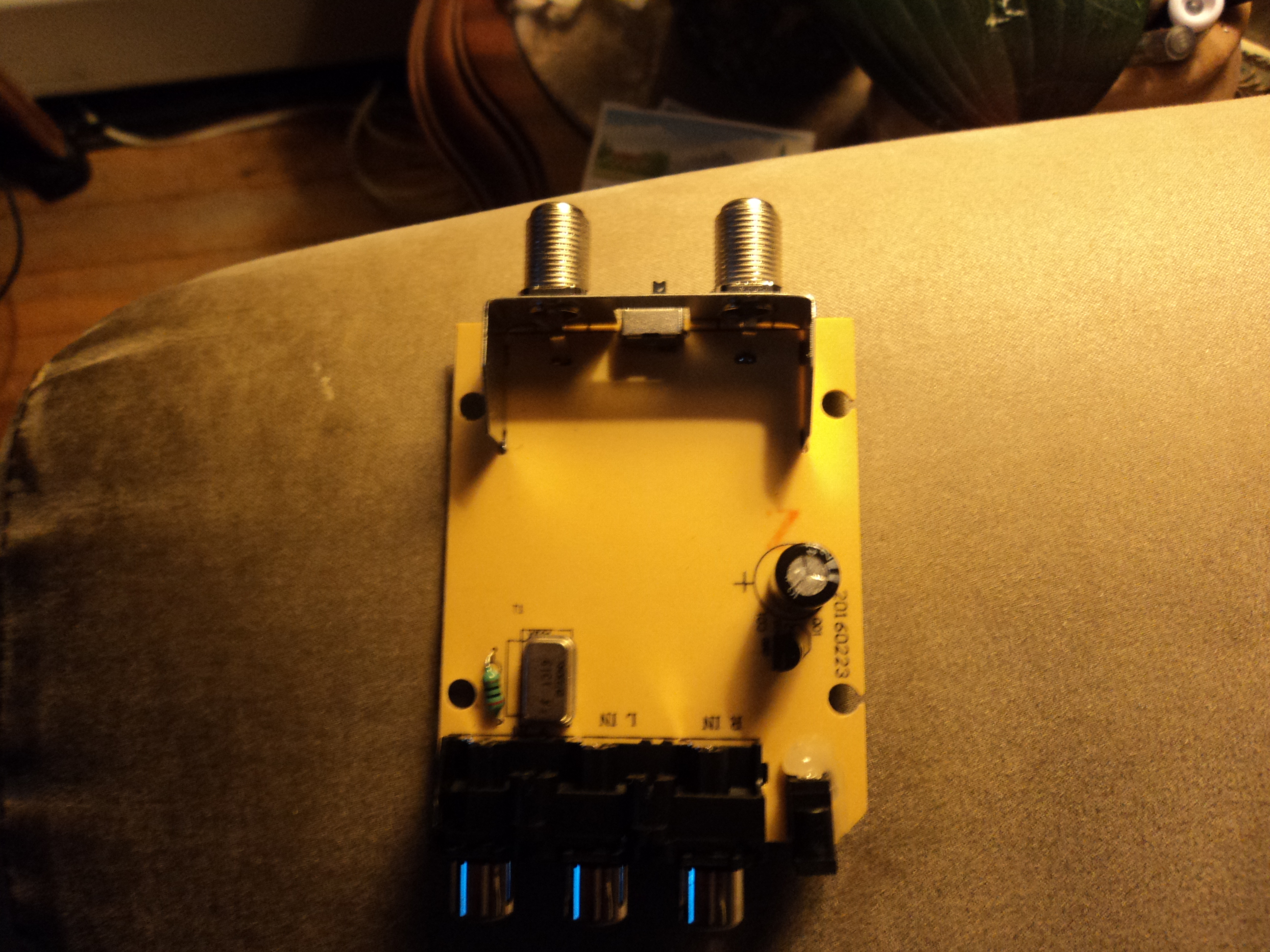

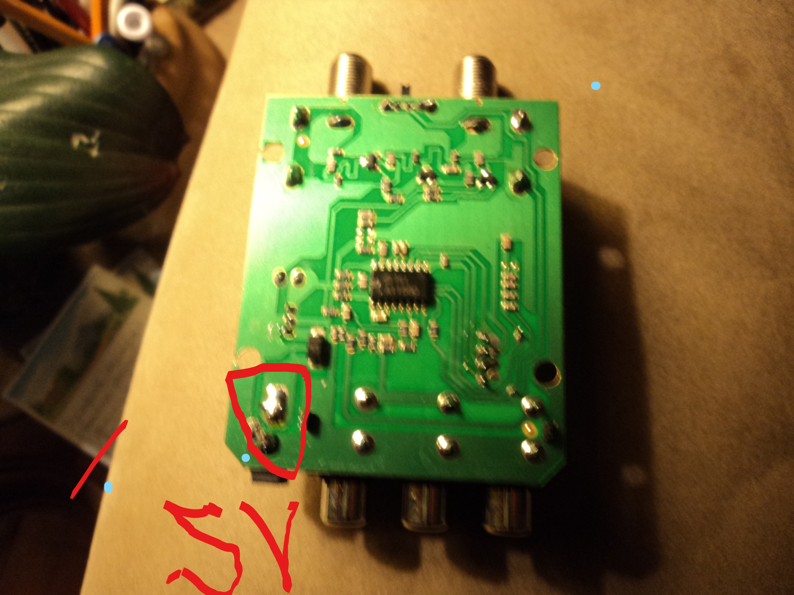

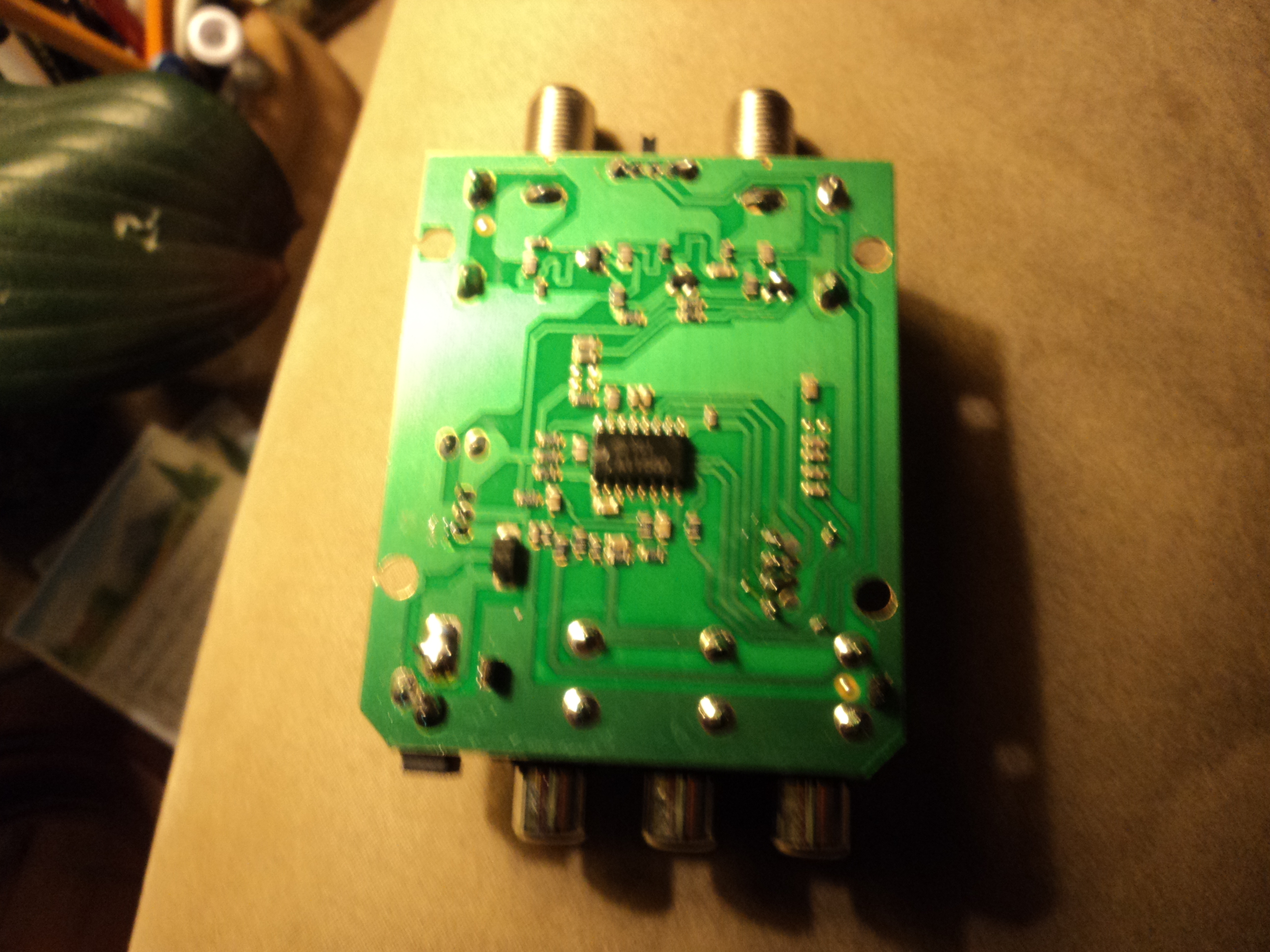

Hi guys i got this composite video to RF to send tv signal throughout the whole house with coaxial cable , but this RF converter has no led ,i'd like to add a led ,it has a 5vdc power supply input ,i have a few led in my scrap, can you guys help to add it to the circuit ,i send pics of the circuit,do i need to add a resistor to the led to make it work,thanks

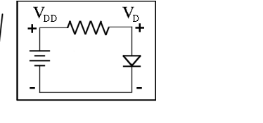

Just use 150 ~ 220 Ohms 1/4W in series with the LED and then connect it to the 5V supply line with proper polarity, that should be more than good enough.Never stop learning

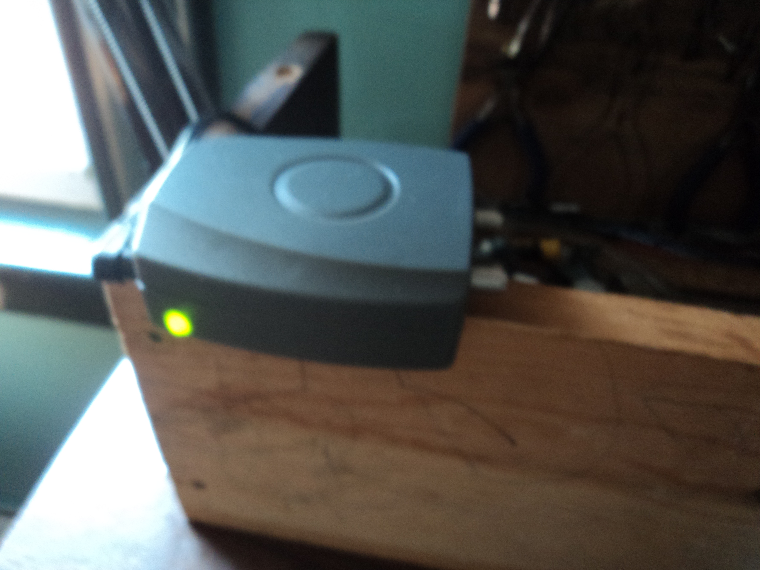

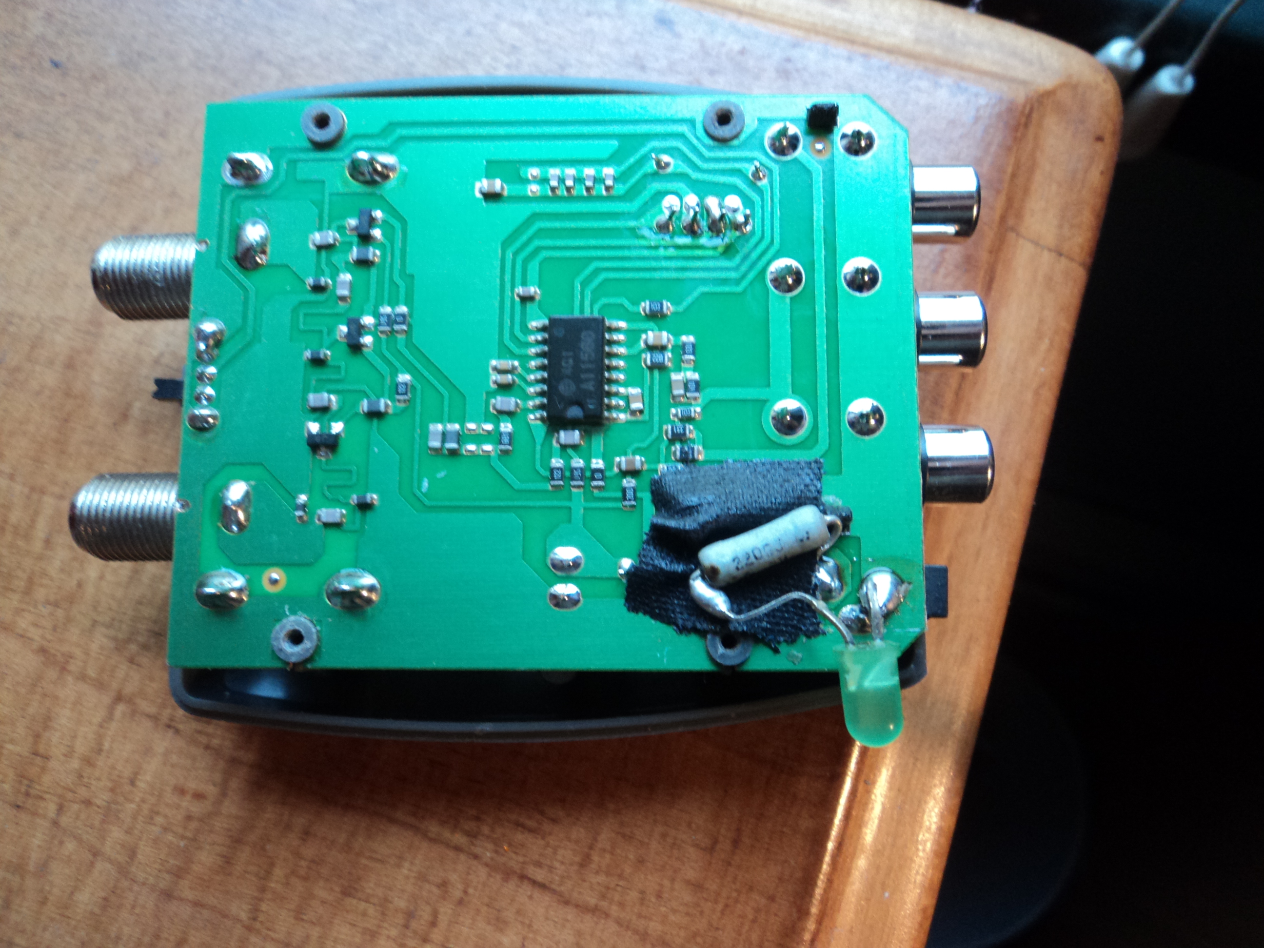

Thanks stj; not exactly what is in the scheme but i've used what was suggested by Budm, 220R and see work done in the pic.thanks guys.Attached Filesif you find these attachements useful please consider making a small donation to the site
