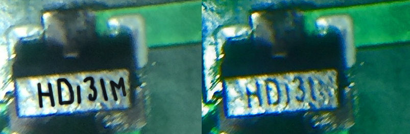

    Unknown Surface Mount Component
    I need to figure out what this is ... I've tried googling the identifier as I see it, but no love ... anyone know what this is?

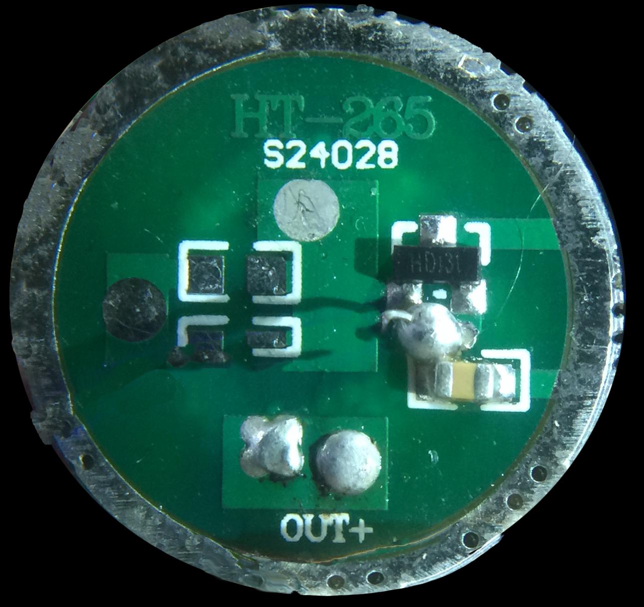

        Here is the whole circuit:
        sigpic
          • 31281
          Re: Unknown Surface Mount Component
          it's a chip - custom.
          did you remove some resistors?
          those chips only handle 1.4A, the board usually has some parallel resistors to limit the led current.
          if your trying to fix it, you can bypass it for 100% or off - no multi-mode.

            I have not removed anything from that circuit board ... thats all that was on there, those two components. I assume the little box is a resistor.
            What do you mean by "100% or off - no multi-mode"?

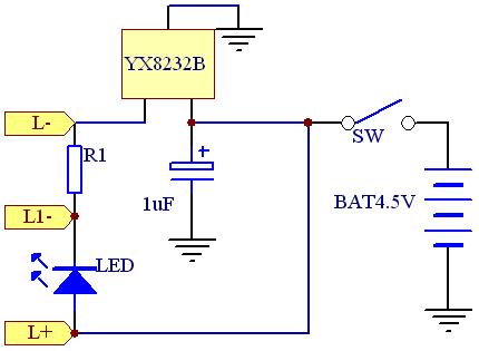

                It appears to be flashlight LED controller + MCU. Some IC's have linear constant-current control and others have buck converter to do that for higher efficiency.
                My guess is YX8133A by shiningic but hell to translate. Replaced by YX8231B or YX8232B. I can't find much for SMD marking codes.
                If you have an inductor stashed away somewhere, it is a buck-converter type.

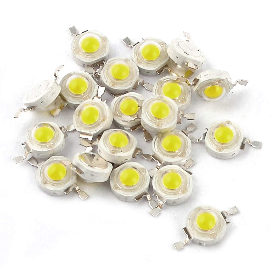

                            So the LED looks exactly like these ...
                            sigpic
                              • 31281
                              seriously?
                              that's rare.
                              well they could be anything - .5w, 1w, or 3w
