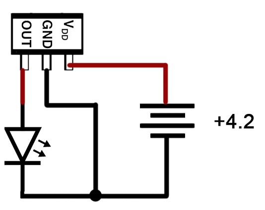

            • EasyGoing1
              Shock Therapist
              • Sep 2016
              • 977
              #46
              Re: Unknown Surface Mount Component
              They finally showed up today ... I have tried 6 of the 10 and NONE of them have worked ... kinda pisses me off.
              sigpic

                    • EasyGoing1
                      Shock Therapist
                      • Sep 2016
                      • 977
                      #50
                      Originally posted by stj
                      show your circuit.
                      Here it is

                        • 31218
                        #51
                        your led is backwards, the chip regulates the negative rail.

                          • EasyGoing1
                            Shock Therapist
                            • Sep 2016
                            • 977
                            #53
                            I JUST NOW took a closer look at the schematic on the datasheet and saw my error... they work just fine.
