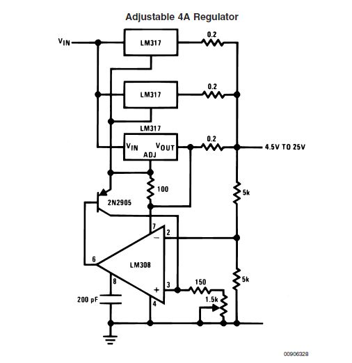

    I have this VHS RCA camcorder but of course the battery has long since died.
    I do have a sealed 12V 7Ah battery that was pulled from a security system and it would would work well as an alternate power supply after I fit it in a fanny pack however not only is it too high a voltage (the camera needs only 9.6 volts) but I don't know what pumping that many amps into it would do. I need a way to drop the voltage down and possibly the current as well so that I don't cook the camera as the fuse in it blew years ago and I replaced it with a piece of wire.
    I have already tried using a 9V converter for a car cigarette lighter but it's only 800ma and the best I could get was a blink from the camcorders power light so that's not enough.
    Can someone else give me a little assistance here?

              7Ah is Amp *hour*.
              Say that battery is drawn at 1amp, that's 7 hours, otherwise 7A gives a hour of charge. So on.
              You'll need a active voltage buck regulator that is rated around 1.5A to 2.0A since there is none that can hold up that much current at that power even with LM317. And more efficient due to less heat disspation.

                i'm pretty sure you can do 2.0A with a LM317 with adequate heat sinking. in the TO220 package it's rated for a max. dissipation of 20W which is enough.
                besides, there are lots of app notes for the LM317 that should be enough of an inspiration, see below for an example
                edit: the datasheet says the current limit is 2.2A (avg) when vin-vout<15V. a reduction from 12V (maybe a bit more) to 9.6V is just above the dropout voltage anyway, so i'm pretty confident this should work.

                  oh, and then there's the LM 1085 (adjustable) that does 3A.

                    Yes a voltage divider could be worked out.
                    Use some zener's in parallel with load and that branch of the divider to keep volts at 9.6v.
                    Probably need to use three 3.3v zeners in series to get to 9.6v.
                    I think kikkoman's idea would result in a longer operating cycle per charge-up of the battery.
