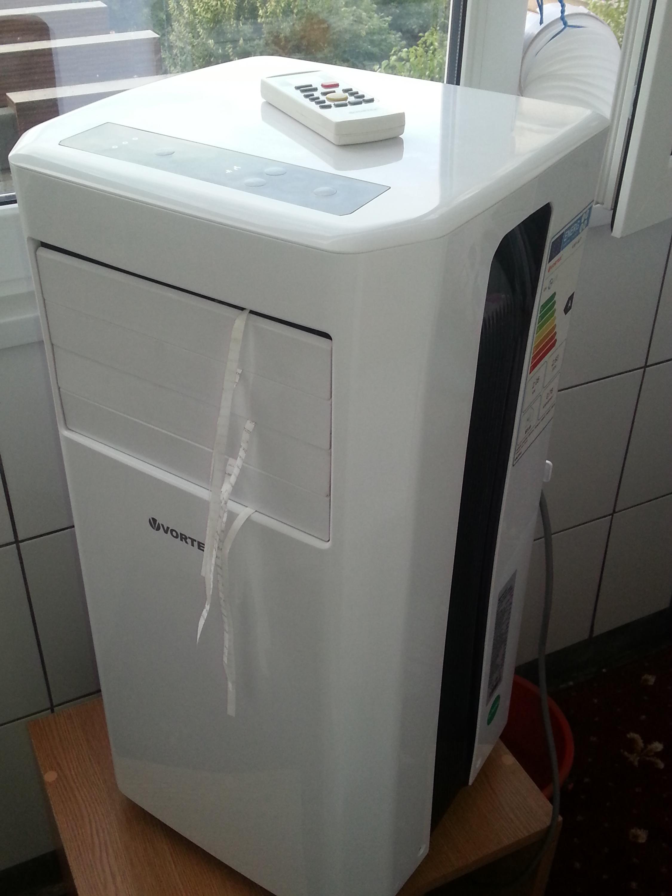

    Good day folks. Summer being in full swing, I thought I'd automate my home a bit and come up with a way of putting the air con on even before I arrive home. It does have a time delay feature that goes up to 2h, so you can set it to turn on/off after 2h, but that's the maximum range you get, so if I'm gone for more than 2h, it's a waste of energy if comes on and cools nothing, plus once it IS on, you have no way of telling it to turn off again so it just keeps on going.
    Of course there are probably many projects out there describing what I want, but trying to keep the component count and budget to a minimum, I'm not sure what I should use exactly. I have an Arduino Mega on hand, but from what I understand that's not enough. Not counting its obvious lack of any network features without a shield, I learned it's not fast enough to handle both the remote codes and the network environment at the same time. Most home automation projects seem to revolve around the Raspberry pi of some sort and I was thinking of getting one of those and giving it a crack, despite not having worked with one ever before.
    I DID see them in action and had a brief look into it when my workmate automated the lights in his house and even designed some sort of remote desktop client/server thingy with one (to this day I'm not sure what all that mess was trying to achieve that a PC couldn't, but anyway). He tried "luring" me into all this home-automation business, but I didn't really play along since I regard it as a waste of time and especially money, especially for small apartments (why would you need to turn a light on if you're not at home?), but the A/C is one thing you WOULD want to control remotely and I'd like such feature, so perhaps it will be a good learning experience after all. What do you guys think ? Any thoughts or good resources on this ? What should I look into ? Hell, maybe someone's already done this and can provide some direct feedback. Cheers and thanks.
    Wattevah...

              Re: Controlling A/C remotely (what to use?)
              Originally posted by eccerr0r
              well, I think the OP is using a window unit of sorts and not a central HVAC system
              Partly correct: mobile air con unit, the type you wheel around. It's a Vortex in case it matters. I added some pics of both the entire thing plus the remote, in case someone goes "oh, I know this remote, it's the same thing as X", since I'm sure it's generic and used by many different brands....smiley face on there too

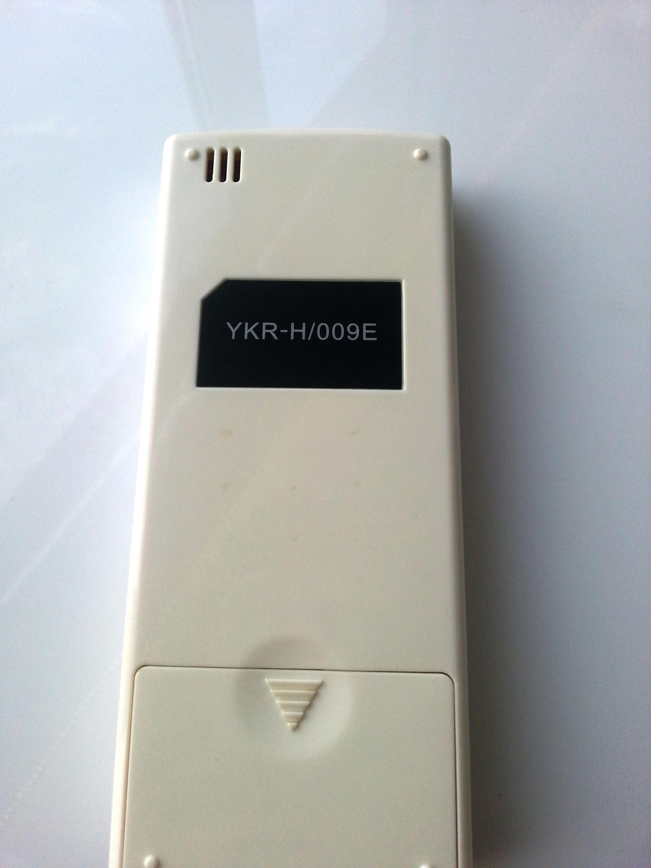

              Pretty tough getting in there, plus not all functions on the remote have correspondents on the unit itself. IR is the way to go in this case.
              I looked into it some more and apparently A/C remotes send all of the parameters shown on the remote screen at the same time: temperature, fan speed, swing on/off, so I'd have to capture all the different possible combinations, starting from the lowest temperature and working my way up to the highest, so 16c, low, swing on / 16c, med, swing on / 16c, high, swing on, etc. I was then thinking of a user interface where you have like a drop-down menu for the temperatures and radio buttons to select parameters like fan speed and swing (these 3 are the only ones I require really) and then a "send" button to send that combination via the raspberry or whatever micro I'll be using.....sure, sounds easy, but for someone who's never designed something like this in practice, it's a challenge.
              Temperature ranges from 16c to 32c, so 16 combinations right there
              Speed ranges from low to med to high, so 3 more there
              Swing is on/off, so an extra 2....add every single possible combination of these up and we get, by my calculations, so correct me if I'm wrong, 102 possible combinations...I compiled a chart of how it should look...I'm sure you get the idea.

                Yeah, people tend to just record the remote and playback to remote control it. (the RF ones are another story!) Seems that the remote has some peculiarities in it, most remotes are dumb and just send codes as they're pressed but this one seems to have some sort of local state... Looks like a bit more complicated rev engineering job there!
                  One thing I noted is that if the remote is already "on" (but the unit is off, if I press the power button while in another room or blocking the LED), if I THEN adjust any parameter whilst now pointing it at the unit, it will come on with those parameters despite not having actually pressed the "ON" button.
                  For example, if the remote shows 16, low, swing on and I press the "up" button to go up one step to 17C, the A/C will turn on at 17c, low fan speed, swing on, as the "on" command is carried as well, so all those values would also have the "power on" command associated with them in my chart, since OFF would be a separate one entirely with no other value. Just thought I point this out as an extra detail...the only way to find out is to actually go for it and see if it works...I'll probably borrow my mate's pi to try it...

                                Nope - all of that is too complicated. The A/C is not permanently installed as you can see and it's not a HVAC system employing a thermostat, so the only method here is the remote. I found a project (can't remember if I linked to it here) using an ESP that does just this...the only problem is adapting it to fit my unit. That one was for a Daikin I reckon...
