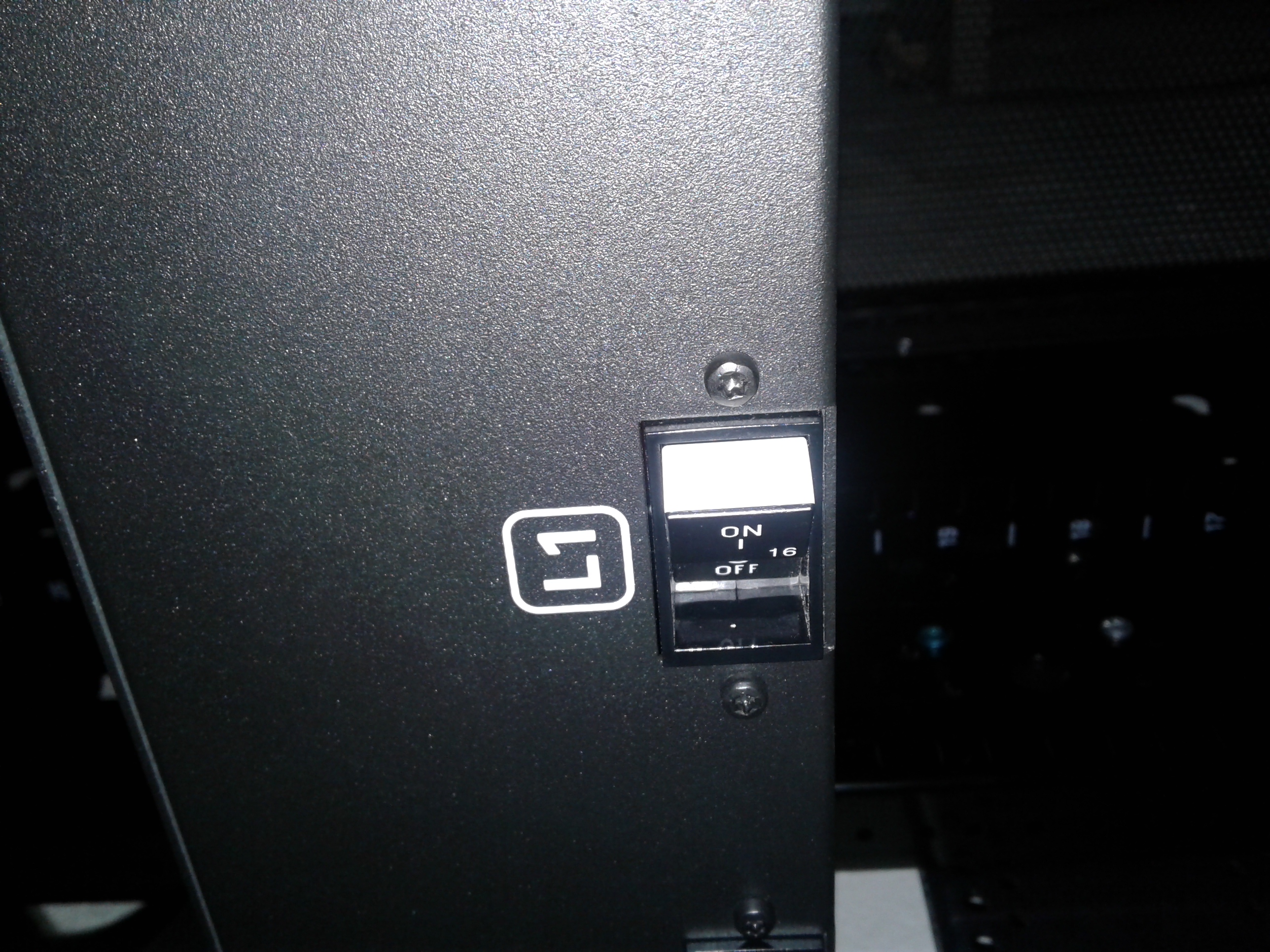

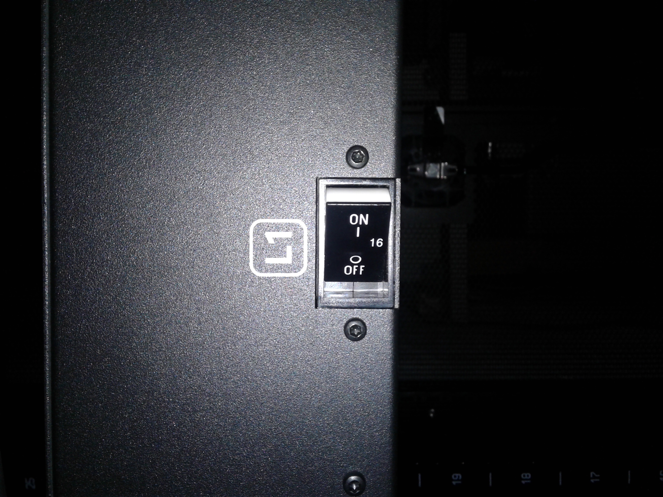

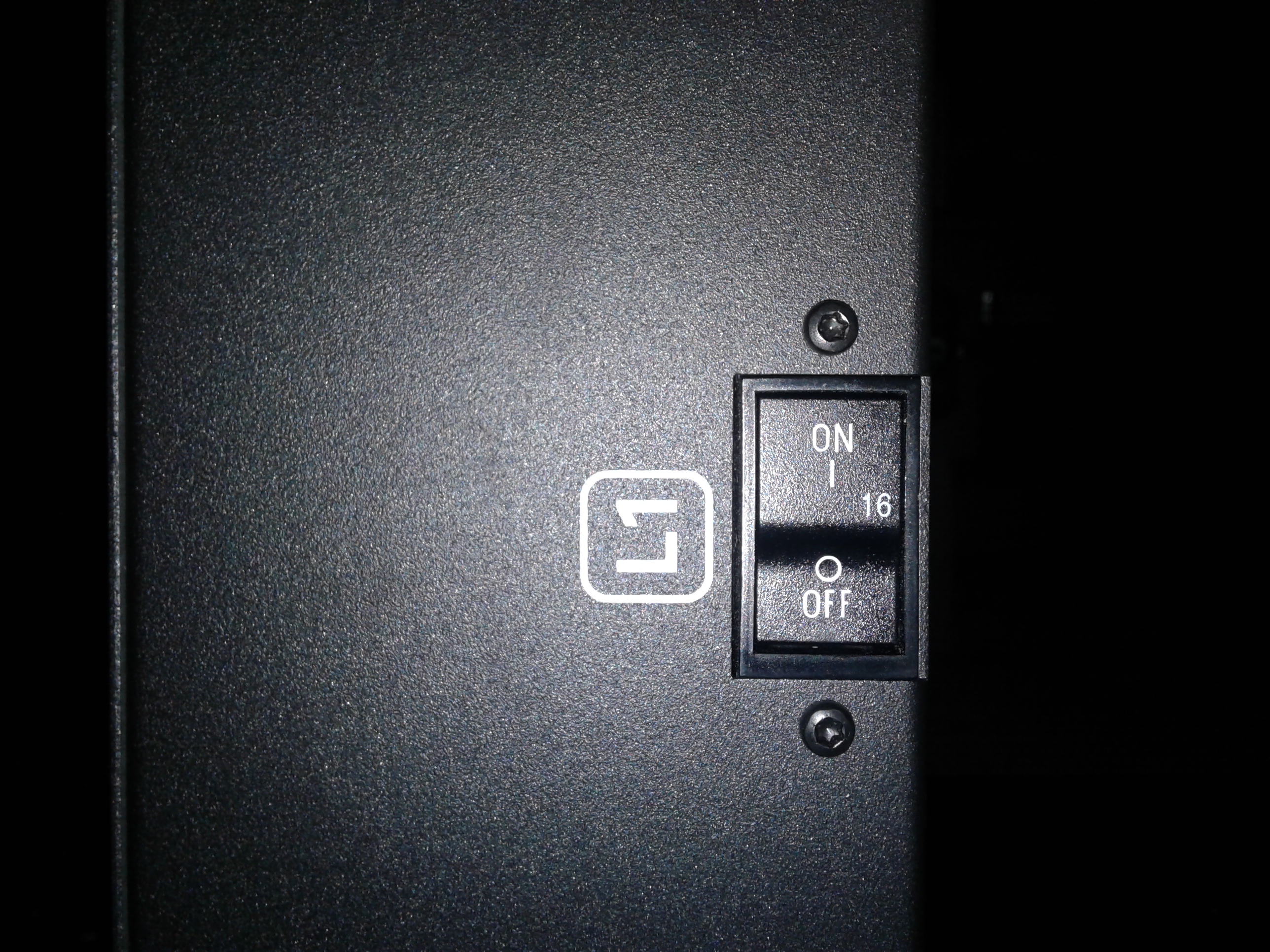

                Can I see good clear pictures of your PDU? I like to see what the two 16A breakers look like from outside.

                  #88
                  Re: Need help wiring up 240VAC.
                  Yes sir. I will show you them tripped and not tripped. It's a type of rocker switch, but is flush (doesn't look like a rocker) until you trip it. I will go take the pictures now for you.

                    #89
                    These three pictures of are the L1 top row (for the back of the PDU, there's two rows, a top row called L1, a bottom row called L2). There's two breakers, one called L1, one called L2. This is just one of the two breakers.
                    Keep in mind, the value shown is derated, so the American two-pole version should show 20-amp, not 16-amp.

                        #91
                        "Keep in mind, the value shown is derated, so the American two-pole version should show 20-amp, not 16-amp." That is correct for those IEC outlets, the large (IEC-320-C19) one is rated 20A US, 16A Euro, the smaller (IEC-320-C13) 15a us RATED, 10A Euro rated.
                        Hmm, I cannot tell if they are magnetic or thermal breakers type.
                        The breaker itself rating is real 16A. I spec in 16A for the products with IEC-320-C19.
                        I use Carling in most the products since they can custom made for us in our application.
                        Your looks SIMILAR to Carling B series or J Rocker actuator:
                        http://www.carlingtech.com/hm-cb-b-series
                        http://www.carlingtech.com/hm-cb-j-series
