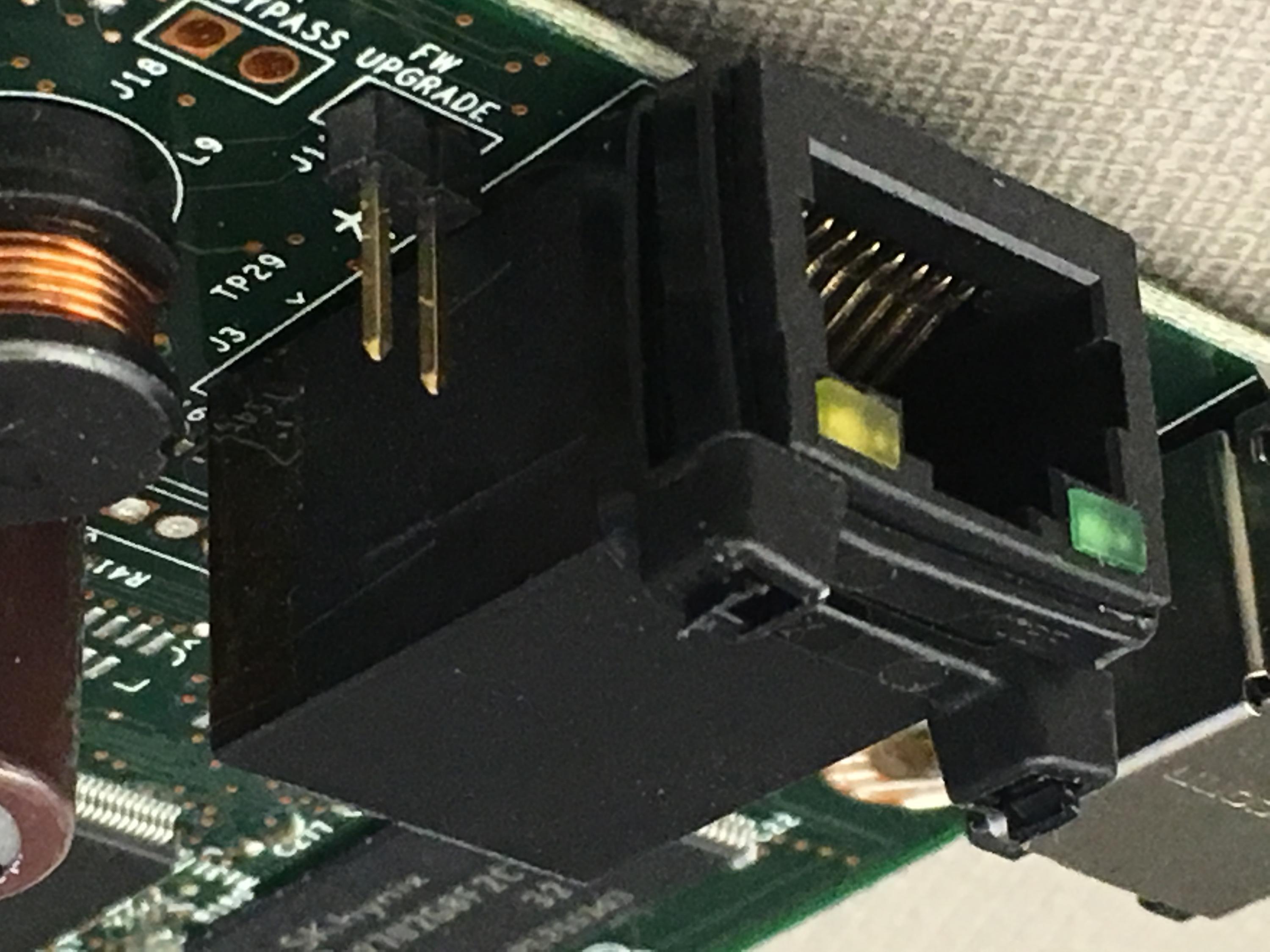

    hi folks..need to replace this connector.
    its not labeled, but other parts on the board are foxcon.
    just standard rj45 with lights. i can measure dimensions if necessary.
    please disregard the zip ties..its a temporary fix.
    thanks in advance.

    There's no standard for ethernet jacks.
    LED polarity, integrated magnetics, tab up, tab down, extra EMI filter, POE etc.
    They have widely varying pinouts, pin placement, size.
    I would look for a logo, there's some letters on the plastic I can see.
    Measurements of the backside of the PC board would help you but pinout can be tricky. Or fix the shell with epoxy cement.
    WIZnet bel/stewart/trp connectors china I would look at their catalogue 2250273 popular.
    Metal shell parts are the norm.

      It will be the pin layout (viewable from the bottom) that will help find a replacement. Then check your usual vendors depending which country you're in.

        when you remove it you may find a name or part number
