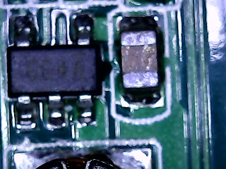

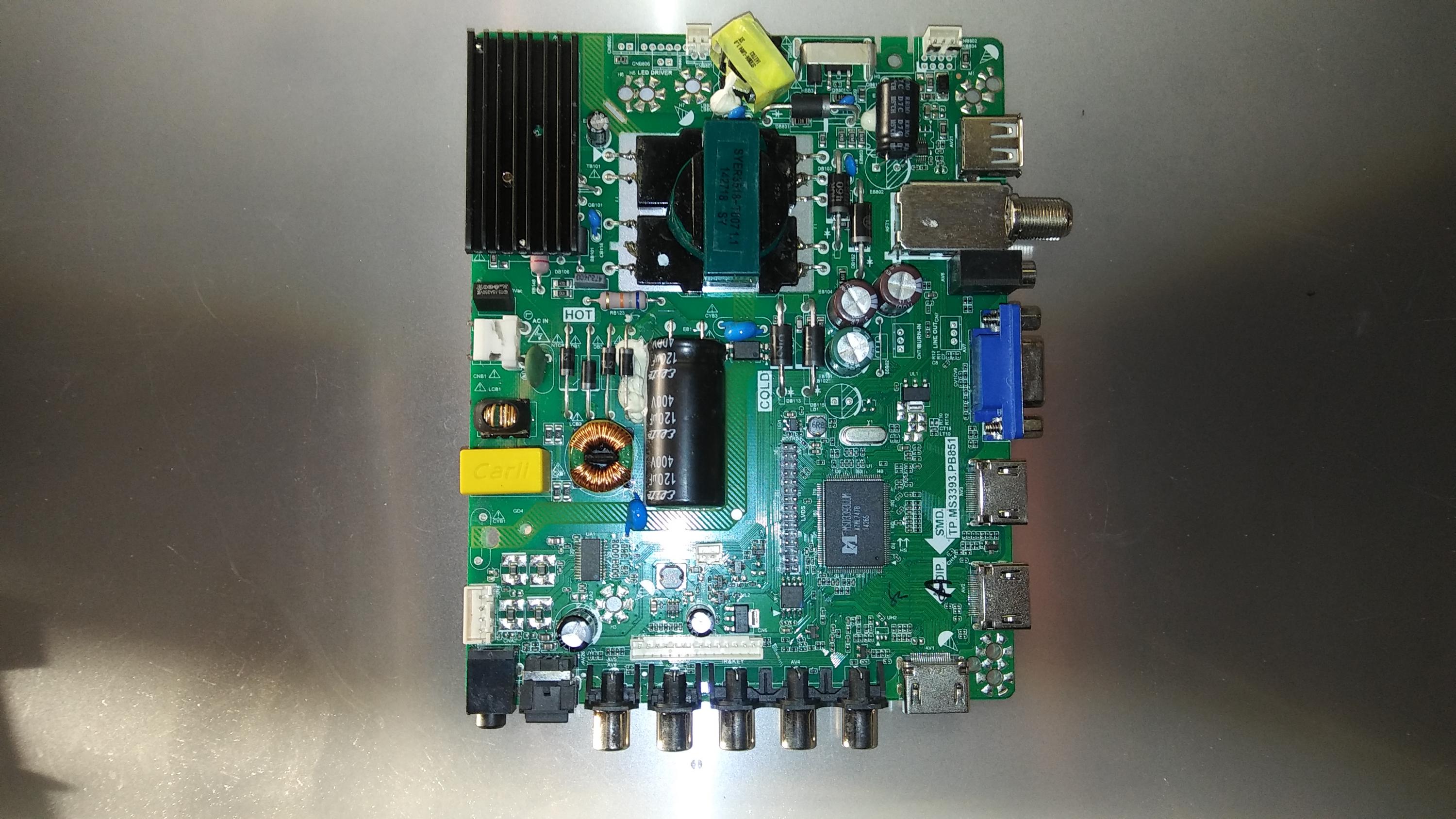

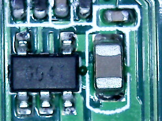

    What's this 5 pins part?
    What's this part? 5 pins IC in SOT 23-5 packing?....................

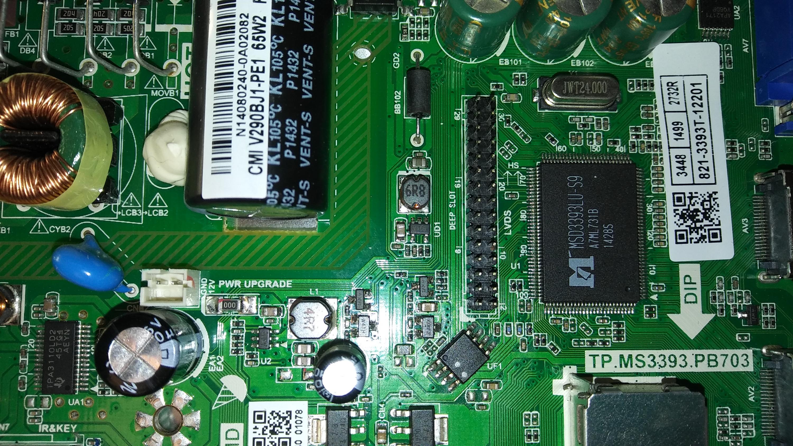

    PS: I took pics from two different PCBs, one is mark GG4T (pic1) another one is GG4A- (pic2,3,4).

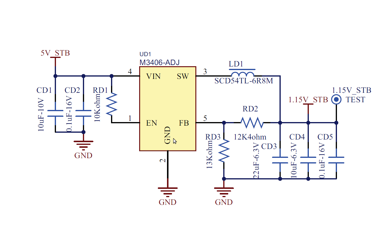

    Seems to be some coil (inductor) in lower part of photo.
    It may be something like:
    BL8024CB5TR
    LC3406CB5TR
    http://www.s-manuals.com/smd/gg

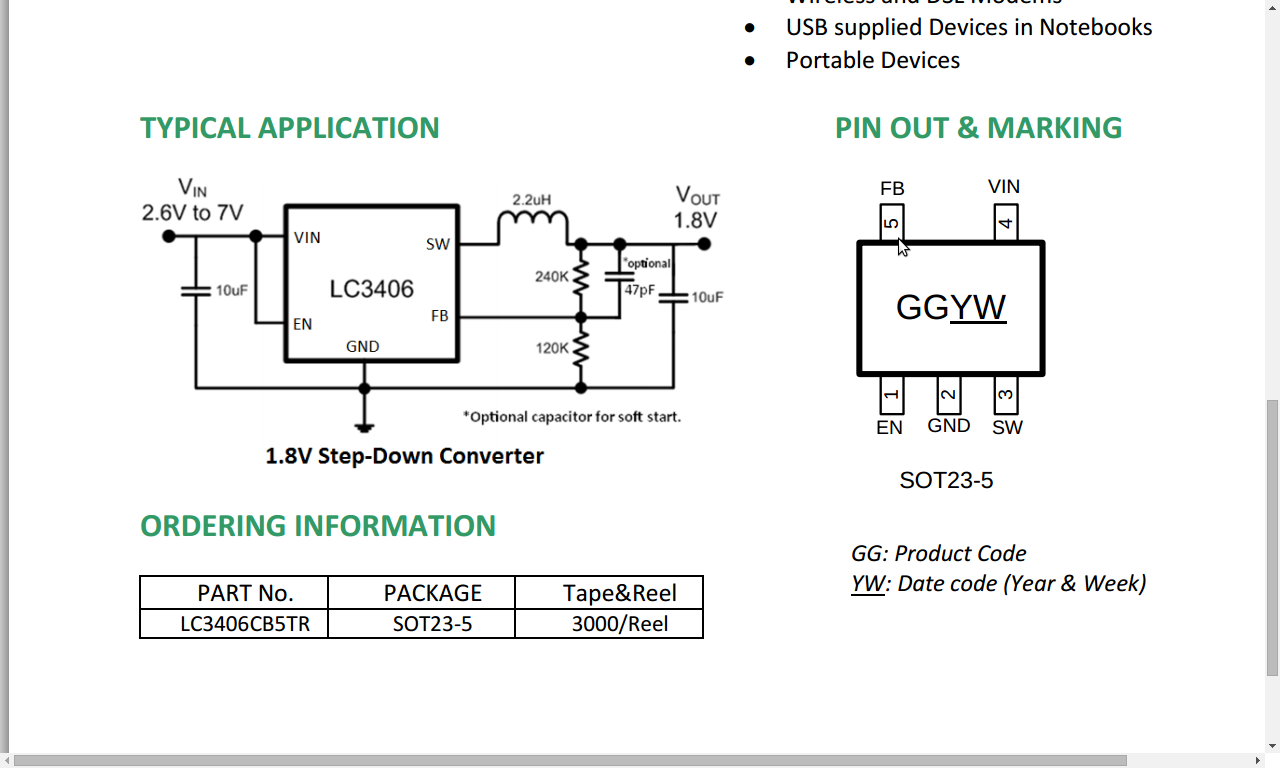

      gabiz ro............ You are Awesome!.......You're A Codebreaker!

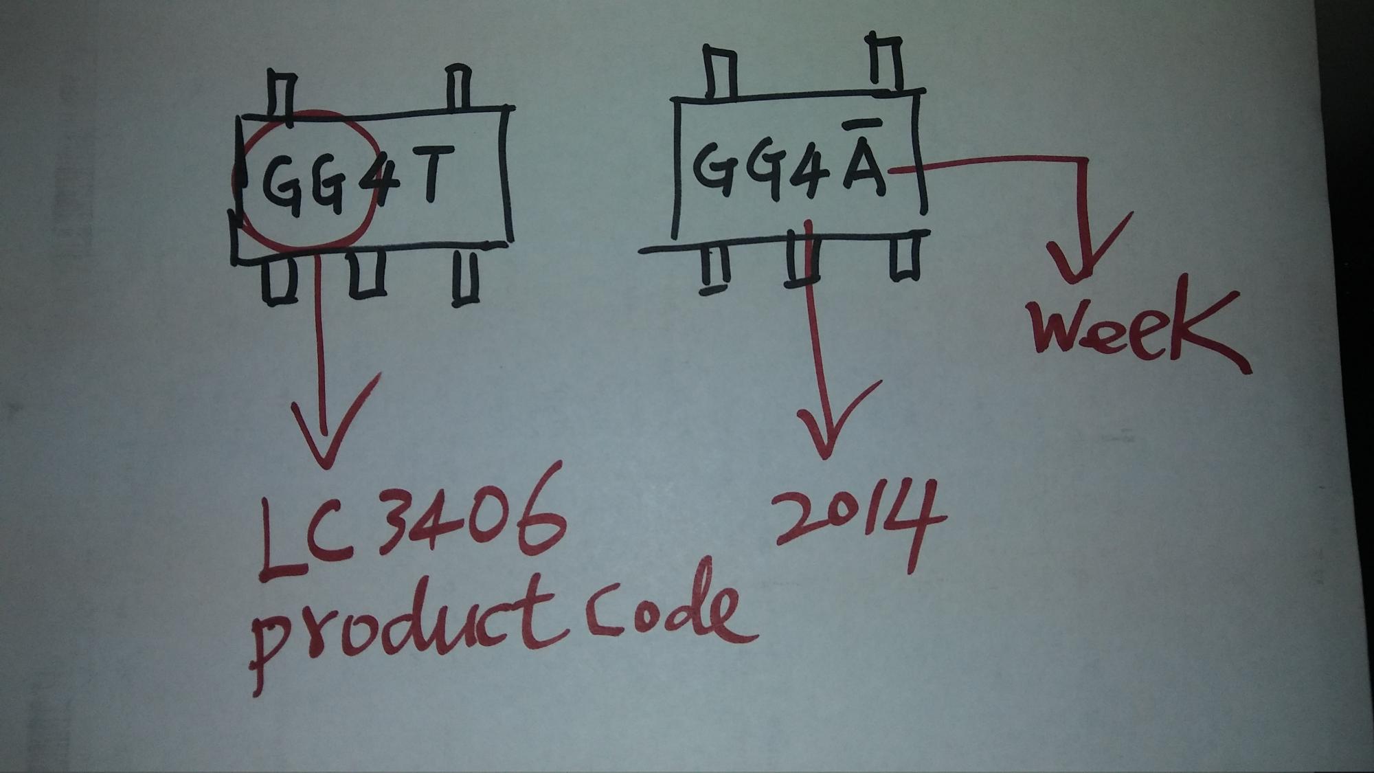

      LC3406CB5TR is made by Leadchip; The LC3406 is a high-efficiency, DC-to-DC step- down switching regulators, capable of delivering up to 1.2A of output current.

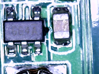

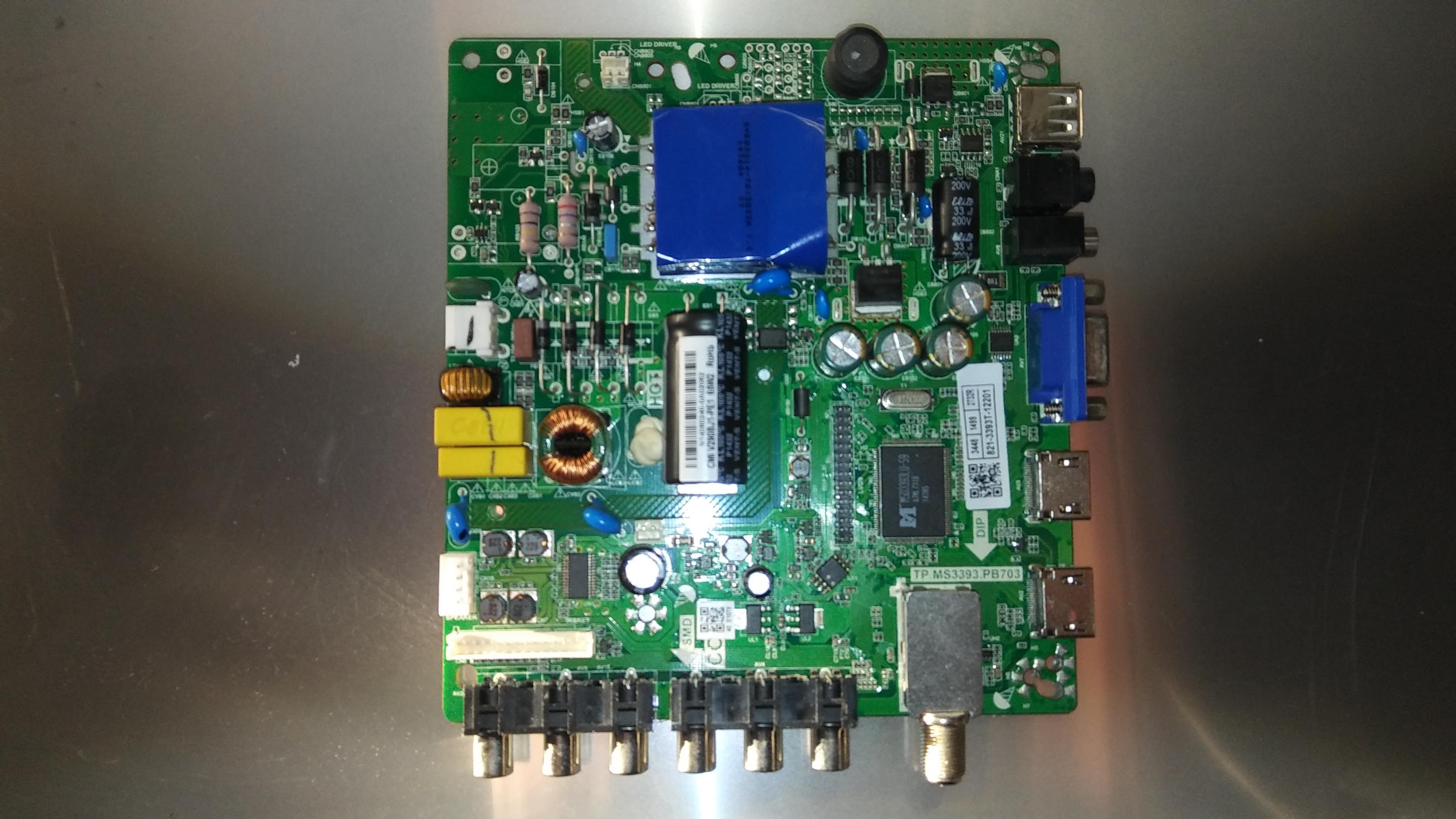

      pic5 : They are the LC3406 made in same year but different weeks.................
      One question: Can anyone code-breaks the week format? (T means which week of the year? At pic3 we know they made in 2013 but V means which week?)

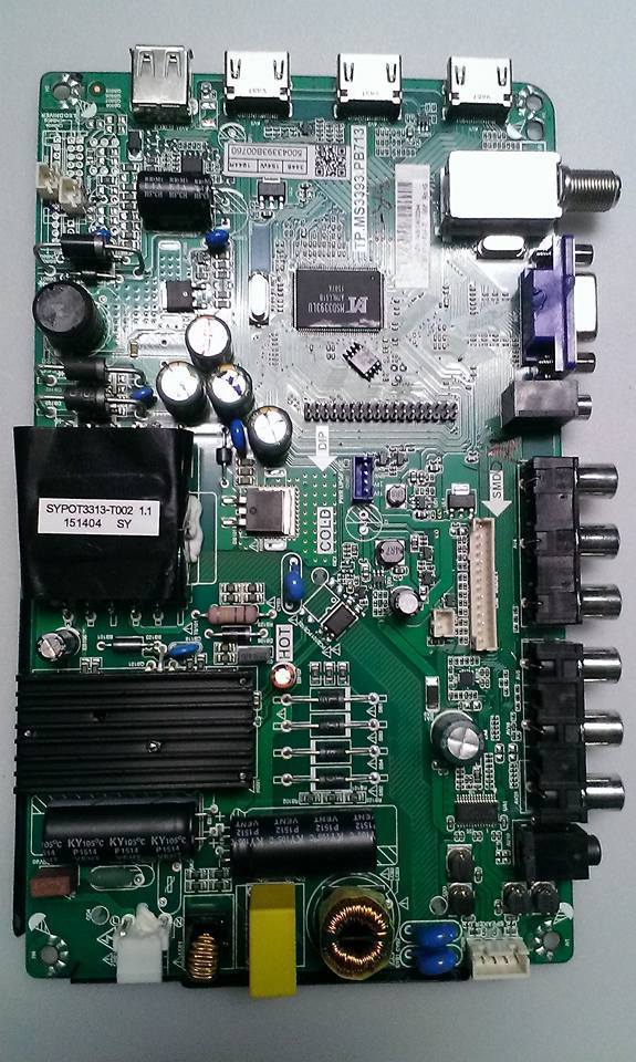

        pic1,2 : INSIGNIA NS-29D310NA15 TP.MS3393.PB703 UD1 is this LC3406 IC.
        pic3,4 : Hisense 32H3E 32J1427 UD1 is near LVDS socket.
        pic5 : Haier 32d3005f chassis UD1 M3406-ADJ = LC3406CB5TR for voltage convertor 5V to 1.15V STB

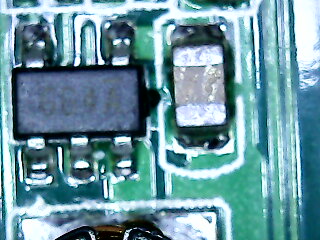

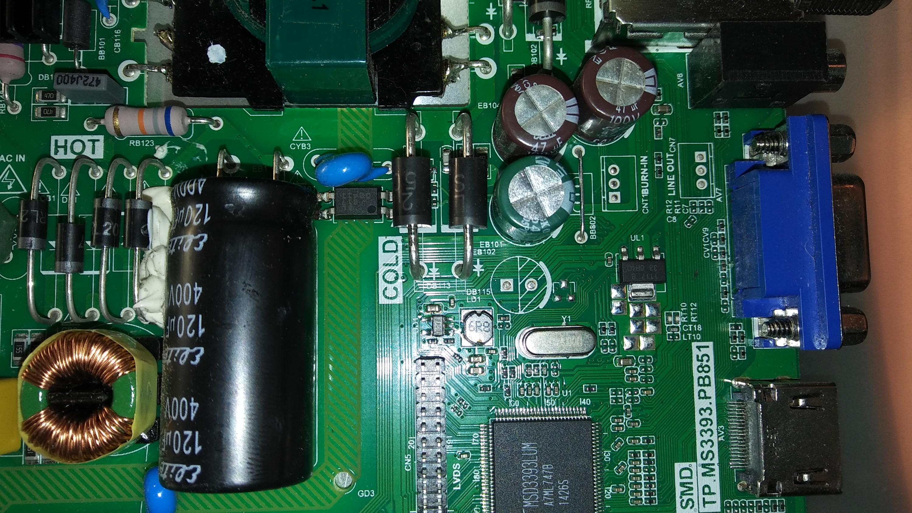

        pic6 : Haier 32d3005f L14060208 TP.MS3393.PB713 UD1 is below the LVDS socket.
