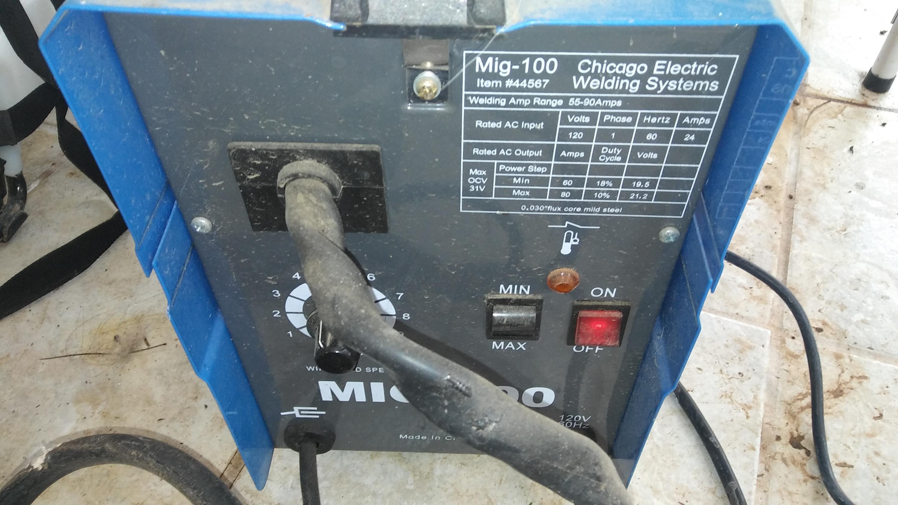

    I have A Harbor Freight Mig-100, same as Harbor Freight Welder 90 amp welder item # 44567, I try to modify it. My question is why DC is better than AC?

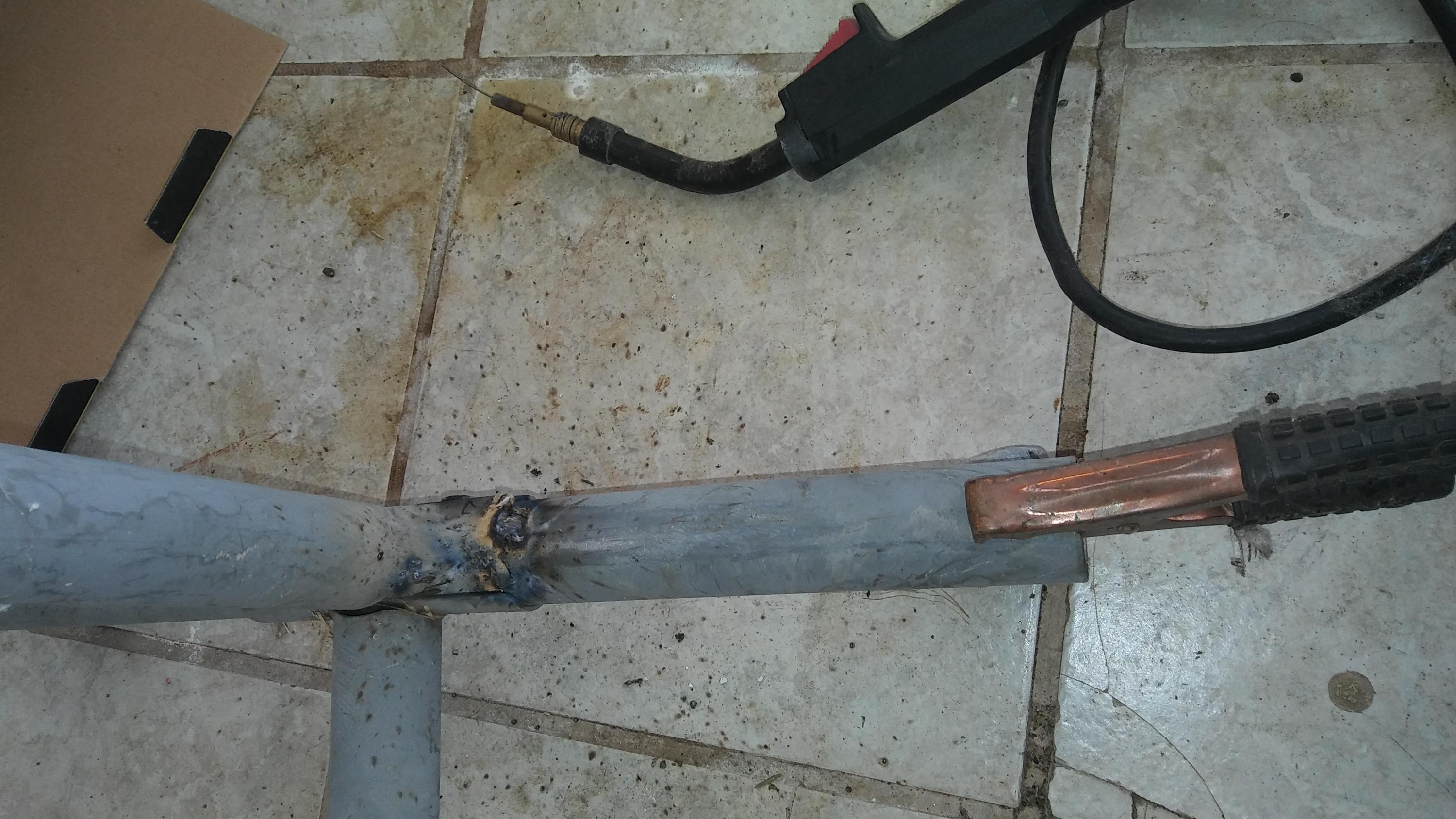

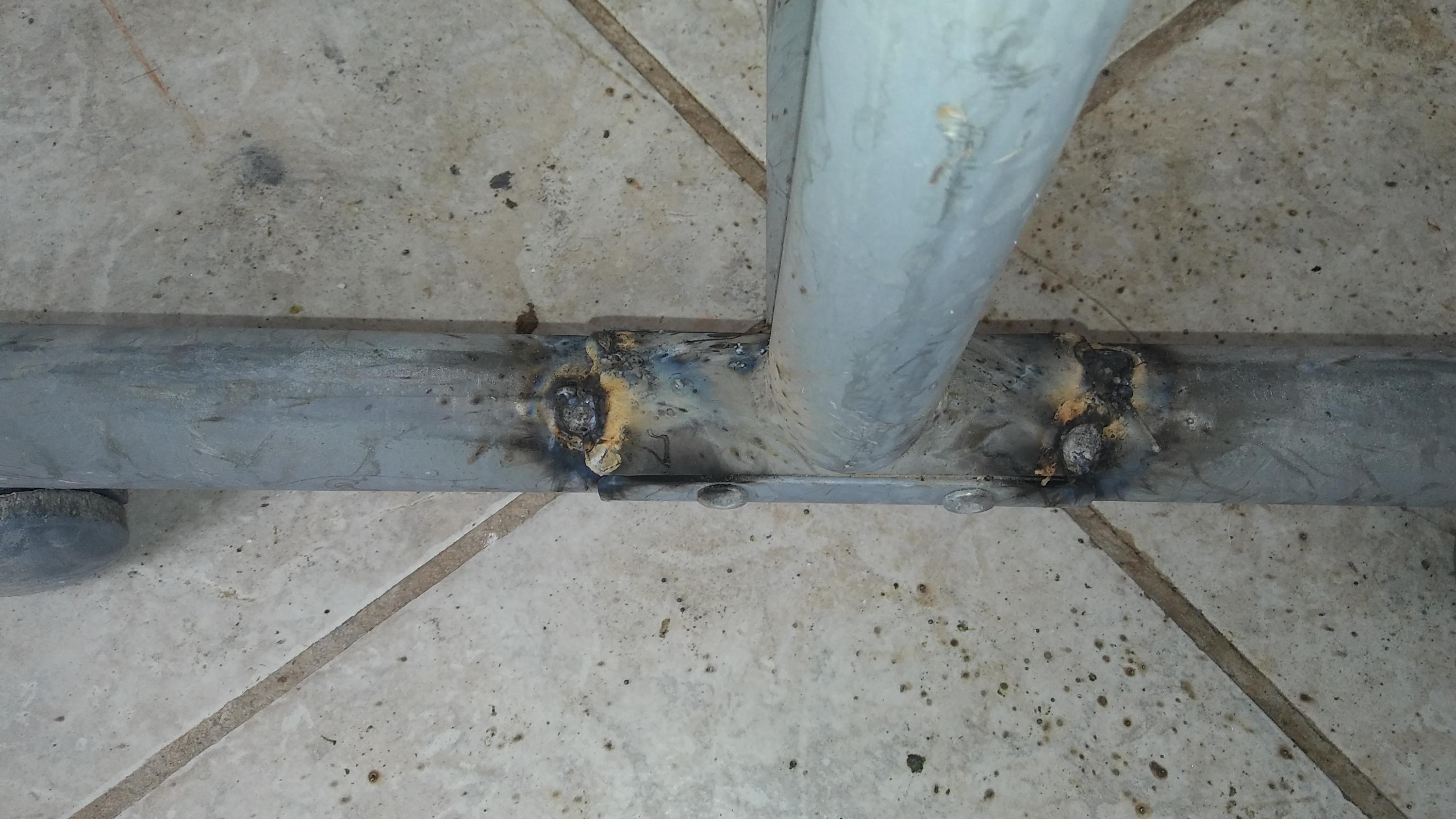

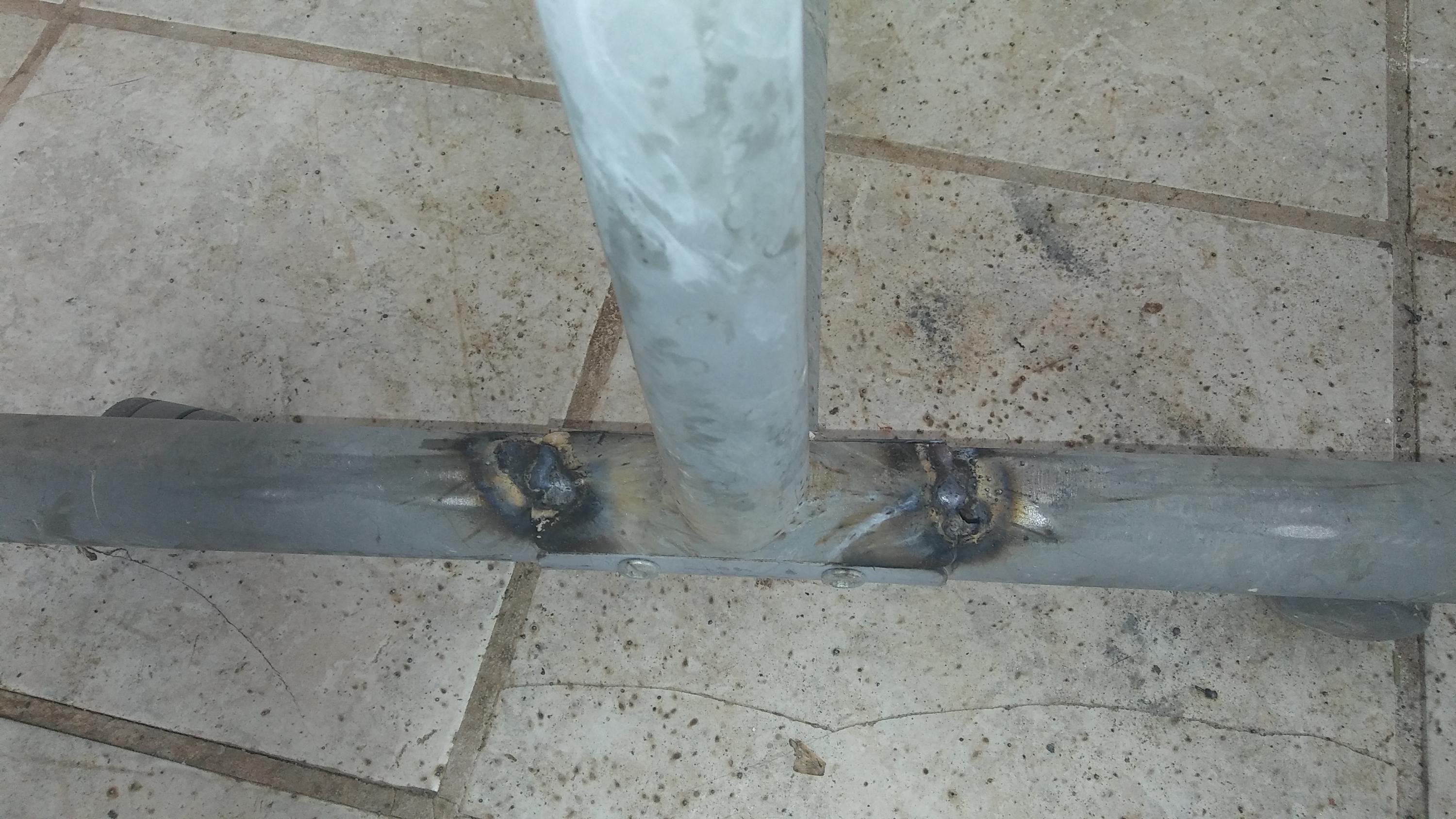

    Update: Last night I ground the weld down and had to grind a ways into the original metal to get the weld to finally break. I did a T weld next, all the way around the base where the one bar set on the bottom bar. I set it on its side and pounded on the weld with a 4 Lbs. hammer. The bar bent! The weld held strong.
    Update: I've been watching a lot of YouTube video's on how to weld with a flux core and MIG welder. That certainly helped because the weld on the T looked so much better, almost dime stacking look, and the weld is apparently strong. On about half of the You Tube video's the welder was adamant about cleaning the metal before welding and cleaning the slag after welding before doing a second pass if needed. The other half of the video's the welder would weld, stop, start welding again without cleaning the slag off. I learned really quick that it's MUCH better to clean the metal before welding, after welding, and certainly in between welds. The welds look so much better and appear to be stronger. I will have to curb the urge to just keep welding and instead, take my time, clean the metal and slag, and then continue welding.
    Update: As mentioned below in a conversation with another Youtube viewer, I welded a very long bead and the 100 amp bridge rectifier couldn't handle it, and burn up. At first I thought that my HF 90 welder had died, but no, it's just fine. A new 200 amp bridge rectifier was installed, big ... heat sink and fan. Shouldn't have problems with overheating anymore. This isn't the issue with the bridge itself. As Matt mentioned in his video's he's had no problems with the 100 amp bridge, but he welds in short bursts, allowing the 100 amp bridge to cool. That's a problem with wire feed welders, once you get going and the bead is looking good you have a tendency to just keep going - bad for the bridge! The 200 amp bridge should resolve that issue, along with me taking more breaks and just simply slowing down.
