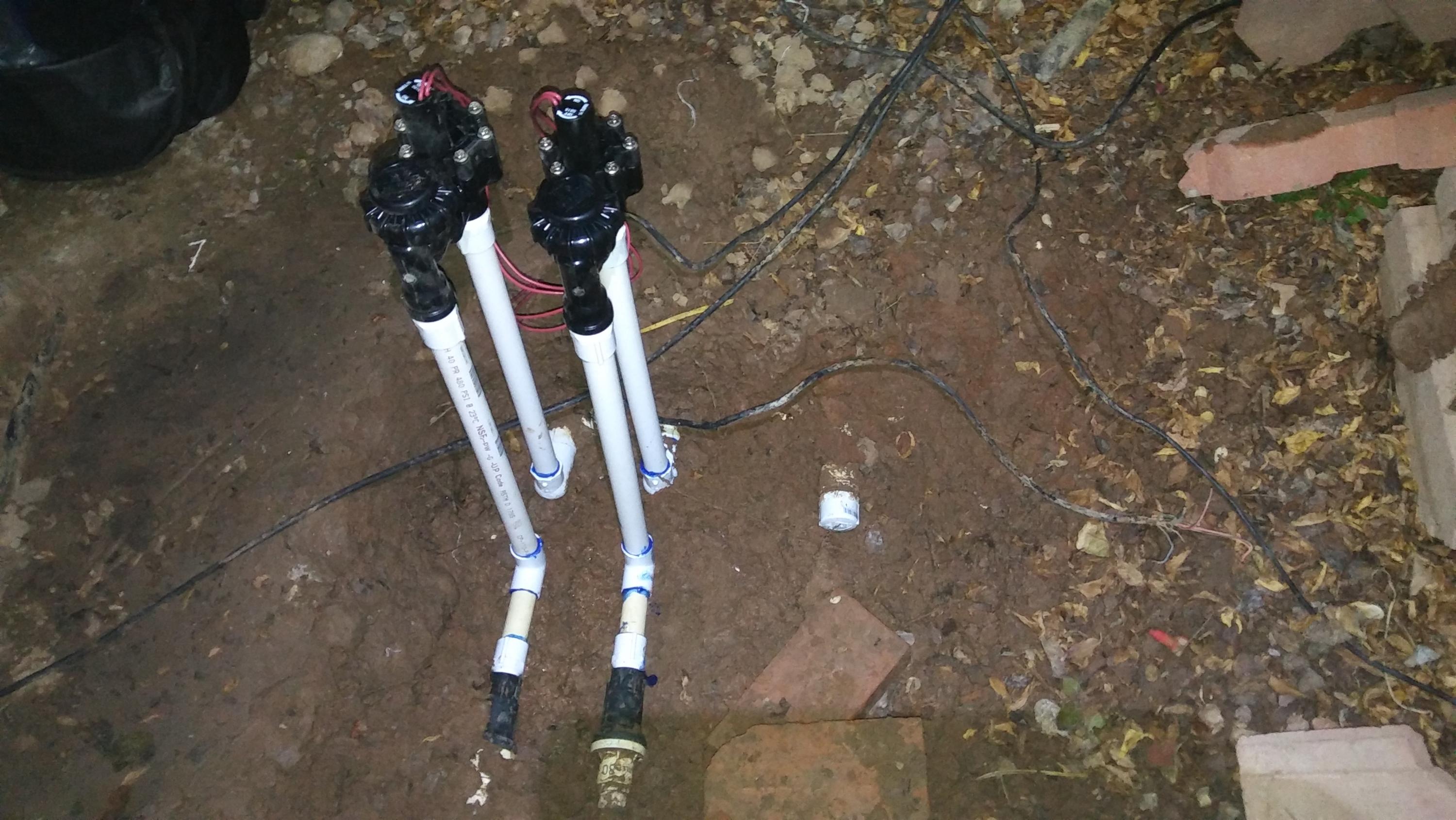

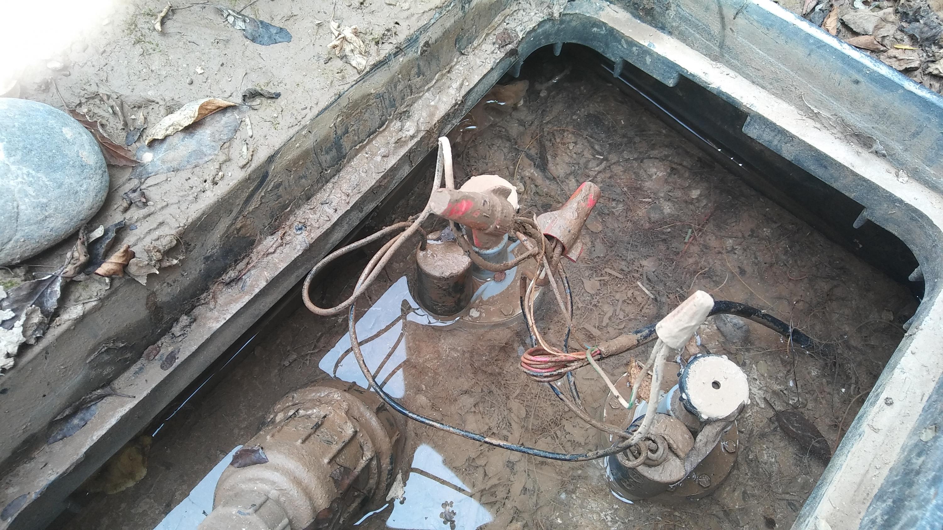

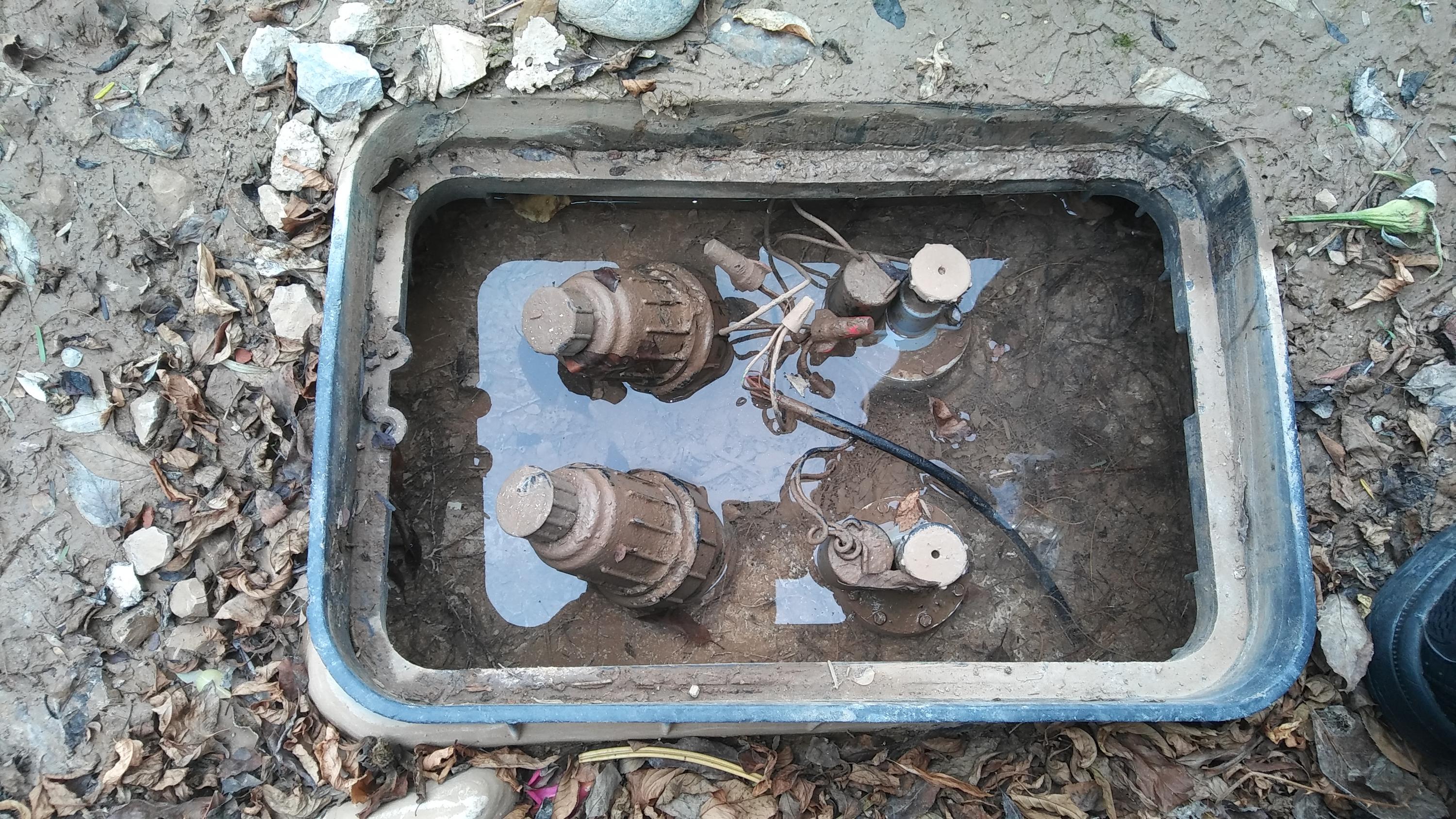

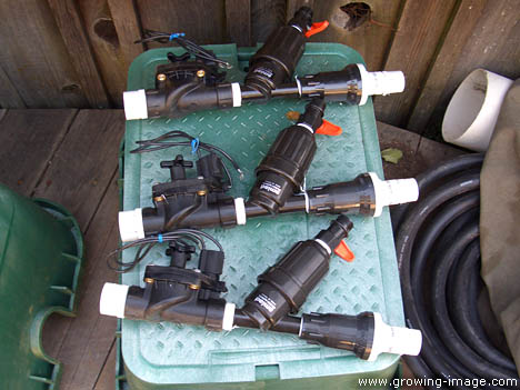

    My sprinkler valves are in the water, The pipe has A leak.
    I gonna change to this (Last thumbnail)

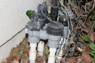

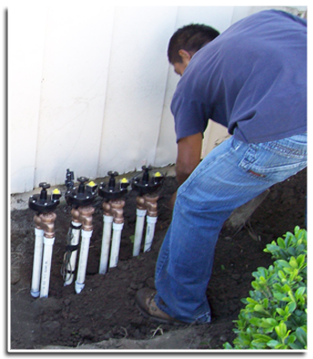

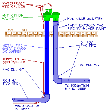

    The anti-siphon valve MUST be installed higher than any of the sprinkler heads or emitters it turns on and off.
    Pic2 is mine.
