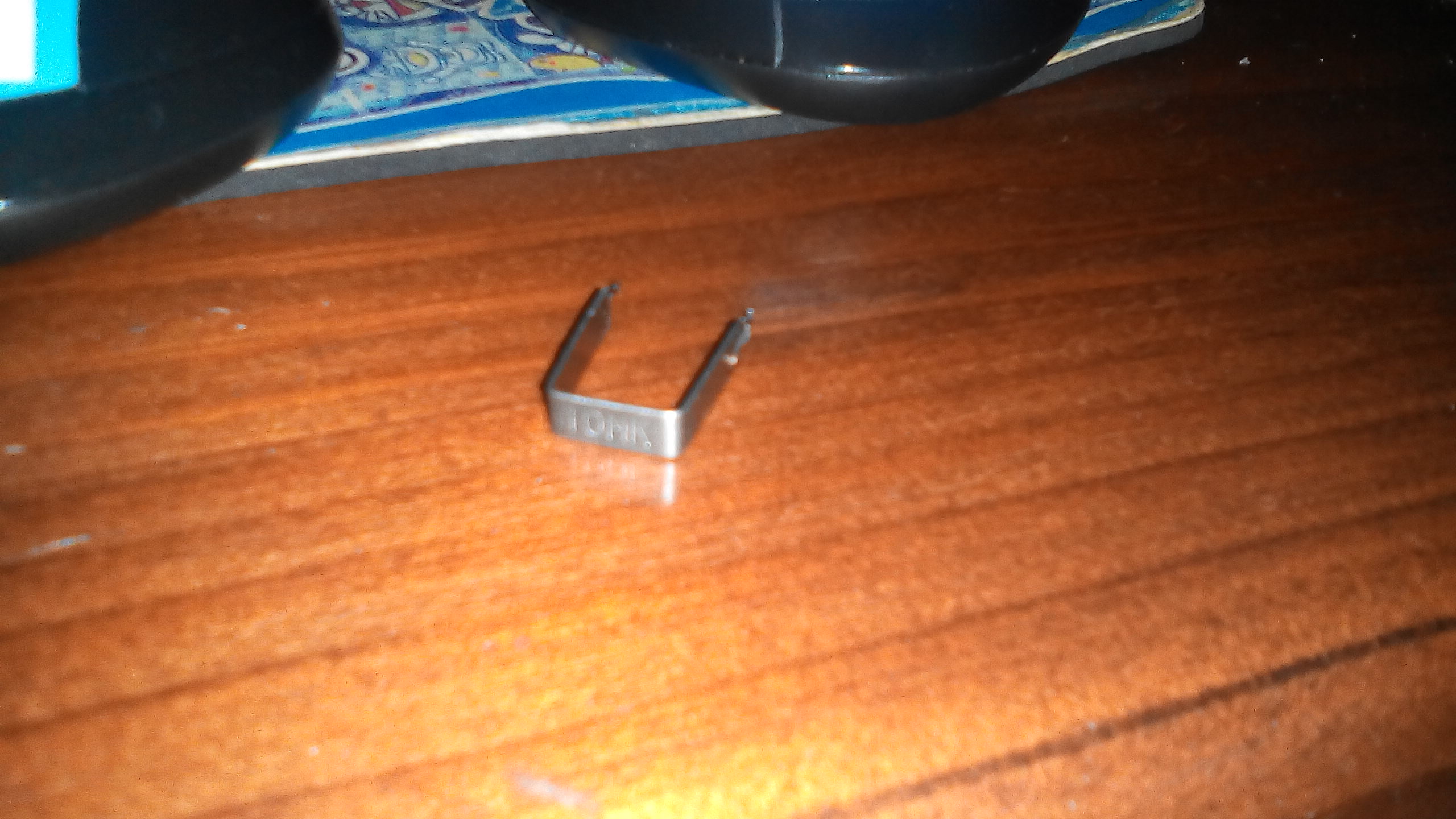

    What's the value of this link resistor ?
    Everyone,
    I tried to meter it about 1 ohm,
    but could it be 10 mOhm ?

    Re: What's the value of this link resistor ?
    0,010 akım drenci
      Originally posted by yildirim05
      0,010 akım drenci
      10 mili Ohm ? 0.01 ohm ?
        Yes, 10mOhm - seems right. If you need to be sure, you need to make a 4-wire measurement. Can be done in simple way, just use a bench power supply at e.g 12V, a power resistor 10-100 Ohms, and the use a good DMM to measure the voltage drop over the link ( NOT placing the pins on the same physical spots )
        See http://www.allaboutcircuits.com/text...e-measurement/
